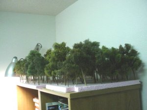

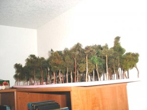

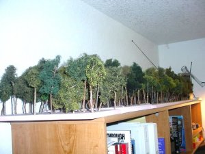

Here are some photos of all my trees, still waiting to be placed on the layout.
