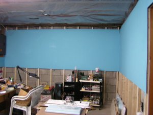

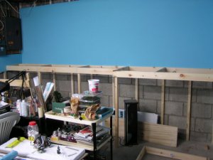

In this shot I'm standing in the corner from the previous shot.
Now I have to go paint some windows upstairs, and then I will start on the new benchwork.

Val, if it's not too late, you might consider curving your corners with a large sheet of styrene. Check the US Plastic website for real cheap prices on huge sheets.
Click on: "Sheet/Rod/Shapes" in the blue menu box
Then click on the "Styrene" link.
Click on "High Impact Styrene Sheet"
You don't need very thick plastic and you could probably simply cut out some vertical strips of the masonite to receive the ends of the styrene and create a smooth transition.
Wayne

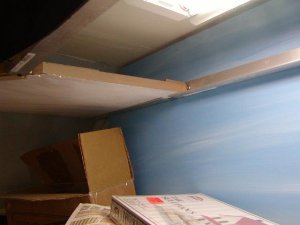

Okay folks, here is what I managed to get done tonight.
Russ, you're right. The plastic sheet is to keep dust and dirt from sifting through the joists onto the layout.

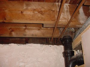

You have me inspired, pal! I have to get another gallon or so of wall paint to finish the rough-faced stone foundation in my RR room. It's already coated with Dry-Lok, but I don't trust it enough to cover it with wall board. If it springs a leak, I need to know about it. The French drains around the house are silted in and, although I have the downspouts emptying out onto the lawn, I still get some trickles after a heavy rain in one of the corners. I'm going to cover up the floor joists with a drop ceiling. I thought about covering them with fiberglass window screen material and then painting the screen, but I dunno. The top of the foundation would still be open and a drop ceiling would butt right up to the top of the foundation wall. Dust is a BEEEEEEG problem in this ol' house....built in 1923. Are you going to have your work bench and storage in the same room? How about sharing a floor plan with us. I could use some pointers as I go along. My layout won't be up against the long wall, but will allow room for an operator to walk all around it and view the layout from any side. Well, so I plan, anyway! :rolleyes: I like the idea of attaching the backdrop directly onto the wall studs. Sharp! :thumb:

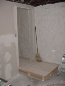

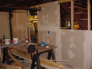

Here's what I've been working on. The sheet rock wall divides the basement in half giving me a room approximately 14' X 25'. The wall is completely sheetrocked with wiring roughed in. In the last view you can see the open sills that need to be closed off. This is best done with a drop ceiling in my case. The dividing wall will be used for my model building bench, storage cabinets, etc. I'll finish painting the walls soom and then have to get all of the spackling done. I have a couple of folding doors to install, the ceiling to put in, wiring to do, floor to paint, cabinets to install....phew! :rolleyes: :eek: Then I can get to work on my layout...maybe in the Spring!
Russ

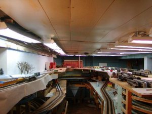

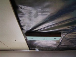

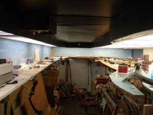

I have a basement where dust falling from the main floors flooring is a real concern as well. I did as Val has done, and installed plastic sheeting. Where pipes carrying water were located, I punched holes in the plastic to allow and future leaks to seep thru rather than accumulate till its weight brought it down on the railroad as a flood. As you'll see in the photo, I then covered the plastic with very cheap paneling. I chose a light color to help bounce back the light. I also attached the paneling so the section under the pipes can be removed without removing the rest. If I see stains on the paneling there, I'll know water is present. At least thats the plan!
And here is the other aisle where a valance has been installed. I painted the ceiling over the aisle section black. I made light panels from ripped 1x4 and whte butcher paper. I'll post a photo of one of the panels next.

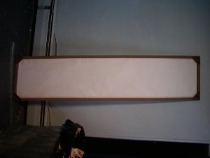

Here's a light panel, just some roughly 3/4 x 3/4 wood ripped from 1x4 with gussets in the corners, I rolled out butcher paper on the floor, coated the wood with contact cement and then flipped over and cut the paper even with the edges.
