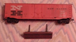

I make my own, using a small masonite pad under a rail car. It is mounted to two roofing nails that protrude up into the bottom of a boxcar and then dragged around the layout with every other train.

Thanks for that , the track cleaner idea looks like something I can make . I like you're little sign off too . I couldn't agree more .
