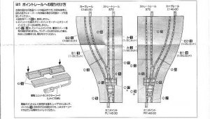

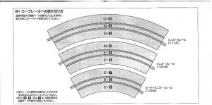

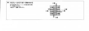

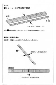

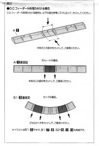

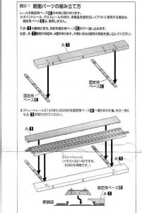

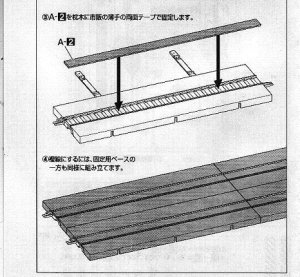

Below are some scans from the Tomix 3076 instruction diagrams.

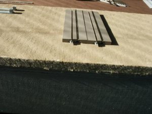

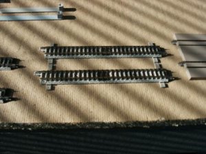

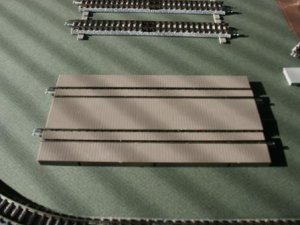

The first step in assembling the tram track kit is to add the the support piece that goes under the track. For this straight piece, the track is Tomix 1021 140mm in length. The track snaps into the support piece.
I needed to use glue to hold the piece together, but I still wanted to be able to change track configurations if need be, so I used Woodland Scenics Accent Glue.
