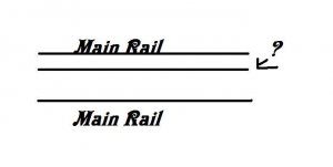

That might be it. I don't think that is it in the museum, though. I saw some of the cars on the middle rail, too. I don 't get it! If it's for electricity, than the car must get shocked and burn. Here's a diagram of what I saw at Travel Town.

Wo! I knew there was narrow gauge, but never knew they mixed them. I guess the obvious things never come right on time, huh? Well, new Q. With this system, can they have for example a standard gauge engine pull narrow gauge cars assuming they have the same kind of couplers?
Ok I'll take this the other direction. I think he's talking about the 3rd rail inside the two outside rails. That right JH? Is it off set from the other rails? Closer to one rail than the other? Or is the rail your talking about actually sit outside the 2 tracks elevated a little?
If that is the case for the first description then you are probably looking at dual gauge track. One is standard gauge or 5 feet 8 and 1/2 inches and the other is 3 foot gauge or narrow gauge track. This was common throughout the West and even some eastern states. This was a yard or station that had train service by Standard gauge and Narrow gauge railroads. They would interchange with each other.
If you talking about the second description then it is a 3rd rail power pickup as Squid said.
Slip of the fingers there NHGuy? Standard gauge is 4' 8 1/2"... at least on this continent :p :D
