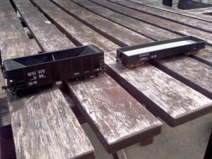

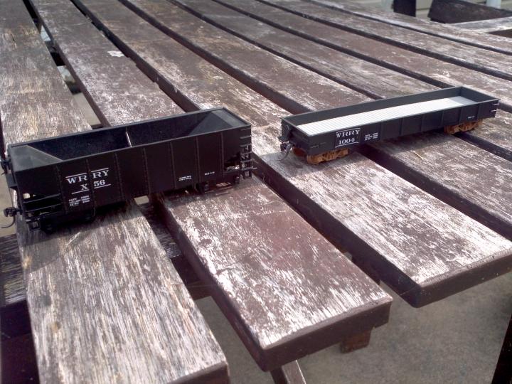

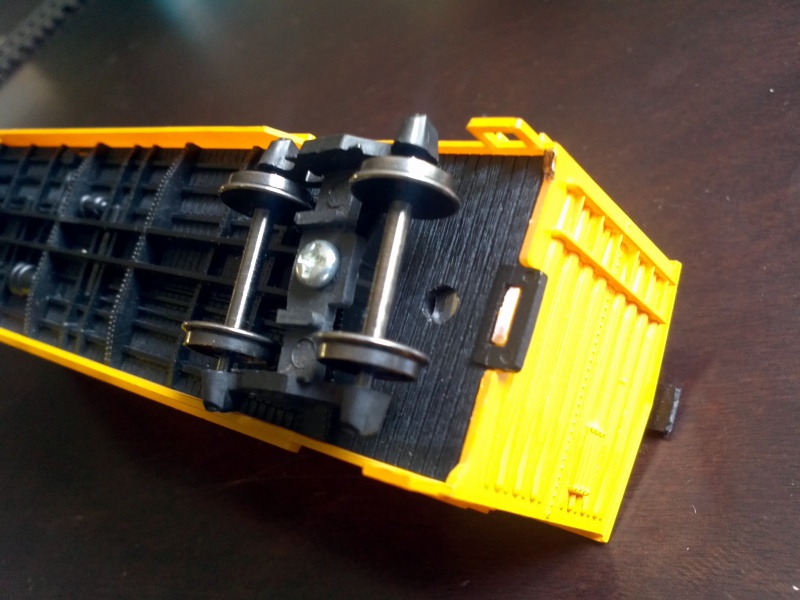

I've completed two more cars for the WRRy today. The first one is the company's ballast car X56, a slightly reworked Tyco operating hopper car. I say slightly reworked because it originally had Talgo trucks on it which had to be converted for better in train handling, so what I did was drill a hole on each end of the car's frame for the Kadee coupler boxes and install couplers, slap some Roundhouse Fox trucks on it and the signature black paint and decals and here it is ready for service. The second car is a Ertl 40' gondola that just had it's body repainted and Kadee couplers added and then decalled. This car is missing a few grab irons, and honestly I don't know if I'll have a layout anytime soon but I am taking Bill Nelson's advice and leaving off details like such until my daughter gets older and is less curious to why Daddy plays with trains.
I was actually a little disappointed, I hoped to get two more cars done and to do a little more troubleshooting on the club's Southern 2-8-0 today but time is the demon in this game.

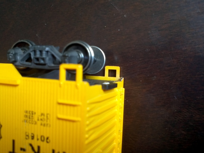

Since last time I've reported in, very little has been done. Apart from the usual things that keep me from train time, my truck needed a oil change and coolant flush, I had CQ (charge of quarters in the barracks, for you non-military folk), and we've done some family stuff out in Land Between The Lakes. On another note, I've also ran out of Kadee couplers and usable trucks for rolling stock, as many of the Whiskey River's pieces of rolling stock started off as basket cases and I've done my best to polish the turds. Yesterday I ran out of black paint, which the roofs of boxcars and cabooses and underframes need to be uniform.
I have noticed that Kadee came out with new truck styles, their 580 series of caboose trucks with leaf springs. Come payday I'll be ordering a big ol' box of the fancy whisker couplers, some paint, a package of centering springs for the original style of Kadee's and a pair or three of the leaf sprung style trucks for the cabeese. Right now some of the cabeese are riding on Bettendorf freight car trucks, which is fine and dandy for other modellers, but this is also a test for their possible use as a tender truck. If they look and work rather well, I'll slap a few under a tender with the pickups modified from the Kadee coupler centering springs.

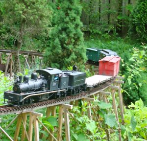

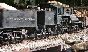

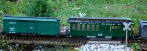

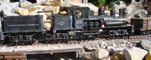

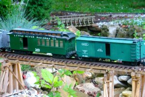

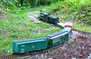

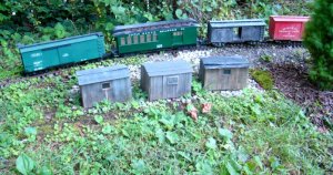

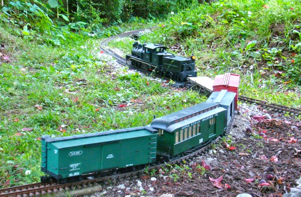

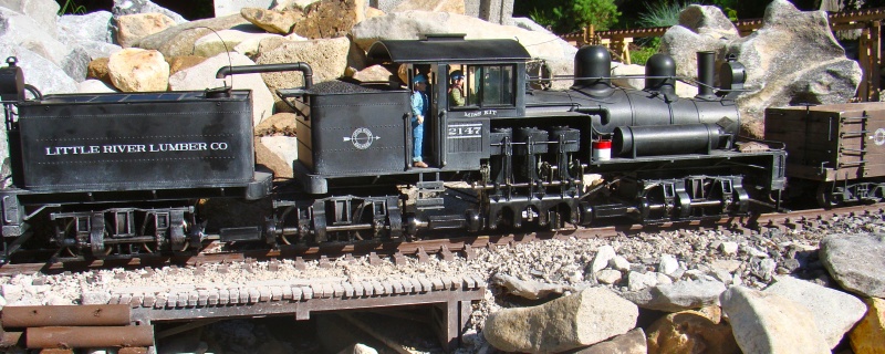

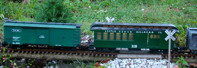

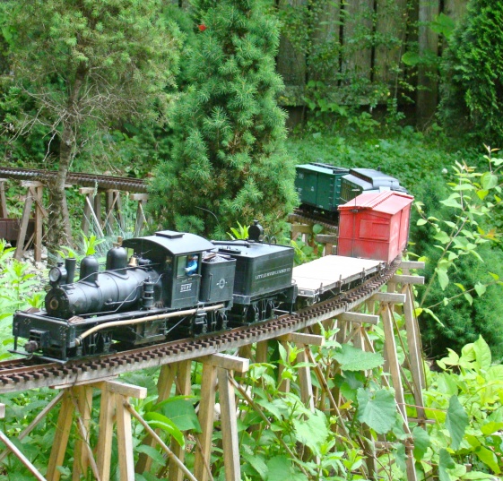

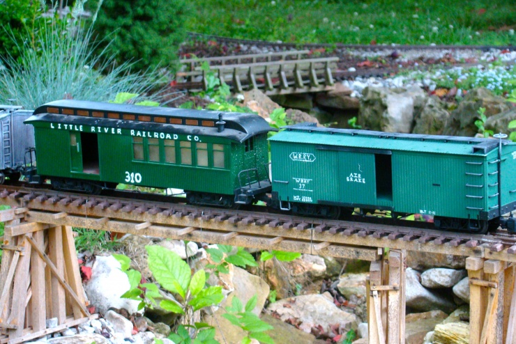

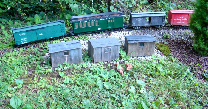

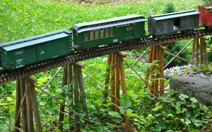

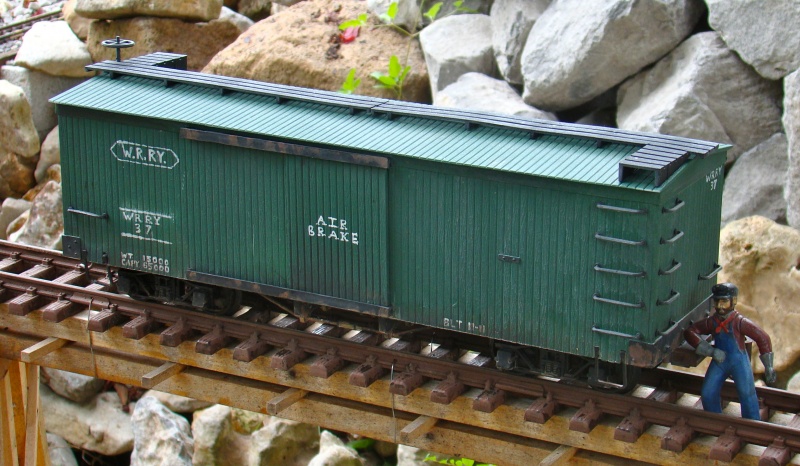

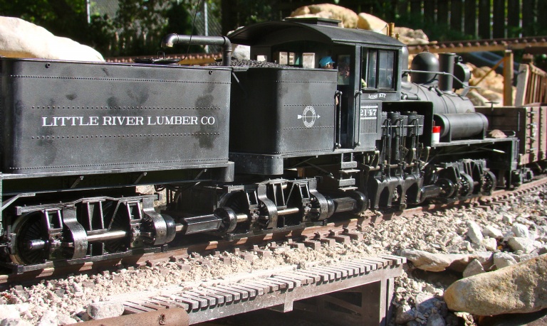

Whiskey RIver Box Car #37 survives the wilds of the Smoky Mountains
Hey Tyler
Its those last 45 miles in the Smoky Mountains that proves the mettle of machine and creator. The #37 WRRR box car loaded with goods for the loggers in East Tennessee was up to the test that the twisting climbing rails in the mountains of Eastern Tennessee put before it.
Important material and liquids were needed for the men at Tremont logging camp. Little River Rail Road management felt the interchange car from Wisconsin was up to the task of traversing its very treacherous rails that had claimed many a lesser man and his machines.
#37 reported in and took up position in the mixed train pulled by #2147. It made it through every gauntlet and arrived to the cheers of the men in the forlorn logging camp.

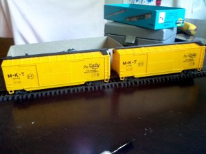

AHM Boxcars

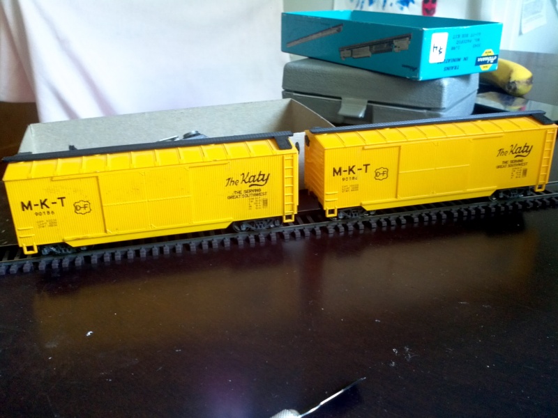

I got a little work in on some of my more unique rolling stock today, that being my pair of AHM double door wood sheathed boxcars and my tool car X51. I don't have any pics of the tool car at all yet, but to inform you it's just a plain jane Mantua clearance car minus the thing that goes around the body of the car. So far all that's completed to that is I added some underbody details to it, chopped off the horn hooks that mount to the trucks and glued some shims to the bottom of the car floor to mount the couplers when they come in.
The boxcars I do have pics of, and like the tool car, no couplers were mounted due to my dry spell of Kadee products. I bought these cars when I was in Korea from eBay and had them straight home so I never got to inspect them post purchase. These cars have a tab to secure the body to the floor at the end where the couplers will be mounted and had to be modified. I just took my trusty and rusty Xacto to the part of the tab that stuck out and hacked it off. In theory this should work ok, as most of the cars' life will either live on a layout or in a box and shouldn't be moved too much by the 0-5-0 switcher. Naturally also, these cars will be painted and lettered in normal WRRy garb instead of the beautiful paint scheme AHM decided to give them. Prior to paint though, I may go crazy with it and do something similar to this: http://www.trainlife.com/articles/397/perfecting-plastic-cars
I also noticed one thing on both of these cars, check out the slogan... someone in Yugoslavia needs to brush up on their English grammar.

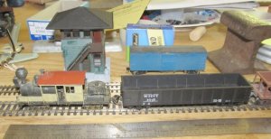

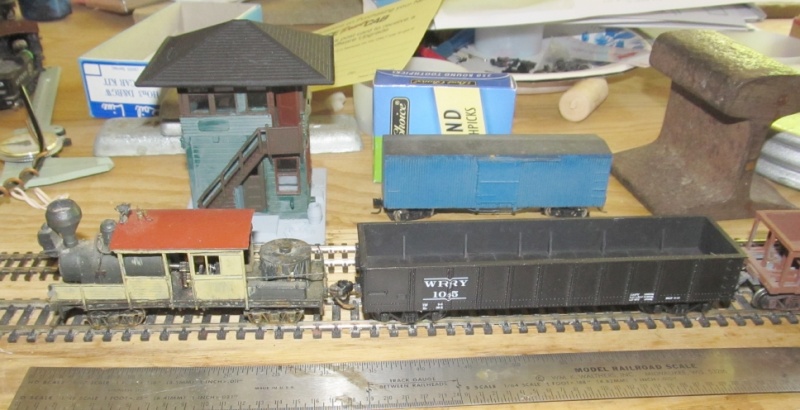

Cleaning off my workbench I came across the Whiskey River Gon Tyler had painted and lettered up for use on The DG CC & W RR. I got couplers, and it is ready to up to the RR room.
#4, a class a climax has been living on my work bench, as it is tiny, and can let me know if other locomotives I'm working on have thier motors wired in the right direction

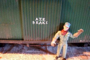

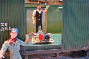

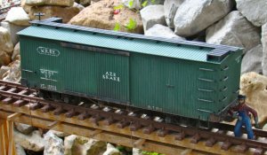

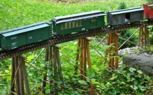

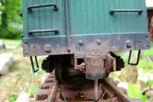

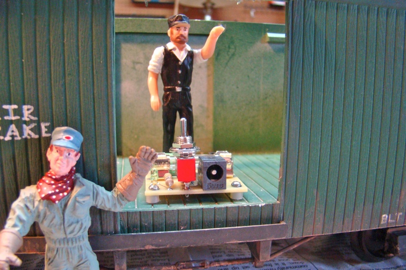

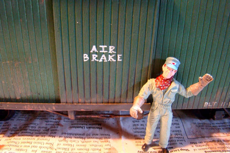

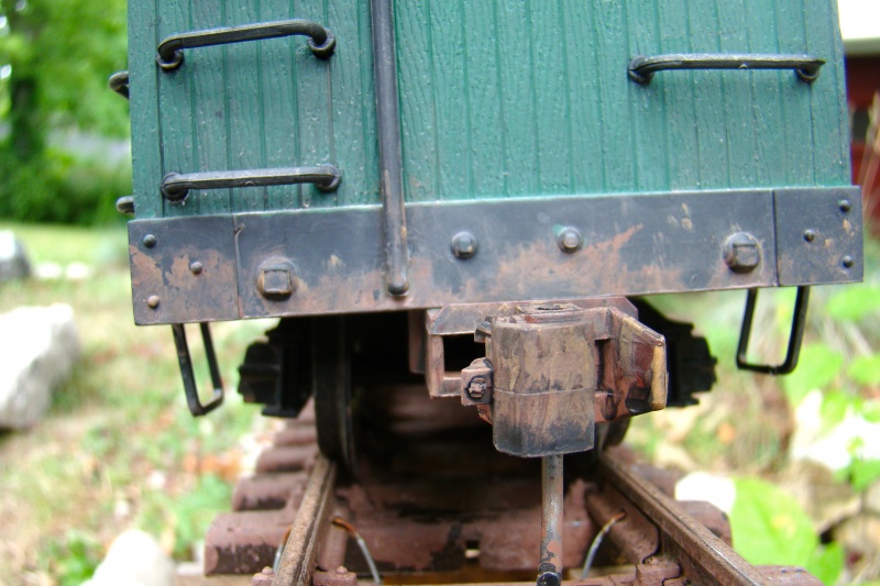

WRRY #37 gets a make over.
Tyler's beautiful box car, WRRY #37, is going to work on the Large Scale Little River Rail Road.
I has received body mount Kadee couplers ( about as big as half an HO steam engine when done in G scale) and is weathered a bit for the travels it is making from Wisconsin to Tennessee.
Timmie is excited about what is inside the box car.........the first electronic components for a trailing battery car for all the LRRR steam locomotives.
Pictured is a Printed Circuit Board with on/off switch and plug for the battery charger and all important fuse to prevent the "white smoke phenomena" noted with first time electric projects.

Doc Tom,
That ol' boxcar looks amazing! I love the weathering job you did to it. The huge Kadee's look pretty neat on it too! I might just have to bring a note pad and take notes on how to weather cars. Some of my previous attempts were not so good, and since then I really haven't tried it (that and I joined the Army which took away a lot of my time). Anyways, I hope your new battery car works wonders for you!

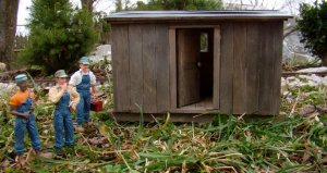

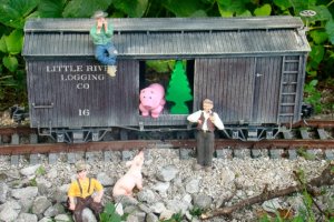

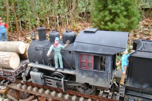

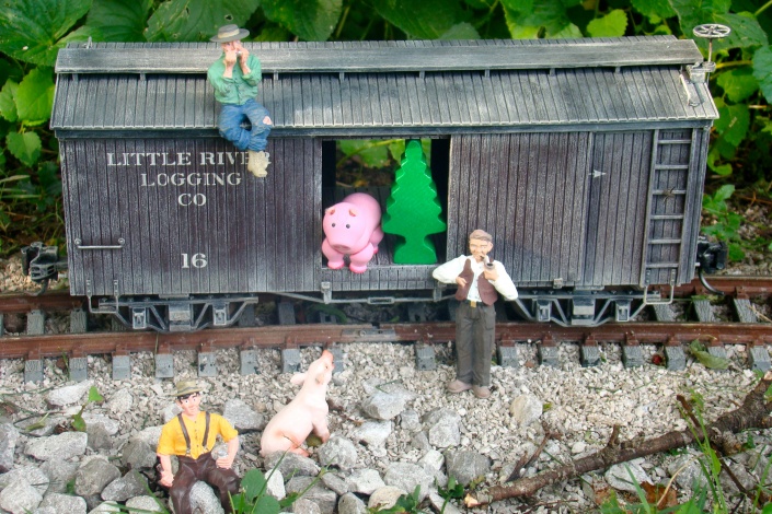

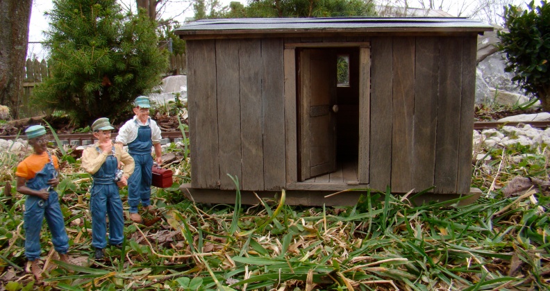

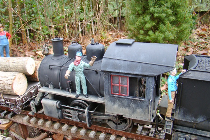

Hi Tyler,
Glad you liked the weathering. Actually the technique I used on this model is a little different than previous weathering. This is a technique proposed by Kevin Strang on the Garden RR websites. Here it is:
"I use acrylic paints (the cheap 99-cent Folk-Art or similar bottles from Michaels, etc.). I rarely actually mix the paint and the water together, rather I put some paint on a small plate or such, and have a cup of water next to it. I dip the brush in the water, pull a little paint onto the wet brush, and apply it. If I need it thinner on the model, I'll dip the brush back in the water and brush that onto the model to thin it."
This is basically an acrylic wash but his ideas offer a lot of control as far as thick or light. I used a very light technique on the WRRY box car.
Previous weathering jobs have been done by use of a India Ink wash first followed by dry brushing light colors after the India Ink wash.

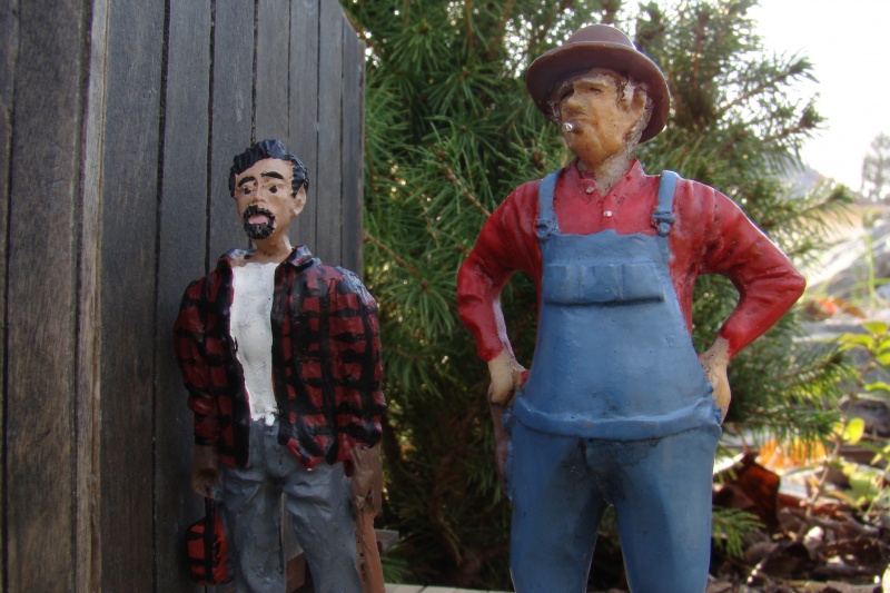

Here are some pictures of India Ink and dry brush weathered RR stuff.
Glad to help with any weathering you want to get in to.
Tom

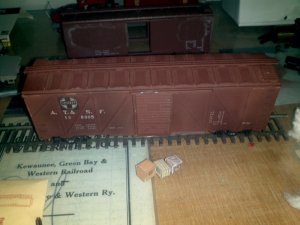

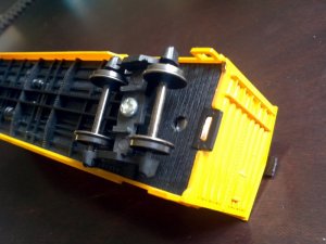

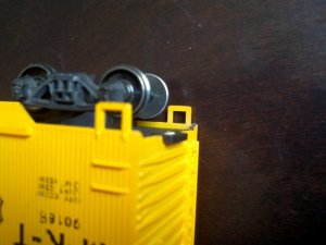

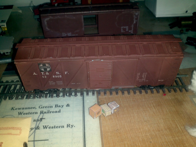

It seems like lately that my life is the song from The Guess Who, "No Time". At least stuff is selling decently on eBay to buy future railroad products. Enough venting for now...
I did make a recent purchase on eBay, a old (possibly) Varney or Roundhouse cast metal outside braced boxcar. It has Kadee's installed on it, but it was purchased with the intentions of falling victim to the most unusual form of copyright infringement: dissassembly to be duplicated. I plan to strip the paint and lettering off of it, dissect the car into each of it's core parts, make molds of the pieces, and then cast new parts. From there I can reassemble the car and have one duplicate of a interesting and out-of-production piece of rolling stock. More to follow, as if the first paragraph didn't explain it clearly enough... read it again.
