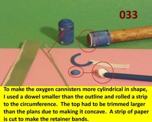

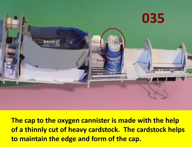

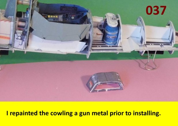

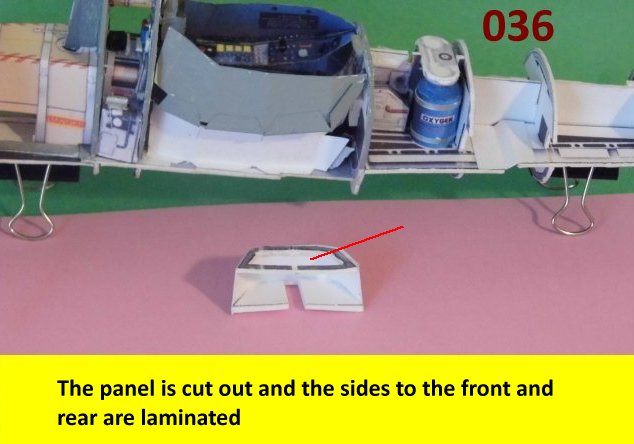

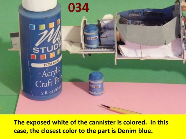

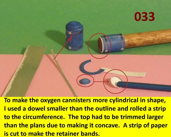

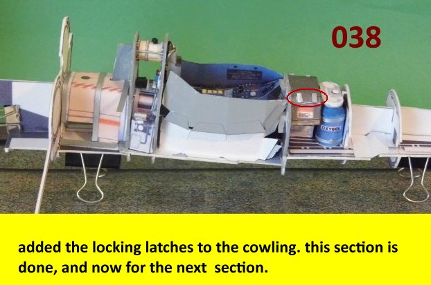

Here is how I made my oxygen canisters. This procedure will work with the smaller parts too Keep in mind, that the wrapping tool, should be smaller in diameter than the piece being made The wrapping will give the part structural strength. The top cap or the oxygen dispenser cap has a thin laminated edge which helps in adhesion of the parts edge stripping. Enjoy and hope to see some more of the other builds:thumb:

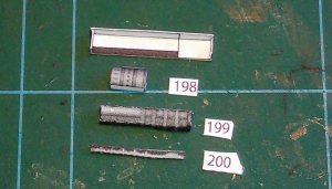

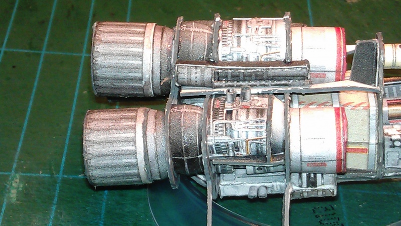

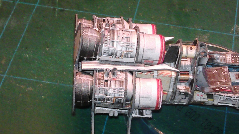

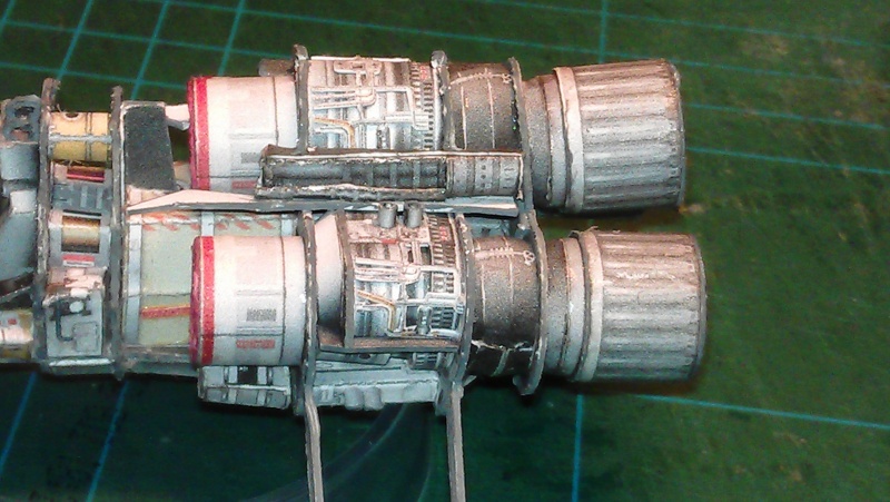

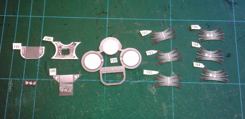

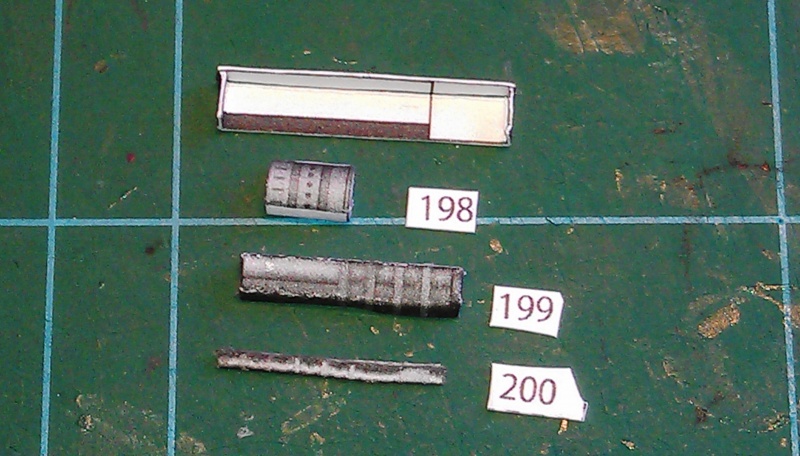

Here are the components for the last engine bulkhead and after burner.

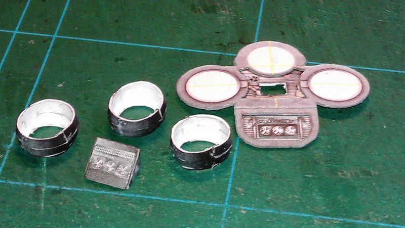

Components assembled.

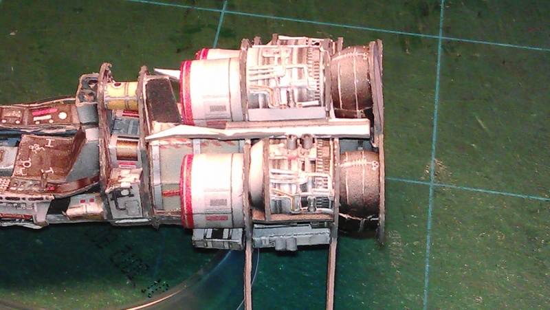

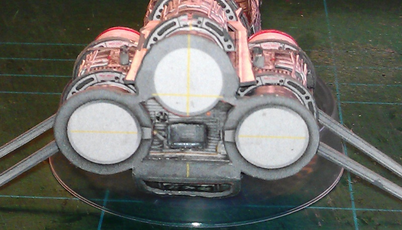

Components attached.

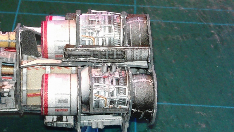

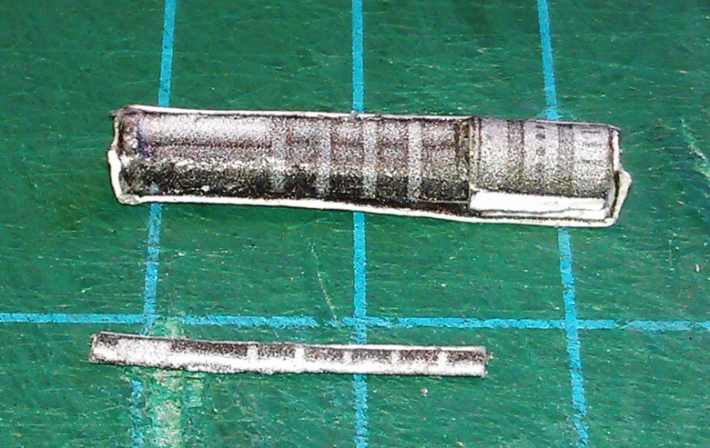

Components that go on either side, between the the upper and lower engines.
components attached.

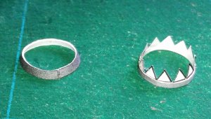

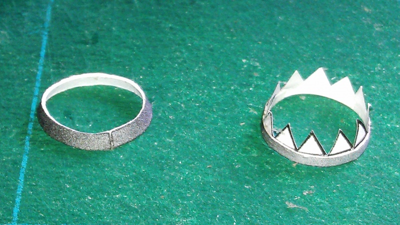

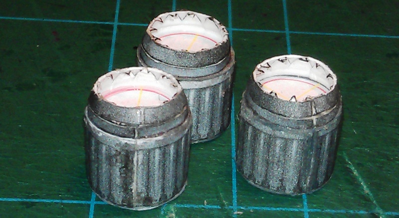

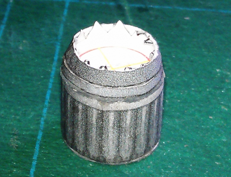

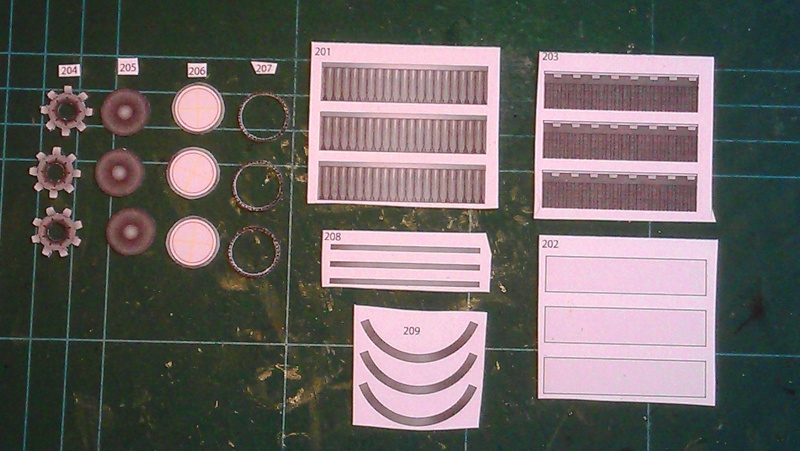

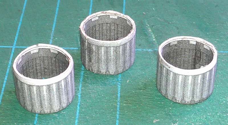

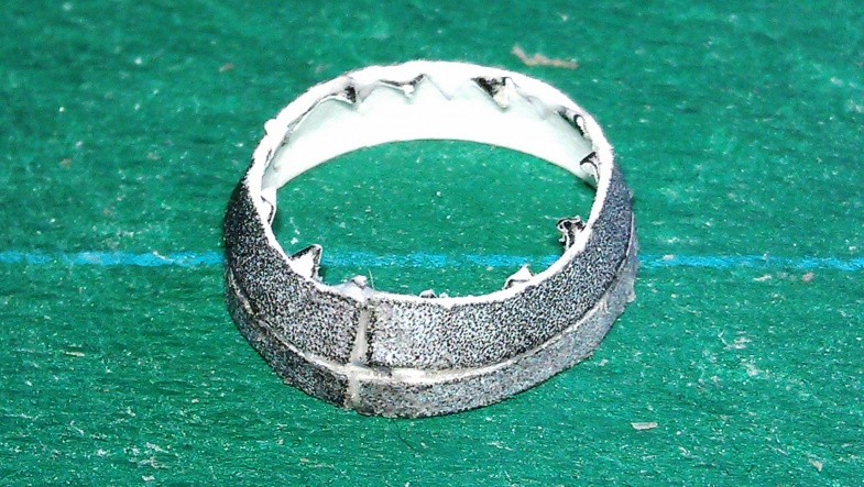

Here are the parts for the engine exhausts.
I decided to go with the black exhaust disks, because, once this Viper is finished, it will be in either a "Repair" or "Overhaul" state.
I used glue strips to help reinforce the edge glued seams.

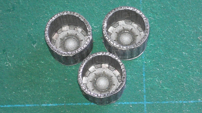

Exhausts are assembled

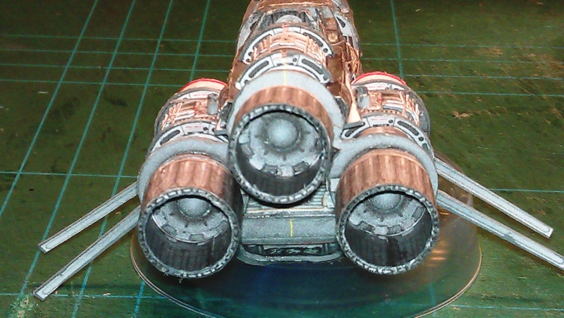

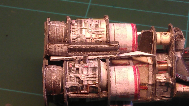

Exhausts are attached.

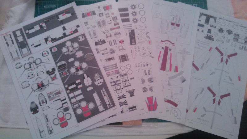

Fellas
I wrote I was going to take my paper home and print the Viper, didn't I? Well, here it is, as you can all see in the pic. I keep my promises. :thumb: :mrgreen:
Now, I'll start the build tomorrow :oops:, and start being an active part of this group (AT LAST!!! :rolleyes:).
