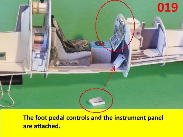

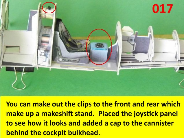

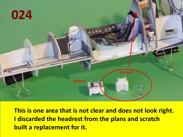

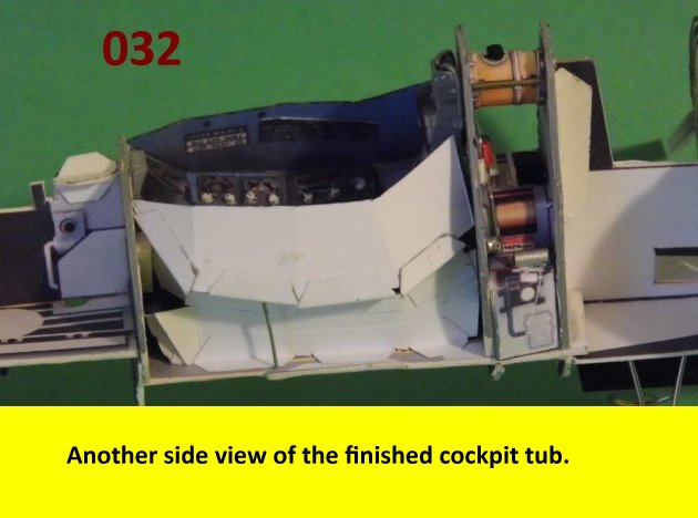

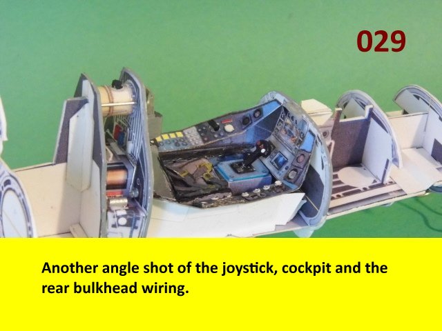

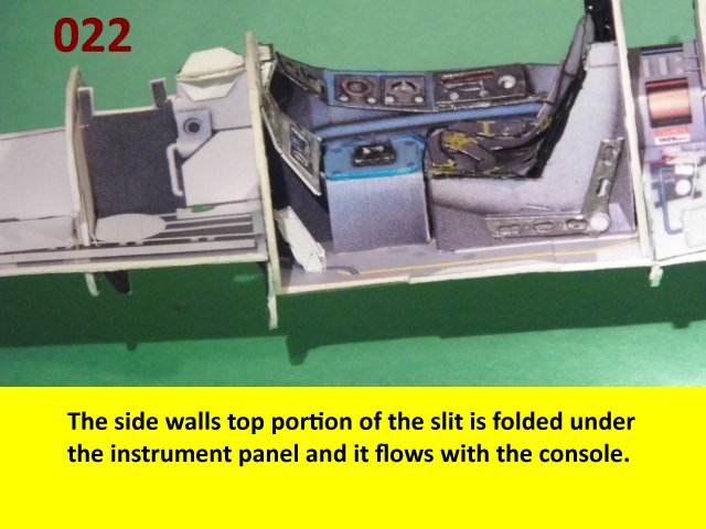

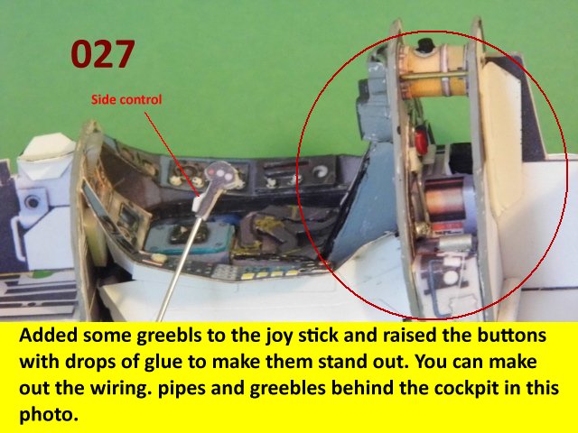

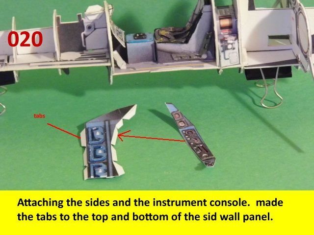

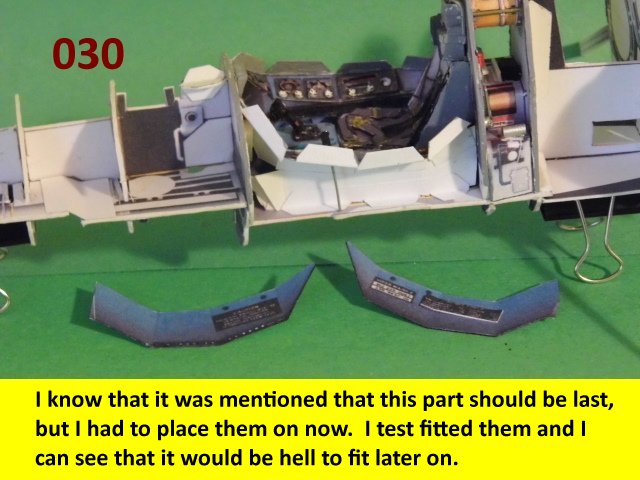

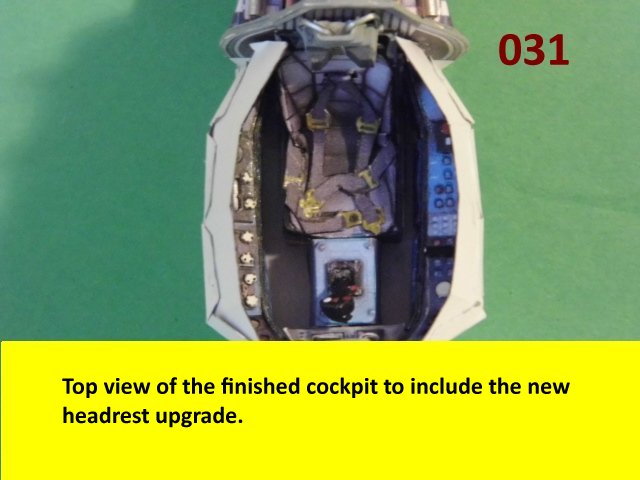

If I may make a note, It was pointed out to me that the upper side panels are suppose to be attached to the inside of the skin for the cockpit section. Please see attached pic.
Keep in mind, that to place the skin over cockpit, you have to place it over the cockpit side ways. When you turn it to align it with the cockpit, the side panels may catch and cause damage to the cockpit walls. That is my reasoning for placing the side wall panels on when constructing the cockpit. There is very little space tolerance when applying the skin on this model.wall1
