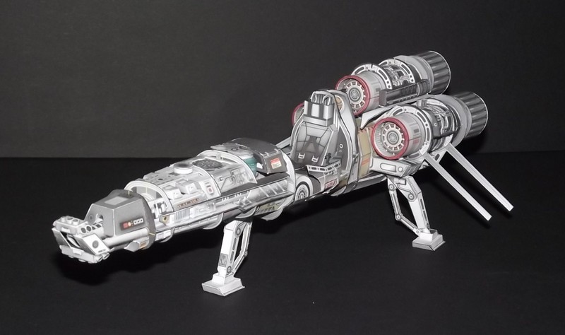

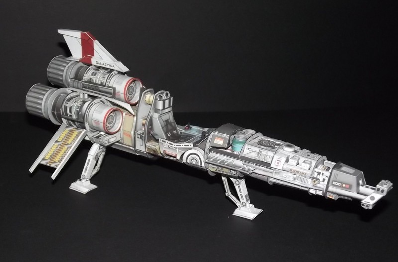

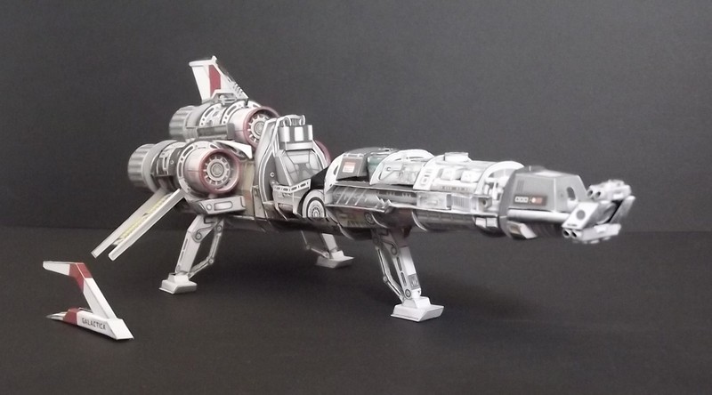

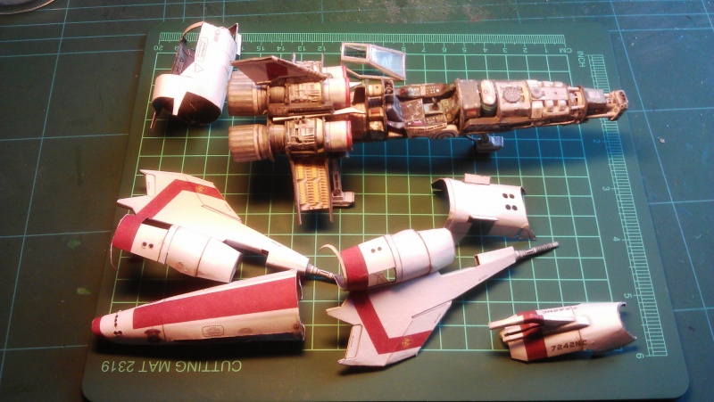

Another Scorpion Shipyards progress report

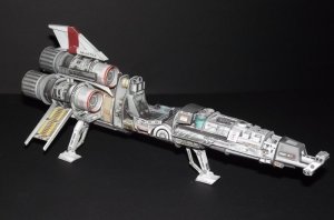

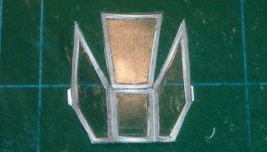

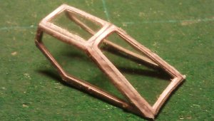

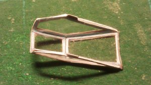

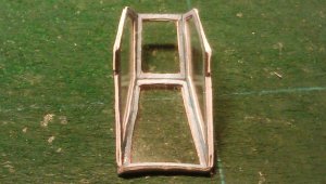

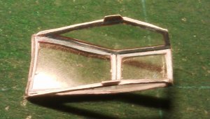

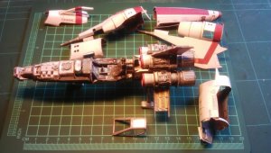

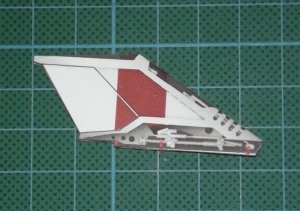

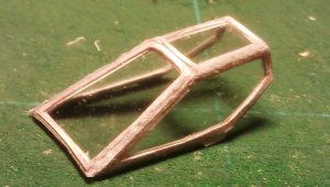

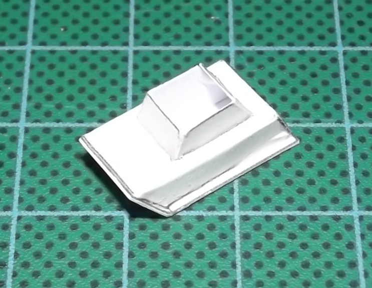

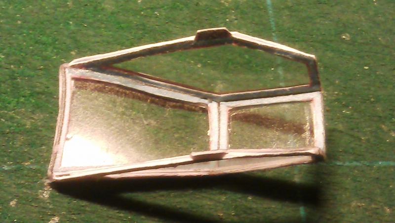

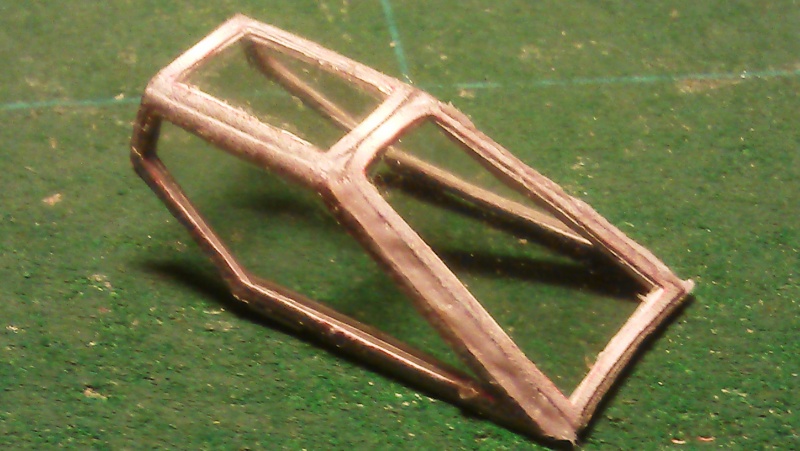

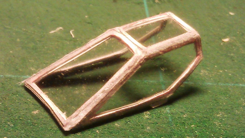

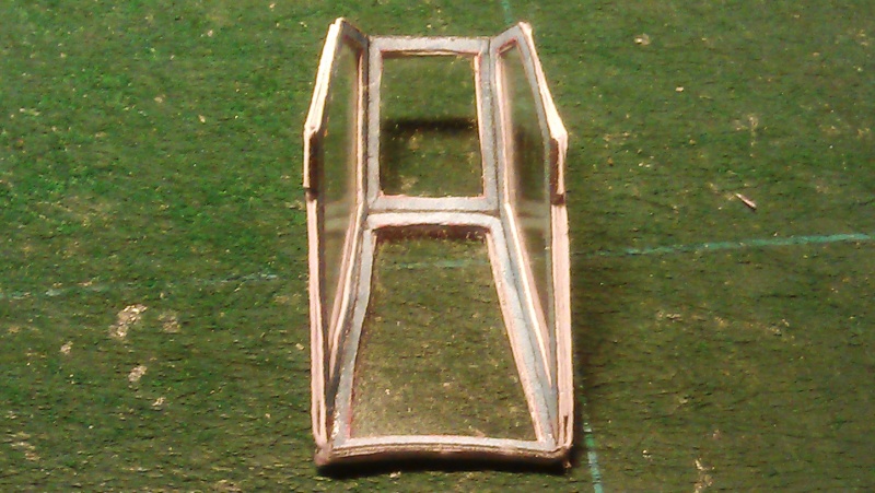

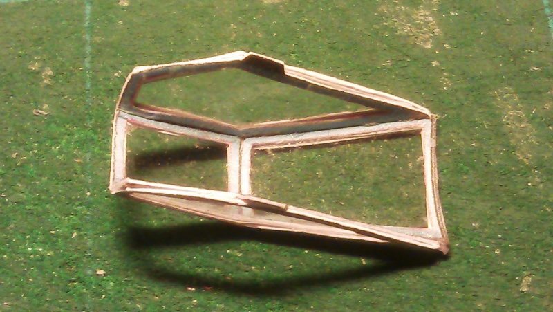

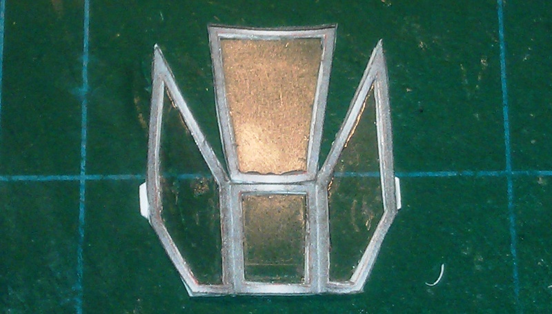

Here is the final component to the plane (as a whole). The cockpit canopy.
As you can see, I did put clear plastic in it.
The canopy is assembled.
Since I did put clear plastic in the canopy, I used some of the paper putty to fill in the gaps.

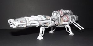

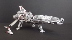

Here are all of the finished components of the plane.
Now all I have to build is the diorama itself (and all of the components for it), which I will include in this thread as well.
Please stay tuned to your local CBSC for further updates and progress as it happens.
Thank you for watching.

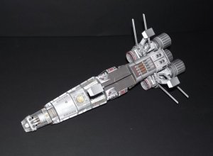

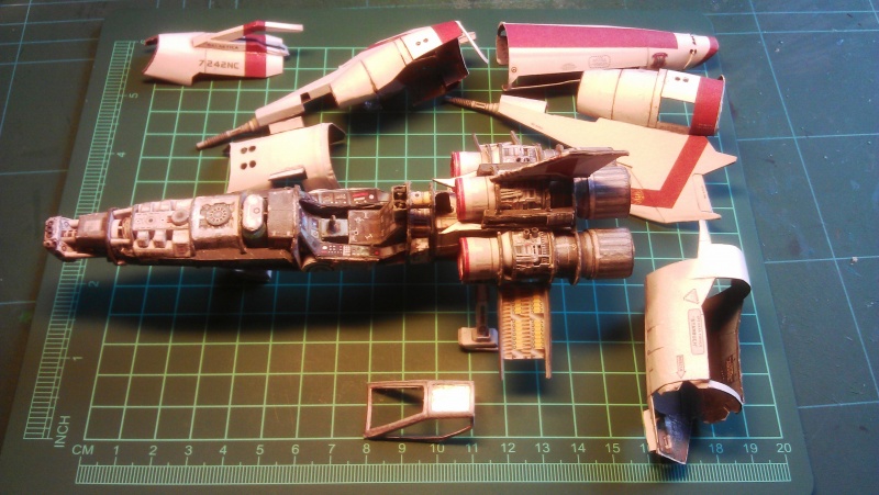

Rhaven, One down and now for the sister Viper fully dressed. Disregard the interior with the exception of the cockpit.

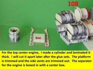

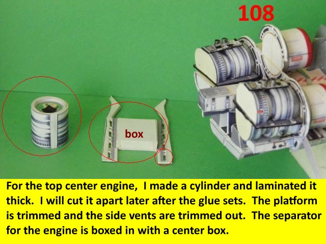

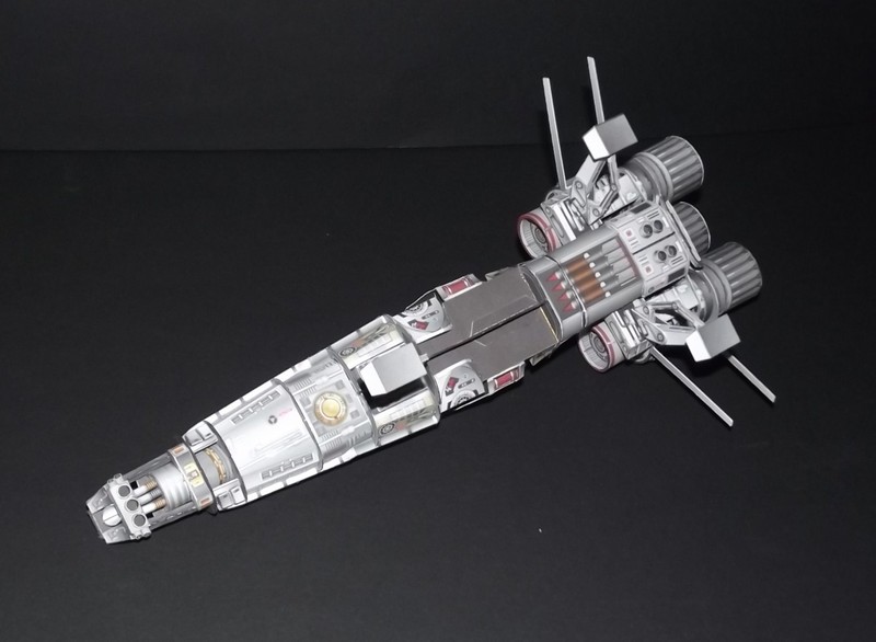

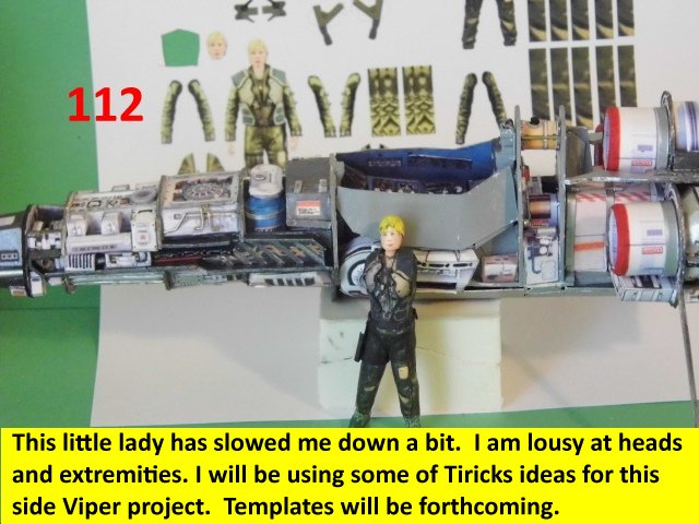

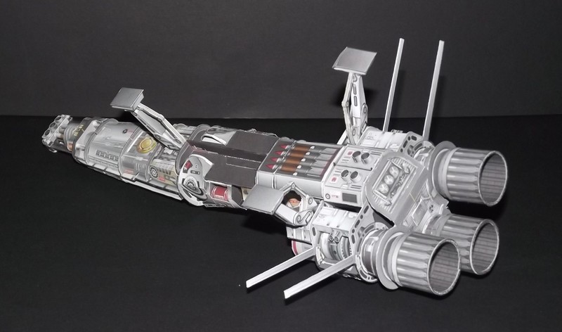

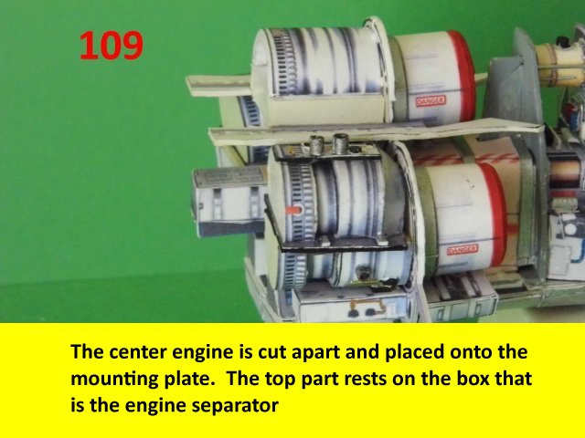

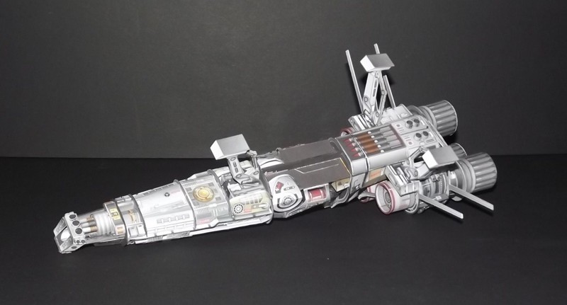

As for me, I am trudging along and had a short slow down making an addition to the Viper. This is my first sculpture paper hybrid and the templates are done. I will do a build thread with the next figure and post it for every-ones benefit. At the moment I am working on the arms. As for the viper itself, the rear engines will receive its complement of wire. tubing and greebles. I should be back soon with more. Enjoy and see you all next posting.:thumb:

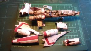

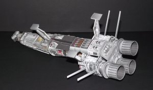

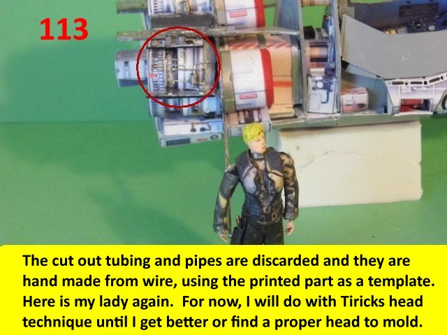

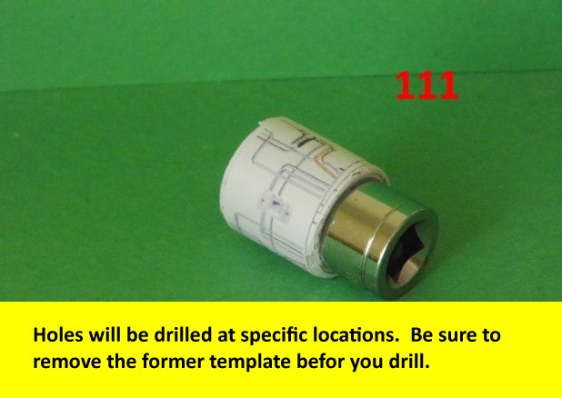

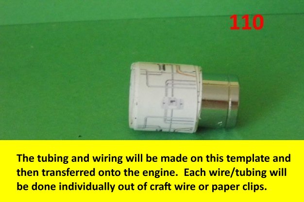

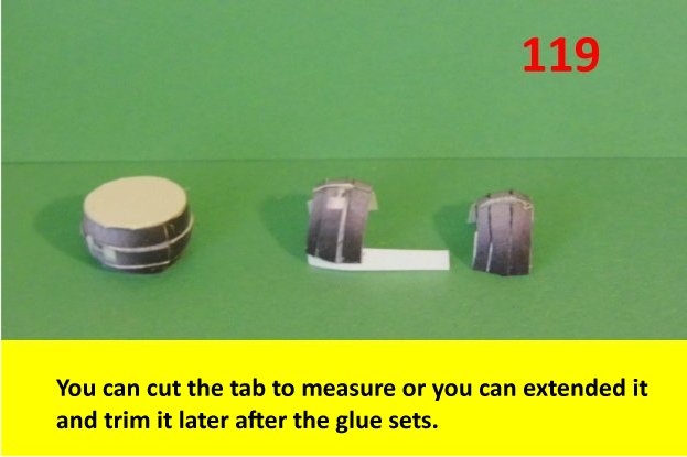

silveroxides Viper

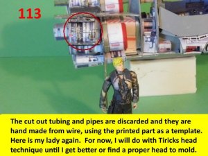

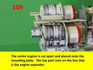

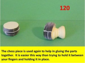

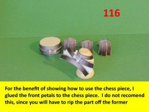

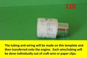

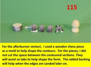

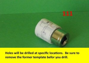

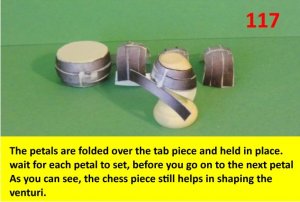

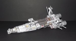

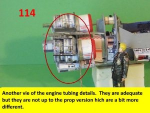

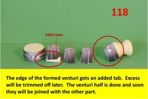

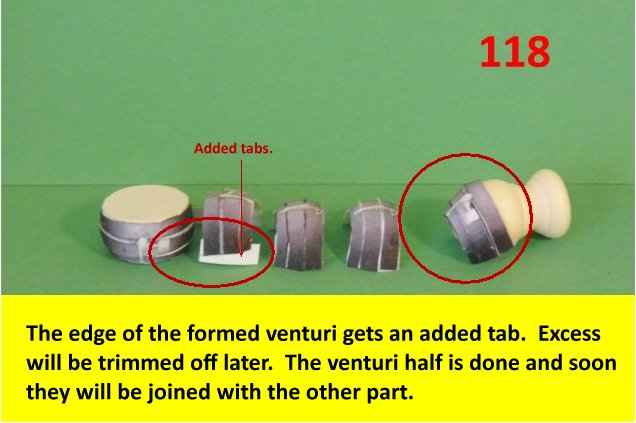

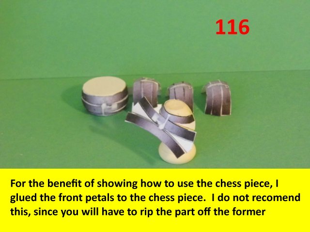

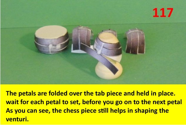

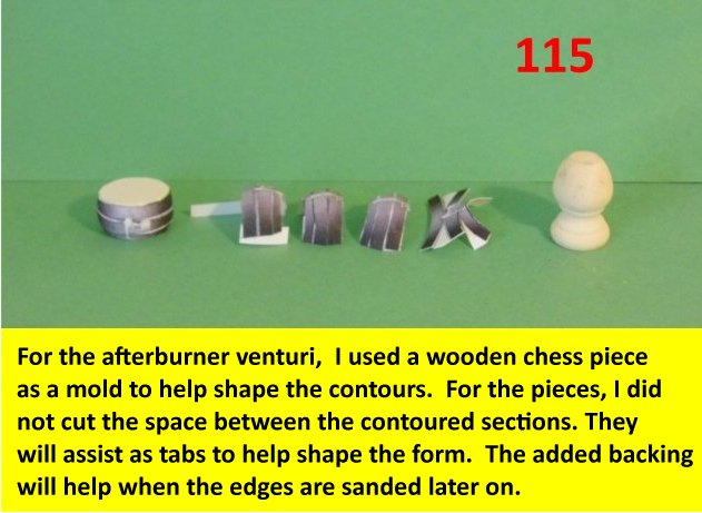

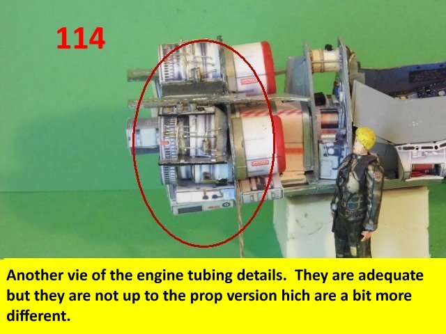

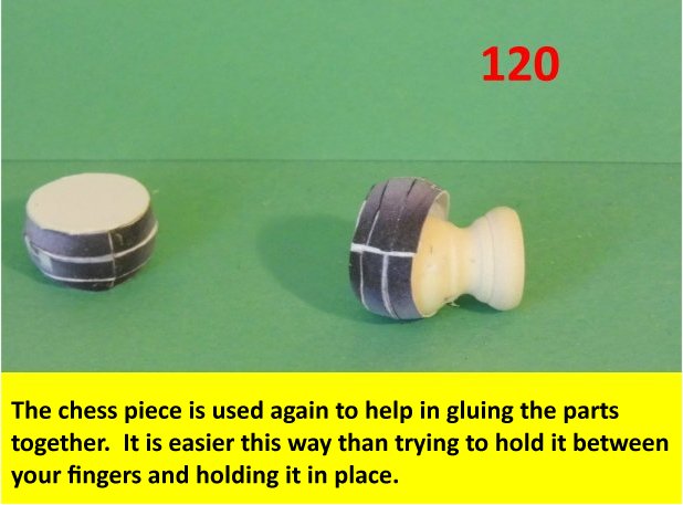

One Viper is finished in the appreciation thread and I am still trudging along. I have a few more details and techniques to do on this Viper. The figure will also be added to the build and while I am not very good in the head construction, I will have to use Tiricks technique for the meantime. As mentioned earlier, I did not use the printed tubing but did use it as a reference to hand make the tubing.pipes out of wire. Enjoy and see you all later with more stuff from my goodies box.:thumb:

The engines look GREAT!!!
I like to added detail with using the wire for the tubing.
Your Starbuck figure looks REALLY GOOD!
The way you made the after burners is a GREAT IDEA! It looks like it will keep everything nice, smooth, and contoured to the right shape.

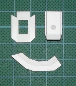

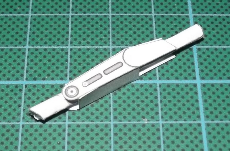

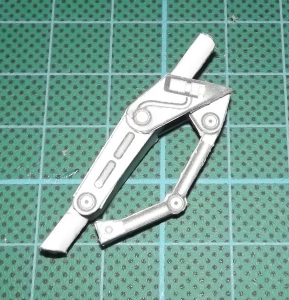

+++ German sitrep +++

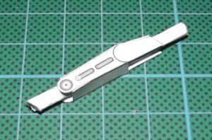

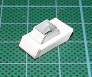

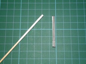

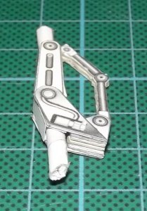

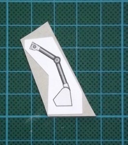

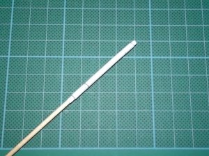

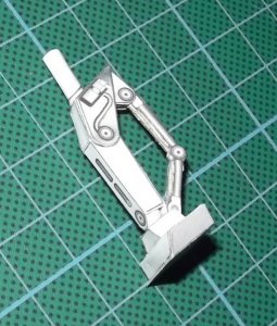

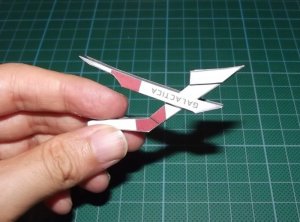

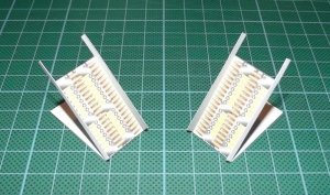

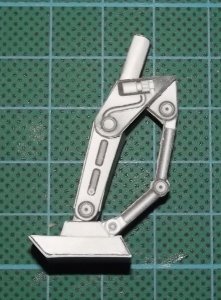

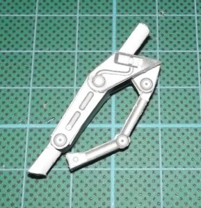

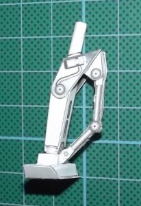

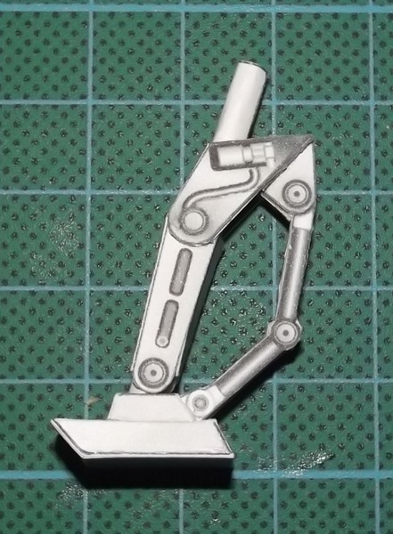

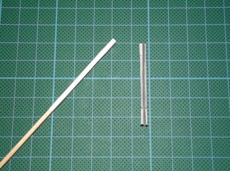

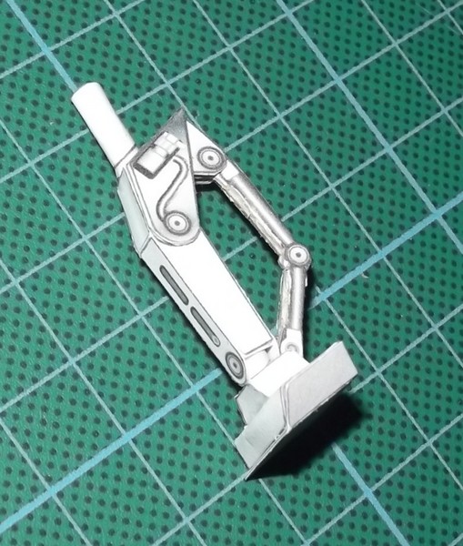

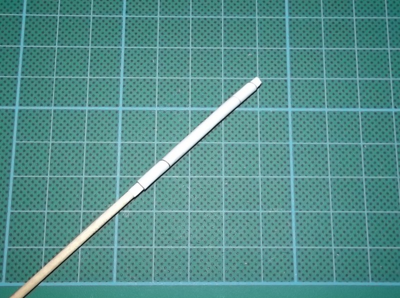

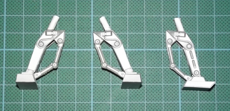

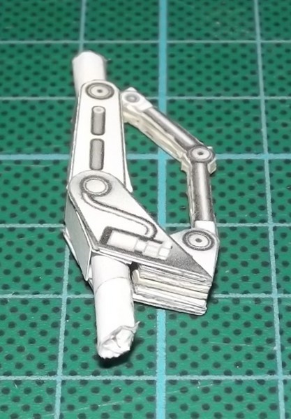

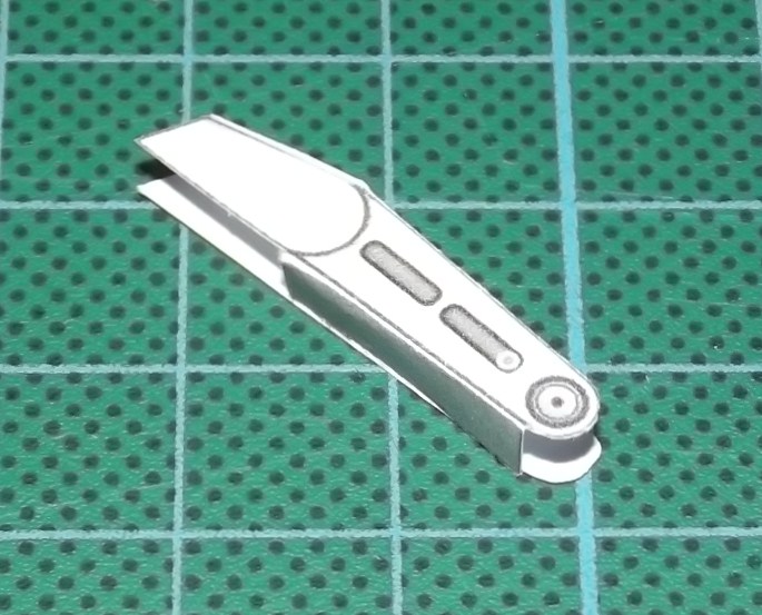

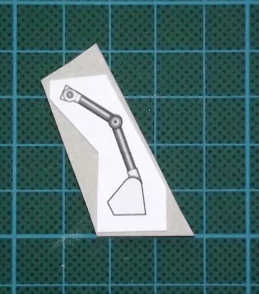

Now then, I had to insert two layers of cardboard to align the front landing gear. Like RB I reinforced the central tube. I inserted a wooden rod. A test-fit showed that the rod's diameter was smaller than the tube's diameter, it had to be increased a bit. To do so I glued a piece of thin paper around the rod.
Then I pre-shaped the tube: I applied some spittle to the back of the part and rolled it up around another rod. The spittle makes the part flexible and prevents it from wrinkling during the forming. However, this has to be done carefully; the part must not get wet. After forming the part is put aside for a minute to dry. Then I glued it around the first rod. Finally everything was cut to shape and inserted.

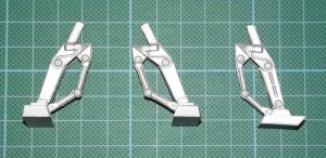

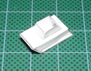

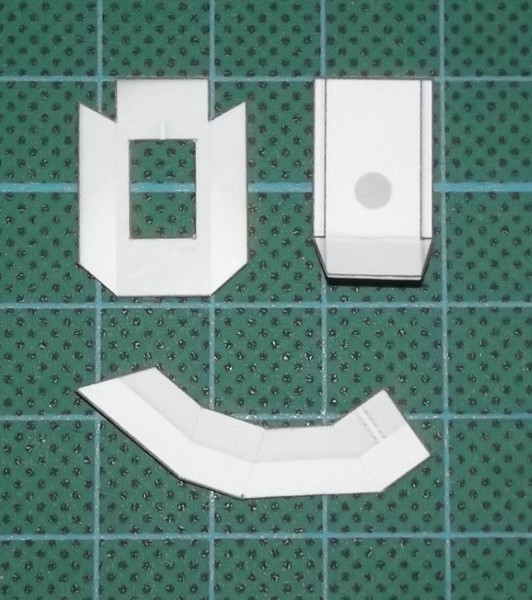

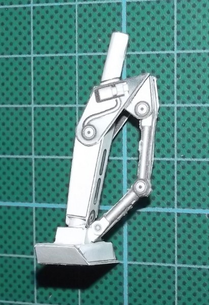

The rest of the front foot was assembled without problems.
The other feet were assembled using the same techniques.
The feet are attached - without glue, of course ;-) !

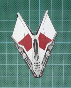

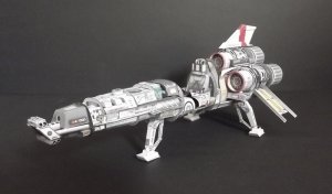

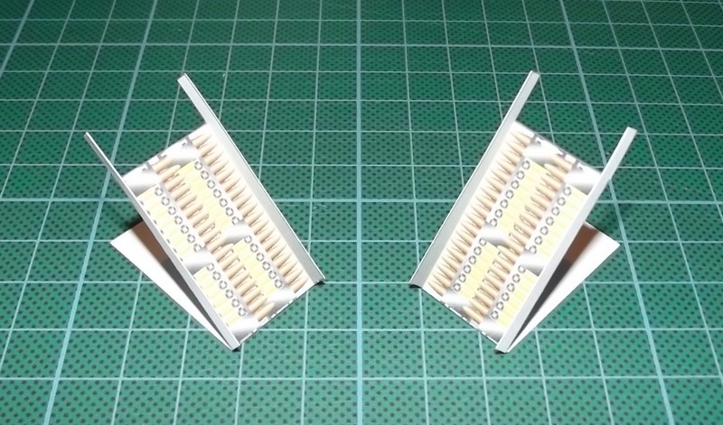

Now the fin and the wing inserts. Everything fits like a glove.

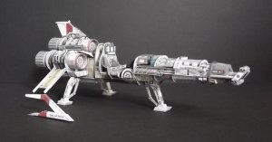

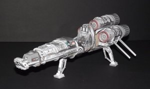

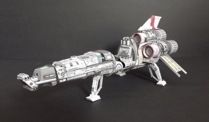

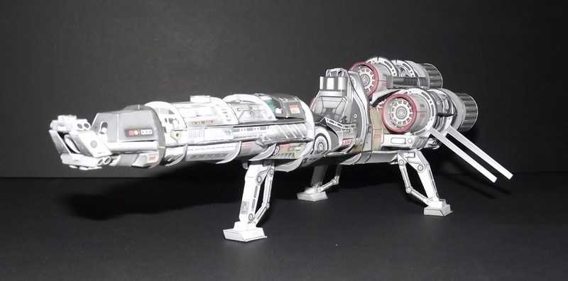

And the first pics of the legged Viper with fin cap! :p
CU later with the skin around the cockpit! :wave:

@RF: That is FAN(FRAKKING)TASTIC!!!
Even at the scale that you are making this at, everything looks PERFECT!!!
@Dan: Thank you for the kind words. As for your build, take your time and ENJOY!!!
Thank you all very much. But I only obey the plans and instructions by master UHU... :oops:
The next step will show if the skin fits... A very delicate procedure, I'm very excited. CU! :wave:
