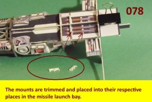

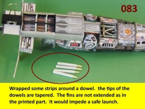

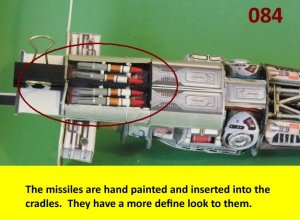

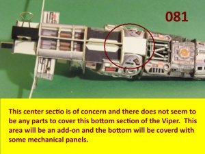

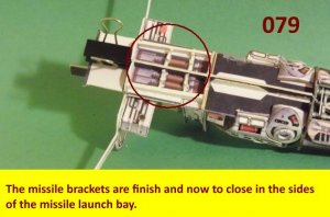

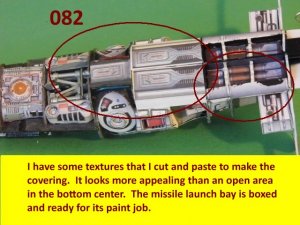

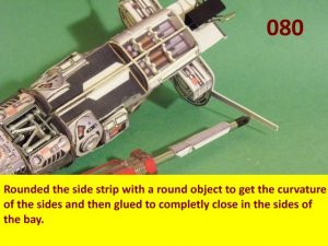

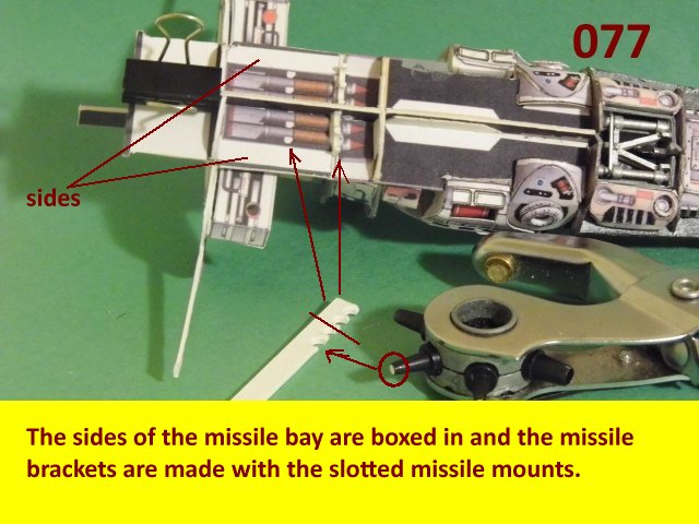

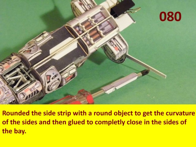

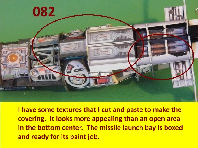

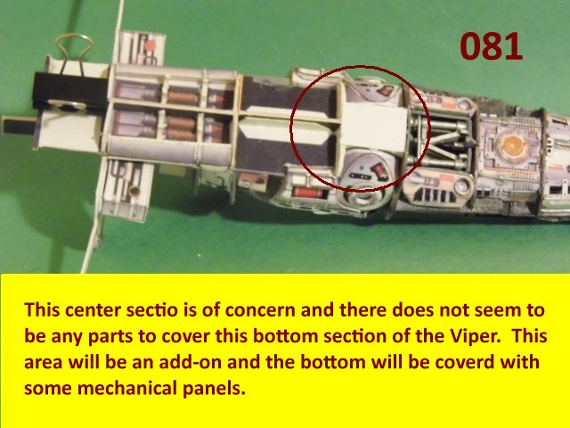

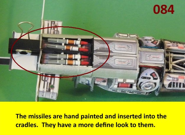

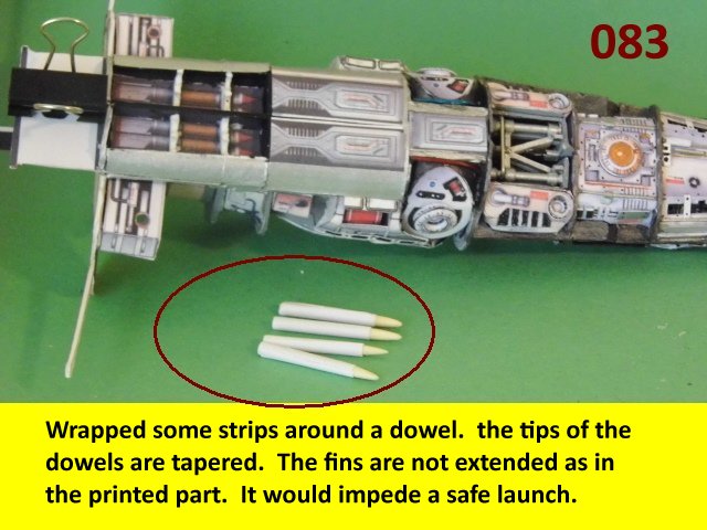

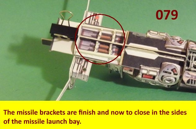

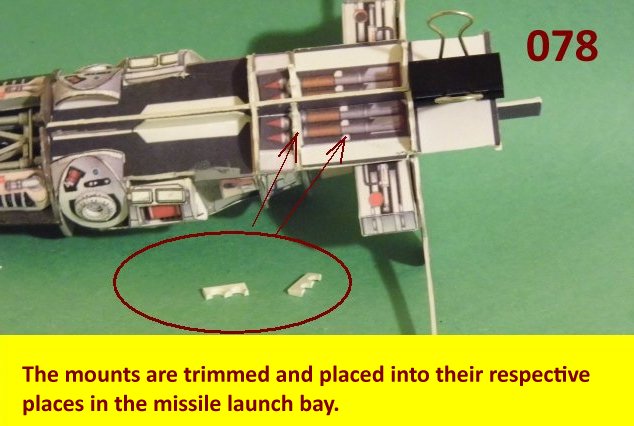

Here are a few more photo updates and ways to modified the build process. I depend on sockets and other tools to maintain cylindrical shapes. For the missile bay, I had to discard one of the lower bulkheads and make it into a full open bay. I would assume, that in reality, you would not see the missiles, because they would be inside individual launch tubes. As shown, it is a disaster waiting to happen when the exhaust is thrown back into the missile bay. A tube would direct the pressure outwards and help in the launch. Enjoy and see you soon with more photo updates.:thumb:

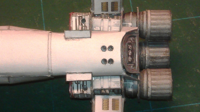

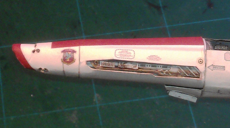

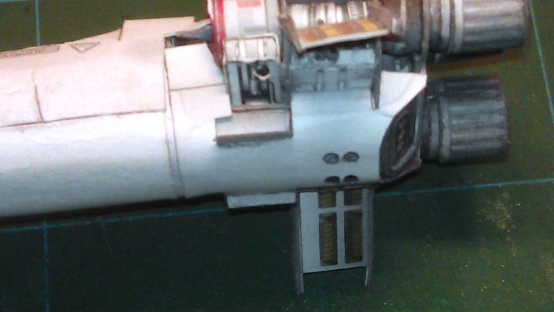

Here is an update on the skinning of this project.
I do have to say that I have made a HUGE NOOB mistake when making this model in 1:50 scale. wall1wall1wall1
I used 200gsm card-stock (which is what I had on-hand at the time). UHU02 said to use 160gsm card-stock. Because of such, I have ran into a few fitting issues (as you will see in the photos).
(*NOTE* I will finish this build out, but I will be displaying it with the skins off in the diorama.)

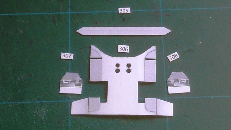

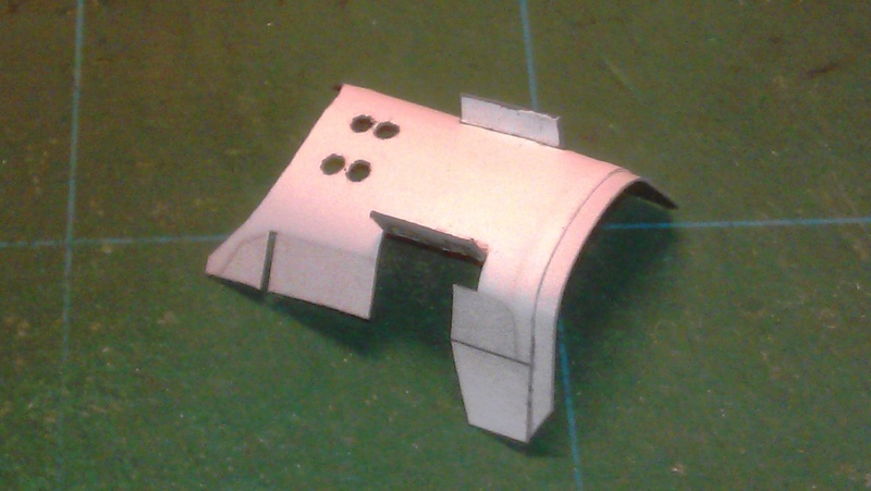

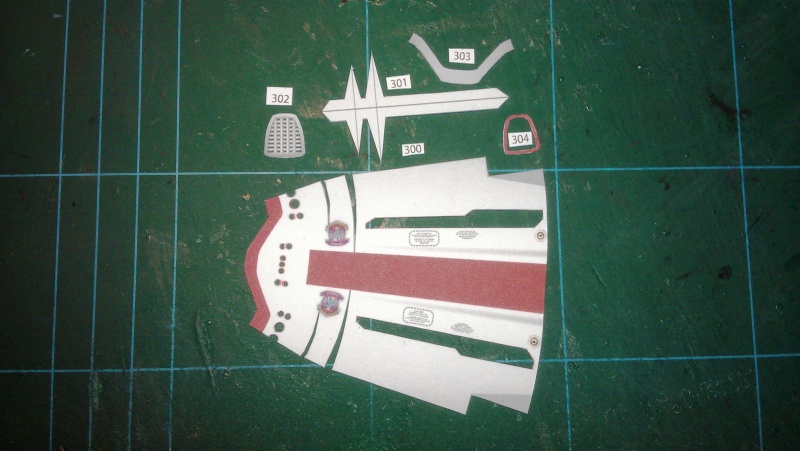

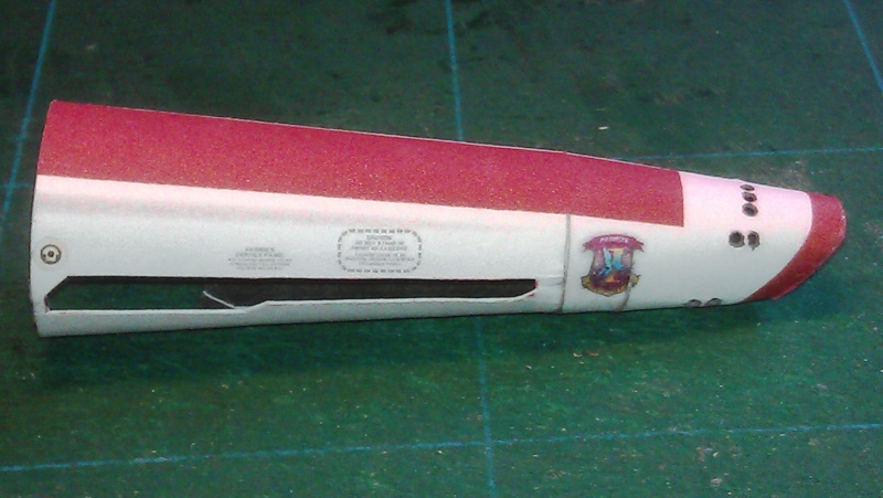

Here are the parts of the nose skin.

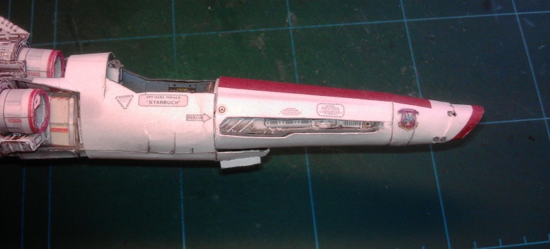

Then nose skin is assembled.
The nose skin is in place. As you can see, there is a bit of a gap (this is caused by the thicker card that I am using).

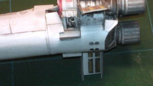

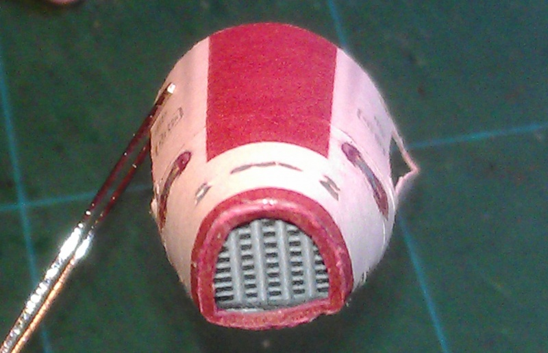

Here are the parts for the lower engine section cowling.
Lower engine cowling assembled
Lower engine cowling in place. As you can see there are caps here as well.
The moral of this story is, If you are suppose to use a certain weight (or thickness) of card-stock for a particular model, DO SO. Otherwise, you will wind up with a model like this.
Oops! Don't worry, everything can be fixed. Just cover up the areas which are not covered by the skin with some paper, re-unfold the skin (= cut it into pieces again), adapt the plans according to your modifications, print the revised version and assemble it. This is what I will be doing if MY skin doesn't fit. Or print the skin on thinner paper. This is the advantage of this kit: If one component doesn't fit you don't have to re-build the rest of the model.
Anyway, the paper weight is of lesser importance because it will ensure that the parts are stable enough to work without reinforcement; it is the THICKNESS of the paper that makes the difference and that causes the fitting issues. UHU spoke of 0.22 mm thick paper; mine is between 0.2 and 0.22 mm thick, so I guess (or hope?) that everything fits on my enlarged version.
RF, Thank you for the advice. The paper that I am using though 0.33mm thick. At 1:50 scale, a 0.11mm variance does make a bit of a difference when things have to fit together properly.

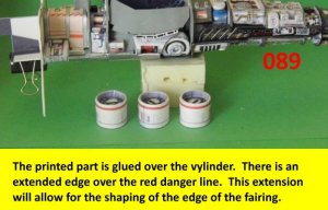

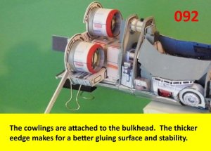

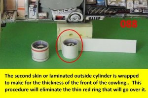

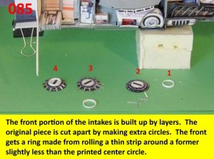

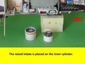

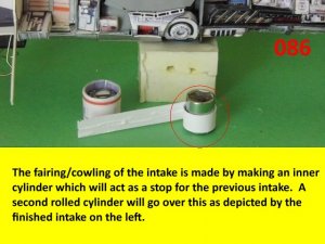

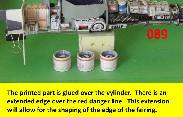

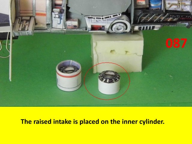

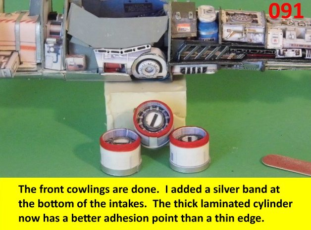

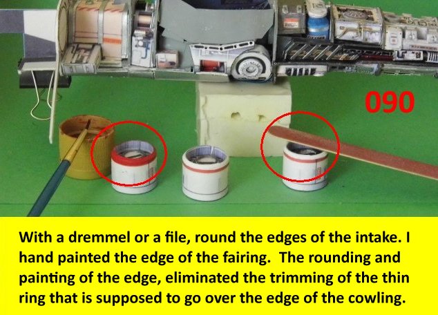

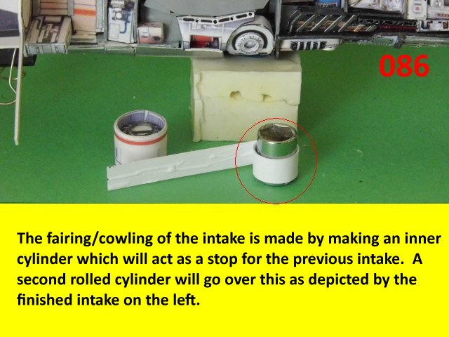

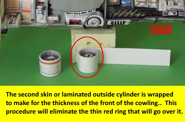

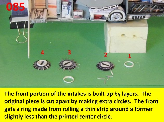

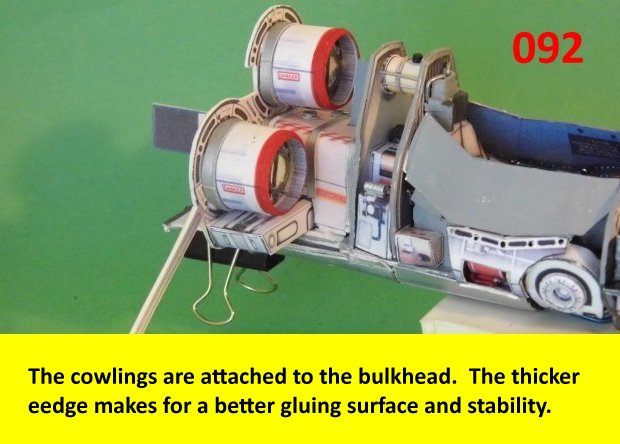

So here I go again with my build of the Viper. The engine portion will be a bit more different but true to the build. i just add more strength to the parts and I do not have to worry about crushing or bending the part while under construction. Most of the parts will receive some kind of added greebles or parts. Enjoy and see you all soon with more stuff.:thumb:

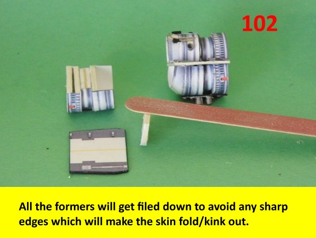

By increasing the size, the viper screams for details.

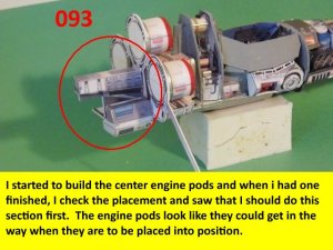

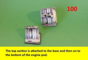

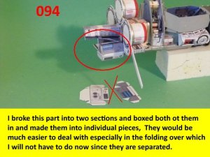

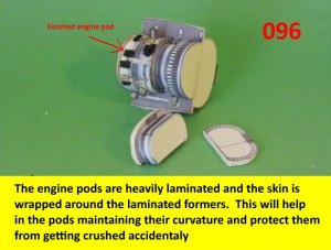

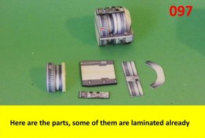

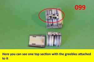

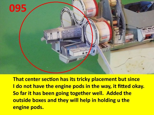

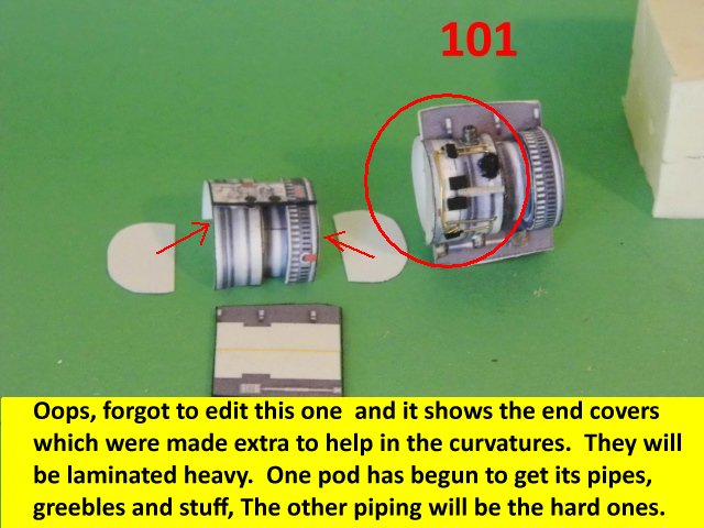

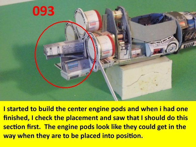

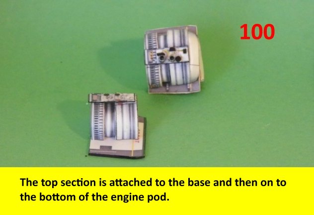

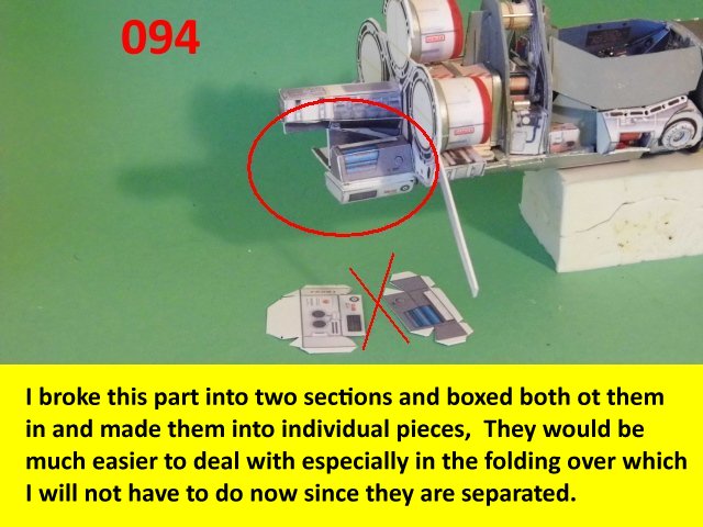

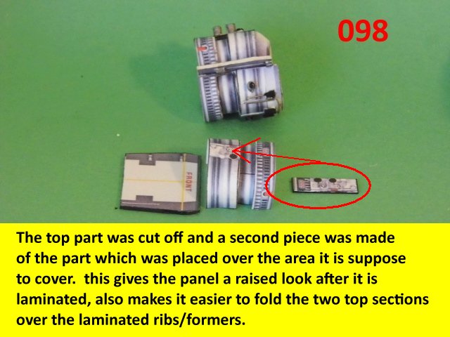

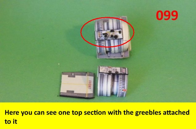

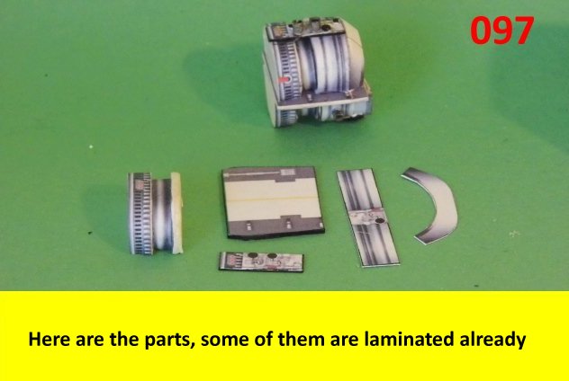

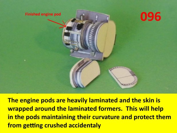

Here are some more updates. As I said before, the engines are slowing me down some because of the added details and my way of construction. So far, so good. See you all with more updates.
By the way, did everyone slow down to let me catch up? I depend on your builds as well, they let me catch bugs ahead of time before I get to them.:thumb:
