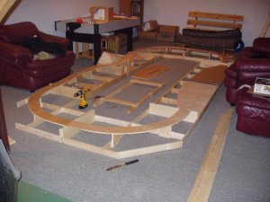

From an old layout, I have a large number of 2 by 4 foot module frames, and these have become the basis of the "Lone Wolf Line", a 15 foot by 7 foot modular On30 layout.
I have until early September of 2005 to get this thing together. My goal is to have a full running circuit of track, with at least one fully scenicked module. If I can pull this off, I'll be at the show.
Progress: October 10th, 2004

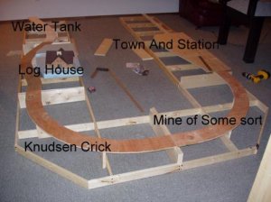

I have built two of the four corner modules I'll need, and combined with the first four straight modules, Here's what we have so far. Planned towns, buildings, scenic elements, etc. are indicated.
The trackplan is really simple. Just a single main line bobbing and weaving through some rugged scenery...lots of rocks, trees, fills, cuts and water. Unlike my home layout, I'll be using Peco On30 track for this one...mostly for tracklaying ease and durability.
As to the corners, they are 36 inches square, and have a curve radius of 30 inches, with 6 inches at each end for joining modules and a (brief) curve transistion. The 30 inch radius should allow me to run any of the up-and-coming K-class locomotives. The town and station area will have a passing track to allow trains to meet. From what I can tell, this passing track could well be up to 6 feet long - more than enough for the short narrow gauge trains I'll be running.

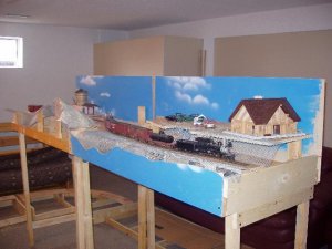

Well, the legs are coming together, and I have roughly put on the backdrop, as well as starting to work on the front fascia...which will not be blue... :p Here's a shot:
