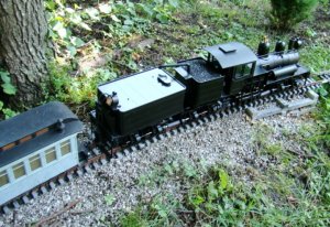

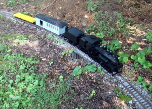

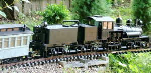

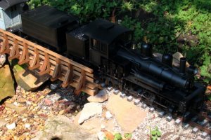

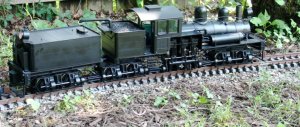

Hi Guys,
After a 6 month wait the Battery/RC/Phoenix sound conversion of my three truck 55 ton Bachmann Shay is complete. It took so long as there were considerable delays in getting the new Phoenix P8 sound system on to the market.
The conversion was done by Don Sweet and Bob Buck of Northeast Remote Control Systems. This new technology has been a great learning session for me. I have learned about NimH batteries , 27 mHZ transmitters, smart battery chargers, and sound cards and sound systems. The Phoenix P8 has a very good sound to it and you can hear a clip at the PHoenix website http://www.phoenixsound.com/library/am_steam.html
The Shay, after a detailed lubrication, runs very smooth and can crawl with individual steam pistons firing at about 1 MPH. I have run a few cars around in the Tennessee woods as the pictures show. I have about 54 feet of completed and ballasted track now with two small bridges and plans for a rather large curved trestle (It will begin at the cribbing in the last photo.).
This is an interesting gauge to model in and the locomotive is quite heavy and robust.
Y'all let me know what you think.
Doc Tom

beautiful!
I love it.
when I come to visit next time, I'll have to bring a tripod, and take a video, so we can hear that sound!
I like the little cribbing,
Bill

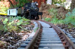

One last picture and come on over Bill.
I love it.
Bill
Hey Bill,
Glad you like the lokie. Here is one last shot of the Shay taken from the "God's eye view." I couldn't get it in the last bunch as Zealot has a 6 pic limit.
Glad to have you come over for a visit and get the backwoods Shay on TV with sound. Let me know when you are free. I am not doing too much this Memorial Day weekend.....except more work in a particular garden that has a train in it.
Doc Tom:wave:

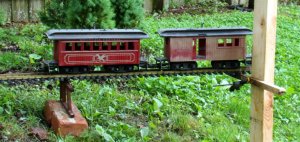

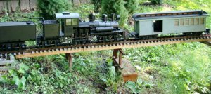

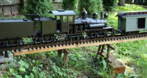

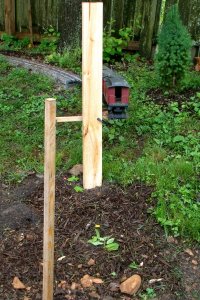

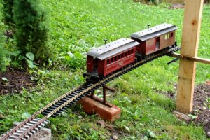

Stringers for the 20 pound locomotive
I started the first work on the curved trestle over Nelson's gap.
First project was to build stringers to match the curve of the track. The stringers are made from Lowe's .7"X.7" "garden stakes" cut to 12 inch (20 feet prototype) lengths with angled ends to make the arc of the curve. There are 1.25" spacers between each stinger.
The pieces are assembled with Titebond III wood glue and small nails placed in pre-drilled holes to avoid wood splitting.
The assembled stringer assembly is sprayed with Thompson's water seal and is attached with fine wire to the brass rails after holes are drilled in the rail web space.
I learned all these tricks from the Internet including the use of garden stake material.
This all made for a very strong structure that was placed on temporary bents and a temporary support post. There is a 1.5% incline to the grade here.
So far it easily supports the approx. 20 pound Shay and the designing engineer is breathing a sigh of relief.:eek::eek::eek::eek::eek:
Let me know what you all think about this RR engineering feat.
Doc Tom:wave:

HOT DAMN *throws hat in air*
you're staring to turn into a regular James P Harriman there Doc
Thanks S Class. Next step is to begin construction of the trestle bents on a jig and hoist them into place with a steam powered crane.
Hope to have the Shay thundering over Nelson's pass within a month or two.
Doc Tom:mrgreen:
