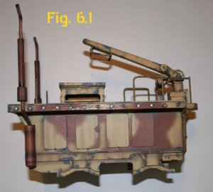

I started with the top, building up the platform and adding the side rails (parts 34b,c, & d). If I were doing it again, I’d leave the side rails off until much later. It’s very difficult to handle the assembly without bending them inward. I ended up re-gluing them late in the project. The base went together easily. I lined the inside walls of the base with black construction paper, since the platform is open at the top, and I have no clue what the inside is supposed to look like. The eight access doors on the sides are all the same size and part number, but for best results, spend a little extra time to match the camouflage patterns on the doors with those on the body. (Fig. 6.1)
The rolling cradle that carries the shells to the breech has no coloring on the inside of its legs. It’s laminated to heavier stock and you’re expected to color that stock to blend in. I photocopied the parts (14-14d) and laminated the photocopies to the backside of the kit parts. The color match isn’t perfect but it’s very close and good enough.
The instructions call for laminating the rolling table (part 14d) to heavier stock, then folding it. I was afraid that fold would be difficult so I cut the sides from the top, and glued the sidepieces to the underside of the top. I had to bend the legs out a little to get the wheels to ride on their tracks but it looks fine. In retrospect, I should have glued the top between the sides. That might have required trimming the top a bit to make the wheels fit the rails. Live and learn.
The plans show railings and posts (parts s7, s8, & s9) to be made of wire(?). I made them out of 1/16” Evergreen plastic rod. For the curved corners on s7, I carefully bent the rod with a jeweler’s pliers, and then took the tension out of the bend by passing the piece carefully about an inch over a candle flame. (It took a couple of tries, and a couple of pieces of rod, to get it right.) I tapered the ends of the railings and posts with a flat file, and painted them with Testor's Model Master paints (2099-Afrika Grunbraun and 1723-Gunship Grey). I made divots in the platform with a 1/16” drill bit in a pin vise, and super-glued the railings and posts in place.

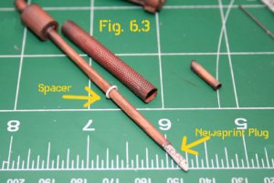

The subassembly I worried most about was the two exhaust stacks. Built up from paper tubes with 45° bends, they looked too fragile. As it turned out, they went together well and are sturdy enough. I started by rolling all the parts. With small tubes like the exhaust pipes, I roll them tight on a piece of wire, and then use a toothpick or paintbrush handle to open up the tube. Rolling it tighter than the finished part will be, makes it easier to handle.

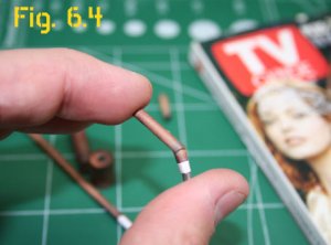

Long tubes, like the long exhaust column, are always a challenge. (Maybe the ship modelers have some advice here.) I rolled this piece first around a 1/8” dowel, then around a smaller dowel, then around wire. I used a toothpick to tease it out to something like its finished shape and then I started at one end, gluing about ¼” at a time, and using a piece of the 16” rod as a backing for pressing the seam tight. The best advice I can give is: Be patient and work slowly. Rolling and gluing that one piece took somewhere between five and ten minutes, and the result was worth the time spent.
According to the instruction drawings, the angled joints in the exhaust pipe are simply butted together. To make them stronger, I rolled a piece of newsprint around 1/32” wire and stuck one end in the bottom piece of the pipe. In Fig. 6.3, you can see the newspaper plug sticking out the top of the long piece of pipe. Then I slid the next part over the newsprint plug, aligned the two pieces, and touched the joint with brush-on superglue.
I used Elmer's Brush-On "CrazyGlue." This stuff wicks into every crack, sets up fast, and dries flat (if you don't lay it on too thick). In about ten seconds, I had a good, strong, fairly rigid joint. (Fig. 6.4) I worked my way up the pipe, checking angles and alignment as I went. The newsprint plugs should be rolled loosely, so they can bend without flattening too much.
The white ring around the pipe in Fig. 6.3 is a spacer/collar I made with my leather punch, to keep the shroud properly aligned with the pipe. With the largest punch, I punched halfway through a piece of 1mm cardstock. I switched to a smaller punch, centered it in the circle I'd just made, and punched all the way through. Then I went back to the large punch and punched out the "donut." (Getting a nice, even donut took several tries.)
Newsprint is also very handy for repairs. If you cut something you didn’t want to cut (as I did when my steel straightedge slipped), glue a scrap of newsprint to the back of the cut to splice it back together. That creates a strong joint while adding very little thickness. I keep an old copy of TV Guide at the workbench, to supply all the newsprint I might need. (Choose one with a cover you like looking at; it will last you for about a gazillion years.)

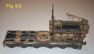

Fig. 6.5 shows the loading platform sitting on its railcar. I'm not going to glue it down; I want to be able break the finished model into subasseblies for transporting it to shows. I’ll add the crane’s cable and grapple and the artillery shells later on.

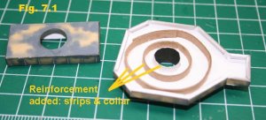

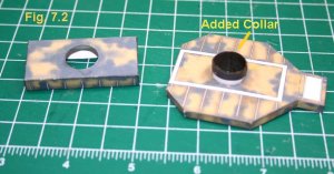

I reinforced the receiver with strips of heavy card and collars wrapped around the tube that forms the socket. See Figs. 7.1 and 7.2. Since I intend to haul this model around to shows, I wanted the receiver to be good and sturdy.

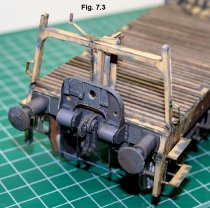

This car end has a brake pedestal and hand rail. See Fig. 7.3. (Isn't it amazing how the camera brings out all the little edges you thought you'd colored?) The hand rail looked delicate on paper. I reinforced it with some stripwood (basswood) glued inside the posts and crossbar.

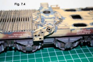

Fig. 7.4 shows the center of the car with the receiver pedestal and the associated mechanicals. I have no idea what they do but they look neat. That dark stain on the chain(?) housing happened when I was coloring the cut edge of the hole with a too-wet felt tip pen. It bled. Now I call it a grease stain from the machinery. Think, "Superdetailing."
Fig. 7.4 also shows the modification I made to the steps, narrowing them to 5mm and staggering them, so the bottom one clears my custom-made brake hangers.

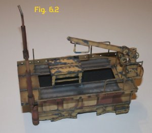

A Note on the Gunloading Hoist
Back in Post #6, I described building the gunloading platform. I've added the following note to Post #6 but I'm posting it here, too, so nobody misses it.
Take a look at Fig. 6.1 (attached here) and notice the angle of the hoist arm. With a shell hanging in the hoist, it's too low to position the table under the hoist. (I discovered this later, when I added the two cannon shells--one to the table, one to the hoist.)
There's nothing inherently wrong with this but if I were going to do it again, I'd angle hoist about an inch higher off the deck.That would allow the table to be positioned at the gun breech, under the hoist, or anywhere in between.
I glued the hoist together pretty well. I'm not sure I can change the angle without seriously messing it up. On the other hand...what's life without challenges?

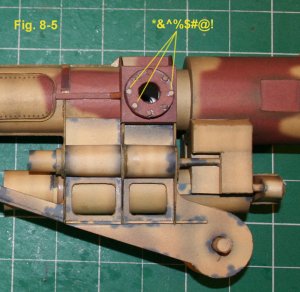

Figure 8-5 shows a minor problem I've run into. The kit includes a lot of bolt heads to be cut from 1mm card. That's fine except that, with handling, the 1mm card de-laminates. leaving me with 0.5mm-thick bolt heads the color of cardboard. I say, "with handling." Sometimes they come apart even before I've glued them to the model. I haven't worked out a solution yet. Maybe the tank modelers out there--who deal with bolts and rivets more often than I do--have some ideas.
