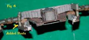

I've started with one of the two rail cars--specially-built flat cars--that carry the cannon. The first step is to assemble the leaf springs. Choose your card thickness carefully here and do some test fitting and experimenting. Part 1c is the vertical band that fits over each spring. It should reach just to the bottom of the leaf spring. If it doesn't, your springs are too thick. I'm not sure what thickness card I used and I don't have a way to accurately measure it, so you'll have to work it out by experimenting.

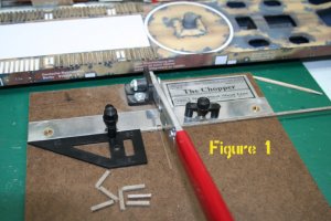

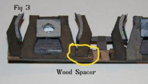

The two side frames (Fig 1) go together fairly easily. You'll need extra-heavy card for the side frames and brake frames, and for the car body when you get that far. Picture framing matte board seems to be about right--somewhere around 1.5 mm or a little less than a 1/16" thick. (See below: A Note about Heavy Card.") The first side frame took me about a week of evenings. The second is going a bit faster. They're big; that's a six-inch ruler. I made a few modifications:

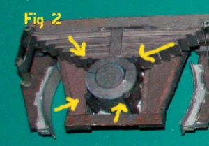

Four bolts secure each of the wheel bearing cases. The ones supplied in the kit (parts 1k) are too short. They should be as tall as the side of the bearing case. Scan a strip of 12 parts 1k, enlarge them to 190%, and print them on good quality inkjet paper or matte photo paper (20-24 lb). Then roll them and attach them according to the instructions. (Fig 2)
The kit instructions show the brake brackets (parts 2aP & 2aL) attaching directly to the back of the side frame. But if you mount them that way, they won't line up with the wheel treads--they'll be too far outboard. I made spacer blocks from 1/8-inch thick basswood. (Fig 3) Then I built up one wheel and axle and used that as a guide to position the brake brackets.
With the brakes positioned farther inboard, you'll have to add extra posts to the brake pivots (see Fig 4). I don't have any good photos, drawings, or models of a 1940s European rail bogie, but this looks about right and it makes sense. If you have better information on what this prototype assembly SHOULD look like, please post it here.

The ideal card stock for the laminated parts marked "**" seems to be about 1.3-1.5 mm thick. I built the first rail car with a sheet of heavy (about 1.4 mm) card I bought from Lighthouse Model Art. I think Ralf got it from Fly Model. (Lighthouse is, sad to say, no longer in busiess. We miss you, Ralf.) For the underframe on the second rail car, I used picture matte board and found it just a hair thicker but much more dense and much harder to work with. For the rest of the kit, I'll snitch heavy card from some of my unbuilt Fly Model kits. For those kits, I can substitute scrap and scrounged material (for fuselage formers and wing spars). Live and learn.

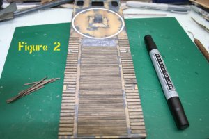

There is some wood decking on each railcar. The kit provides paper parts--a LOT of paper parts--for the wood. I do a lot of scratchbuilding for my model railroad and I've always believed that nothing else looks as much like wood, as wood. I used HO-scale dimensional lumber for the decking--6"x8" for the short blocks on each side (parts 25), and 2"x8" for the planking in the middle (part 24b). I applied the planking directly to the deck after coloring the white area under the planking with a gray watercolor marker, in case there were any gaps between the planks.
I stained the wood using a "weathering goop" of shoe dye mixed with rubbing alcohol. (I'm not sure of the ratio--I mix it myself in several different strengths.) Wood stain and alcohol works, too. I cut the wood on a Northwest Shortline "Chopper," (Fig 1) stained the cut ends, and glued the blocks and planking down with tacky glue. You can see the results in Fig 2.

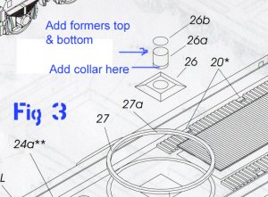

The round post in the middle of the flat car (parts 26a and 26b) has no reinforcement--it's just a tube with a paper cap (Fig 3). It could get some abuse if I haul the model around to shows, so I laminated the top cap to 1mm card and made a 1mm former for the bottom of the tube. There is a printed ring around the bottom end of the tube that lines up with the edge of the base (part 26). I used a strip of scrap to create a collar around the base of the tube to support the top of part 26, glued the tube into the base, then glued the whole assembly down. The whole assembly is much sturdier this way.

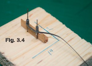

Post #3: Brake Hangers Revisited

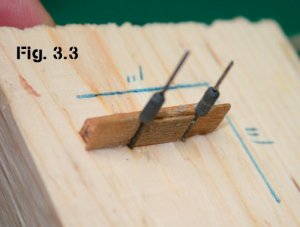

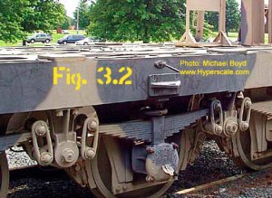

When I first looked at the brake hangers (Parts 1, 1a, & 1b), I didn’t especially like what I saw: a bunch of tiny parts that would require a lot of very fussy labor. So I cut a corner. I used the posts (Part 1), tossed the caps (Part 1a), and made my own straps (replacing Part 1b). See Figure 3.1. As I noted in an earlier entry, I didn’t know what these looked like on the prototype, and they looked about right to me on the workbench.
Then CharlieC’s post to this thread led me to some very good prototype photos (Fig. 3.2), and I knew I had to do better. I still didn’t like the kit parts. I found some dark brownish-gray paper in my daughters' craft cabinet, and tinted it with a watercolor marker to get a close match with the kit parts. Then I built a jig using a small pine block for a base, two pieces of piano wire (superglued into the wood), and basswood scrap for spacers. (Fig 3.3). I cut long strips of my tinted paper the same width as the height of the posts, and used my NWSL “Chopper” to cut them to length (after experimenting to determine the right length). Then I rolled the posts on another piece of wire and slid them onto the wires on the jig.
I cut another long strip for the bands and glued one end to the base of one post, (Fig. 3.4), then wrapped it twice around both posts, gluing as I went (Fig. 3.5) and trimming to length on the jig.
[Continued on the next post]

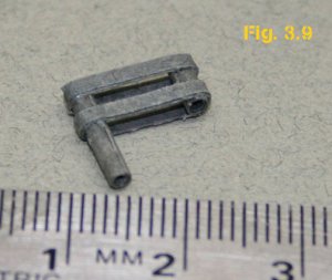

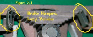

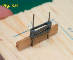

Construction Post #3 - Continued

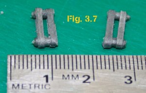

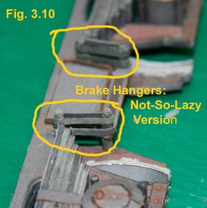

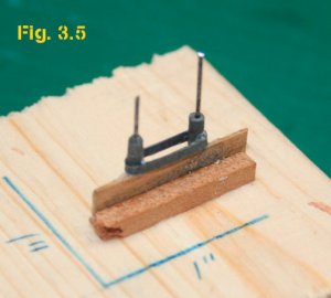

I attached the second band the same way (Fig. 3.6), gave the glue a few minutes to set up, and carefully slid the assembly off the jig (Fig. 3.7). Once I got the hang of it, the process of building a dozen of these little rascals went pretty quickly.
The posts look like they have nuts on their ends. That's a happy accident that comes from the fact that my fingers are too fat to roll these small parts perfectly straight. Clumsiness can sometimes pass for talent when everything turns out right.
Earlier, (see Post #1) I recessed the brake shoes, so they would line up with the tires. As a result, each of the two brake hangers at each end of the side frame needs one longer post. The prototype photos don’t show this detail, so it’s a SWAG* on my part, but it will probably be hidden behind other sideframe details, anyway. So it goes.

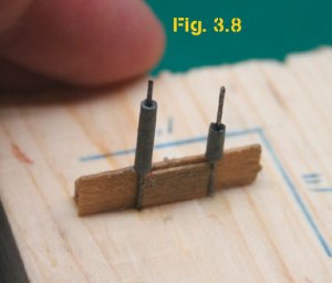

I measured to find the length of the long post, cut strips from the tinted paper, and rolled the posts. I used the same jig (Fig.3.8 ) and assembled the hangers the same way (Fig 3.9). You can see the results in Fig 3.10.
When I build the car at the other end of the gun, I’ll probably make the brake hangar straps about half as wide as I did here. On the prototype, they look more, well, “delicate” isn’t the right word, but you can see for yourself.
What about the Lazy Version of the brake hangers on the first sideframe I built (Fig. 3.1)? I haven’t replaced them—yet. For now, they are on what will be, from most viewers' perspective, the back side of the model. If they seem too conspicuous later on, I’ll replace them.

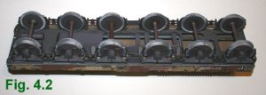

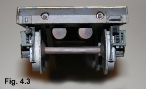

Construction Post #4: Wheels
There are twelve wheels and each one has 3 disks. I got dizzy cutting them all out. (Put the wheel on the jig, grab the curved scissors, and walk around the jig, cutting as you go.)
Right.
I cut out and assembled the wheels, rolled the axles, and stuck the former loosely onto the latter.
I glued one sideframe (a) to the body and left that overnight to cure. The wood spacer blocks for the brake shoes were mounted level with the tops of the sideframes and really helped square everything up here.
The next evening I stuck the axles/wheels into sideframe a, stuck the other ends into sideframe b, and carefully glued down the second side frame. I gave that about an hour to cure, then slid each wheel into position and glued it to its axle and to the back of its bearing case.
A purist might say, "But the wheels can't roll." Well, I don't really want this monster rolling away from me, and gluing the wheels, axles, and sideframes together makes for a much sturdier assembly all around.
Each axle has a tapered collar (part 5a) that fits against the back of each wheel. I installed these collars only on the axles on each end of the car, where they can be seen. I see no point in spending time adding details that no one will ever see. You'd need a mirror, a flashlight, and an attitude to see those inside axles and their missing parts.
You can see the results in the photos. It's big--about 375 mm long. (That's a couple hairs short of 15 inches.) Fig. 4.3 is of the inside end of the car (no coupler). The two round things above the axle are the ends of two air tanks. Note the different brake hangars and the correct alignment of the brake shoes on the right side. I think I'm going to have to replace those Lazy Version Brake Hangers after all--eventually.

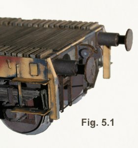

#5 Car End Details

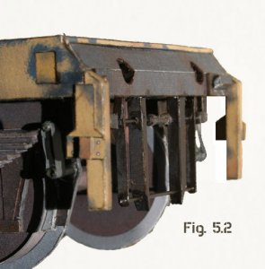

A couple of evenings finished off the car ends. This is where I learned about unintended consequences.
The wood spacer blocks and repositioned brake frames (see Post #1) interfere with the framework that hangs down below the end beam of the car. I solved that by leaving off the outer parts of that assembly (7P/L & 7G). No one will miss the detail.
The frames on both ends use heavy piano wire for horizontal braces. I painted those after assembly with Model Master "Burnt Umber," which looks like a slightly rustier version of the kit's underframe color. There might be a better match, but this was what I had on hand and it looks good.
The other unintended consequence has more to do with my impatience. As I described earlier, I mounted one side-frame assembly to the car body and let that assembly aside to cure overnight. The next evening, I mounted the wheels, axles, and second side-frame, let them cure a half hour or so, and then spent a lot of time handling the car as I photographed it. One result is that the second frame is canted inward just a bit on the coupler end of the car. It's not obvious but it's annoying and it was avoidable. I'll fix it later; I've got a deadline to meet--an IPMS meeting this week.
Back to the endframe details: I added internal formers (disks) to the buffers (those piston-like things on the corners of the car--parts 14-14f) to make them stronger. I cut the side steps about a 3/8" narrower to stagger them a bit and to ensure that the bottom step would clear the brake hangers. I put the steps and frames together, mounted the assembly onto the sideframes, and painted the step hangers liberally with brush-on super glue. The glue I'm using dries flat and makes the steps strong and rigid.
Next up is the gun loading platform that fits onto this car.
