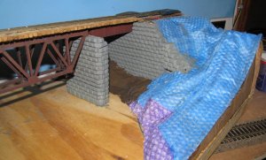

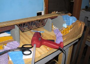

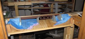

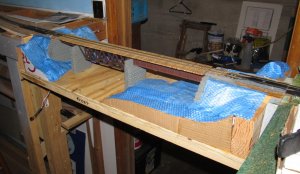

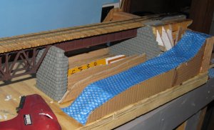

I carried my hot glue gun, and a pair of bandage scissors to the club. I used hot glue to glue store brand handi-wipe knockoffs to the cardboard land forms I had made previously. I used to use white glue to fasten the handi-wipes to the cardboard forms but this is a lot faster, as I don't have to wait for the white glue to dry before I can proceed. Along the riverbank I will carve some rocks and mud banks in plaster. everywhere else, the next step will be to paint the handi-wipes with acrylic paint. I'll use a brown color. before adding ground cover on top of that. that way if there is a hole in the ground cover somewhere, brown, and not blue, will show through.
In the bad old days, I'd have used paper towels dipped in plaster to do these land forms, and it would have made a big mess. this is neater, and gets just as good, or beter results. this is a process that I have developed largely o my own, but with consultation, inspiration and commentary from DR TOM. I call this method glue shell, although that is less appropriate
, now that I'm not painting it all with white glue.

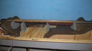

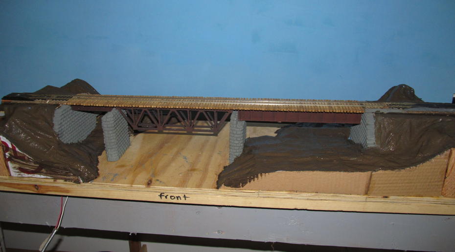

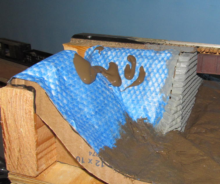

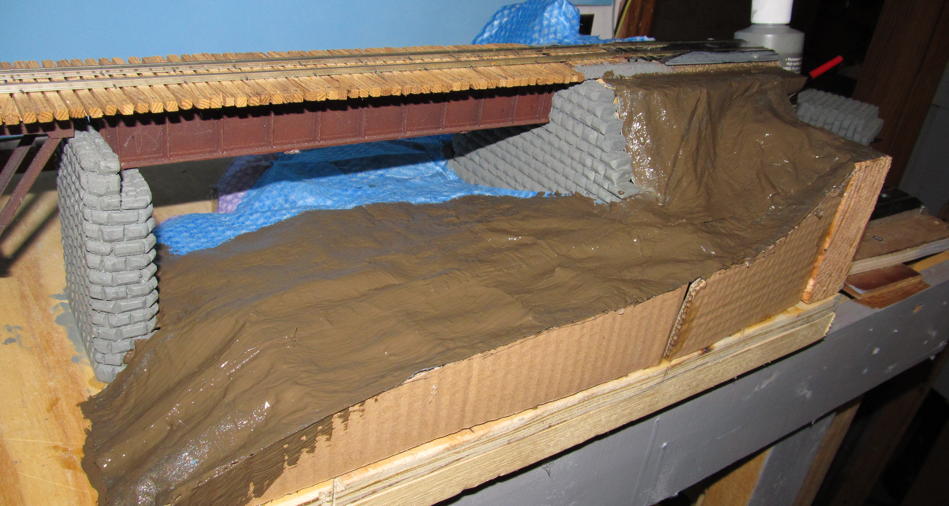

at the club tonight I started painting the handi-wipes on the glue shell scenery with raw umber artist's acrylic paint from a tube. this stuff is way thicker than what comes in the tubes from the craft store.
this is looking a lot better . the paint won't be as glossy when it dries.

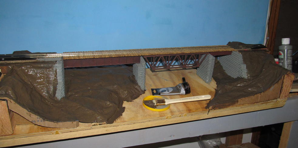

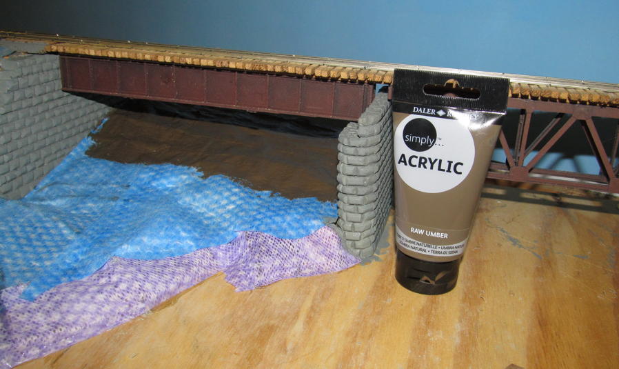

this is what the tube of paint looks like. In the photo below, you can see it is a lot thicker than craft store paint, so you can fill holes with it, and it will contribute to the strength of the scenery. you can also see a profile board, that helps support the hand-wipe surface.

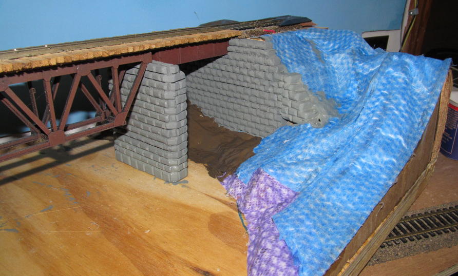

here is the front side of the lift out, ans it currently stands.
and the back side, which would be visible from the tool room. next I can start to build up some fine detail along the water's edge, and start putting in ground cover.
This will be a fun spot on the club layout. the layout is too flat, with most of the layout built flat on plywood with no scenery below the grade. When designing the new layout, They would not listen to Tom and I when it came to building benchwork to support superior scenery. one member got really ugly about it saying "I've seen 200 videos on you tube about building layouts, you don't know what you are talking about. so I have two small removeable sections of RR to do right; and the rest of it is just going to have to be mediocre, because that is what they insisted upon.

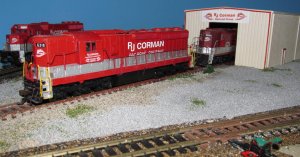

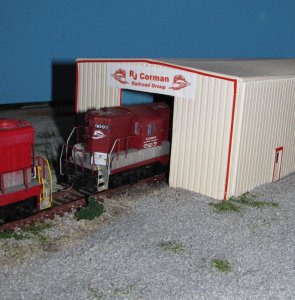

Here are some shots of the RJ Corman Guthrie KY. engine house that tom has been working on. the RJ Corman locomotives belong to other club members. Decals are available commercially, and I have two sets, waiting till I can find a pair of GP9s with dynamic brake blisters available chap enough for me to convert to DCC and sound, or roasonably priced sound GP 9's . The L&N was running GP 9s on this stub end of the old Memphis line before they sold to R. J. Corman. and Corman ran GP 9s for the first few years. now they are running mainly GP 35s, if my diesel locomotive identification skills are correct, which is doubtful.
In this first photo , the locomotive mostly in the shed's paint is a tad too dark, and the one in front is a tad light. but they are both beter than mine that don't exist yet!
