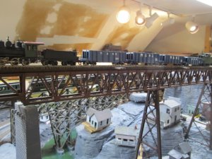

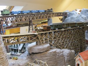

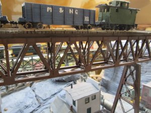

One of my HOn3 Tweetsie hoppers. I built the two O scale cars, as my plans were in O scale, and I wanted to get a good understanding of the car before simplifying it for HOn3. I built four, and have the wood cut for another four. I may use some of the parts to make a mould for cranking them out in Resin
the four ore cars going up the gizzard high bridge, with a caboose cut down from one of thse ubiquitous HO bobber cabeese
I really like this little 2-6-0 modifies from a PFM C&S unit. I removed the bear trap spark arrestor to de Coloradoize it.

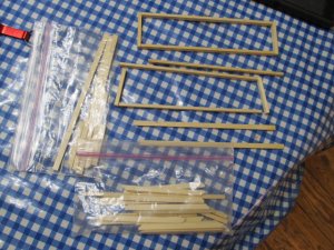

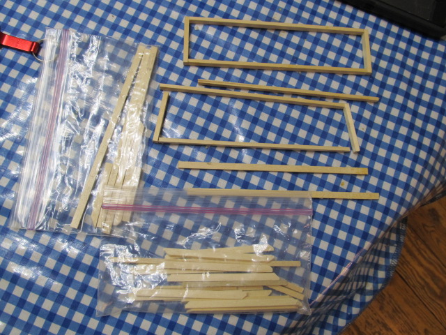

Looking for something else, I puound my pattern pieces for the Tweetsie ore car. these will come in handy determining the sizw of wood needed for the underframes of my Russian River kits
