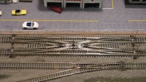

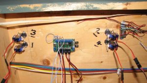

I was handed a set of switch machine servo's by an agent of a new product. He asked me if I would like to install them into my N Scale layout and test them.
The name of the product is "ANE model".
I installed the four servo's under the switch points of my Shinohara Sissors Crossover and now have them fully operational.

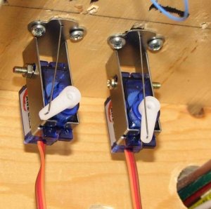

The size of these machines are only one third of the size of a tortoise machine which makes them very useful in small tight spaces under the layout. The servo's come with a small circuit board that allows several adjustments which I found very useful.
One of the adjustments is to choose the distance that the throw wire goes and to also throw more to one side than the other, if required.
The installation was fairly easy as you don't have to be as precise in centering like you do with the tortoise, this is due to the adjustment board mentioned.
The 4 servo's come with all the connecting wires (in different lengths) with attached plugs to lash them together. I found them very useful for the crossover.
At first, I had a little problem with the positioning of the Horns (they push and pull the throw wire) but I changed the position from the one recomended in the instuctions as the wire was being pulled down and out of the turnout during the swing of the horns.
I believe the manufacturers of the product may change the instuctions but this problem may not happen on HO turnouts.
I hooked up the 4 turnouts into two pairs, each pair linked to a toggle switch.
I am quite impressed with these little machines and they are working together very nicely. I am sure that I will be looking for more to install into my layout.
There are other operations that can be done such as power routing but I have not ventured there yet.

I took a few photos of the installation of the turnout servo's.
Dennis

On the other hand, what I'm not 100% crazy about is the mounting options. It seems you'd have to mount it horizontally (see pic) to keep the throw rod from slipping out of the turnout hole (vertically mounted the arm swings in a downward circular motion. Think clock pendulum). But mounting horizontally requires all kinds of twists and turns of the throw wire, hole carving under the turnout to hide and give the wire throw room to swing, etc... Just sounds like a pain to mount when you have 20-30 of them to do.

As far as mounting the servos and the problem of wires falling out, If you simply make a loop in the wire so it goes through the throw bar and loops around the bar, it won't fall out. As far as the throw bar in the track switch goes, just put a small "eye" bolt screwed into the bottom of your layout and run the wire through the eye.

There are three ways of mounting them: One is to mount them directly under the turnout as in the photograph or if the turnouts are already mounted and: Two you have forgotten to drill the hole underneath then you can drill a small hole a short distance from the tiebar and then make a crank shaped drive wire to drive them and: Three you can mount them on top of the board inside a building or a mountain and then run the wire straight across to the tie bar.
If you are using N scale then you just adjust the length of throw of the Micro servo using the buttons on the motherboard. You are also able to adjust the one of nine speed settings from 20 seconds to .07 seconds.
