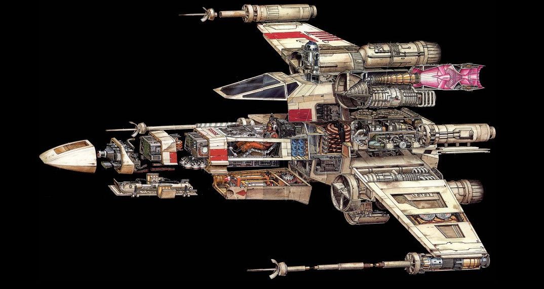

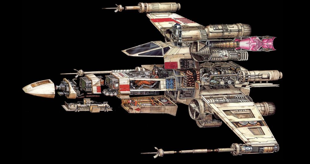

Haven't seen an UHU model built in a while. I'm sure a new standard will be set. UHU has quite an imagination when it comes to the insides of these models, then again, who the heck knows like the "Sci-Fi" creations would look in reality. I found a picture a while ago, it's below.

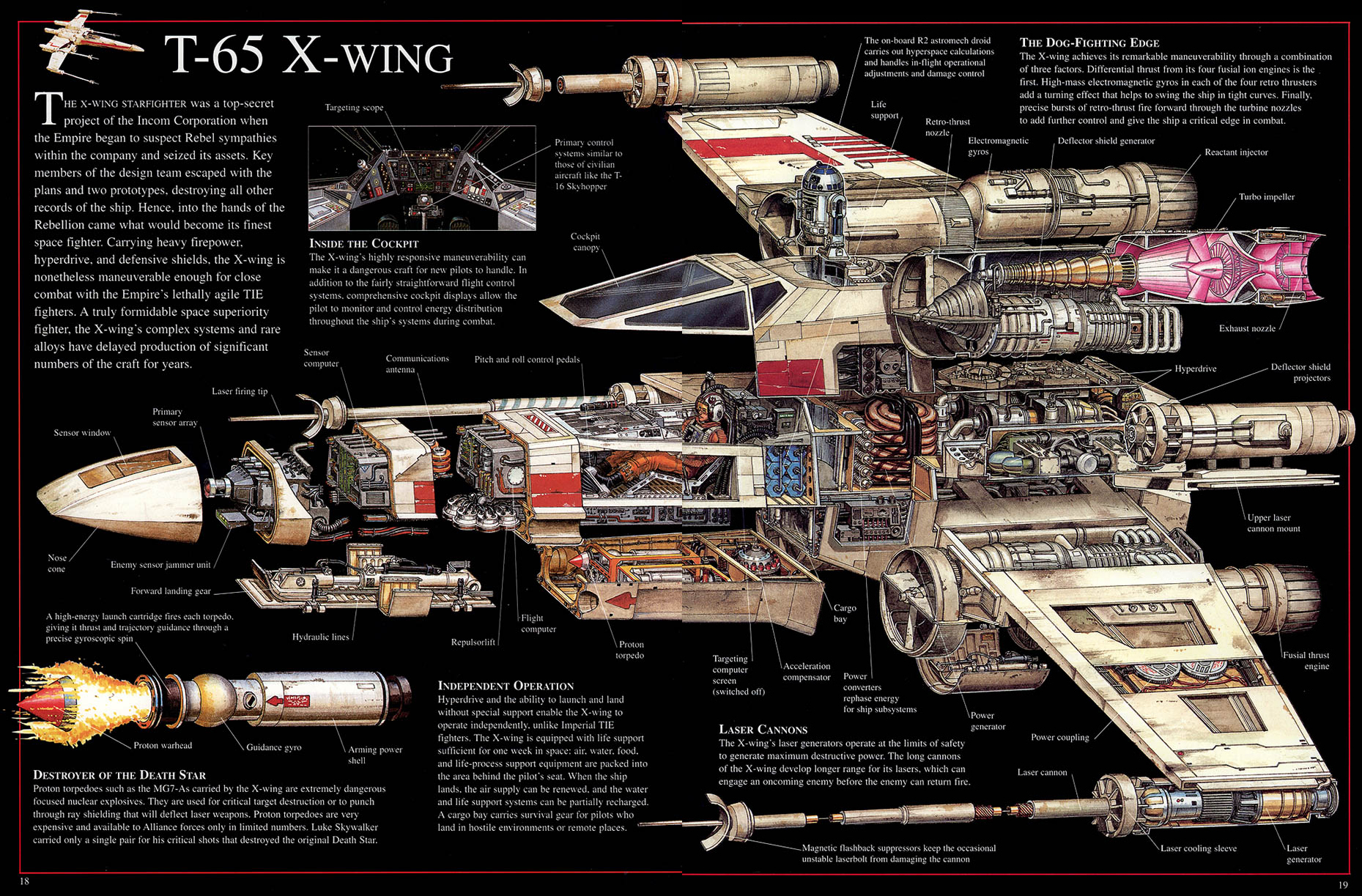

That's exactly the picture I found and saved in favorites for reference. Mine also has names and explanations to various internal systems that shown here
