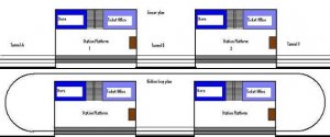

I drew up a really quick schematic of this idea--hopefully it is fairly self-explanatory.
Here's the diagram...

The one with the 6" curves would be more or less ideal, but somehow I think the trains won't agree. The solution to get them turn anyways, would be to have some guiding rails on the outside of the curve which would physically prevent the train from derailing (It's hidden from sight, so that wouldn't be a problem, but whether it works is the question. Also there might be paint chipping off the corners after a while...) From a practical point of view - can flexible track usually be bent to such extremes, or will the track have to be scratchbuilt? And what about building the curve at a slight angle to redirect some of the centrifugal forces down?
An idea I had was to have the two station layout with double track stations with the 'wings' connecting the two tracks so that the trains could always depart in the same direction and when returning not reversing. I'm afraid for two stations this will be too large. With the aforementioned 6" turns all these operations might be moved to a shadow station beyond the turn - for a full 'wing', including a turnout, I'd need about 18" of space. Reducing this to the 6" of the turn, would enable longer stations and a longer tunnel B.

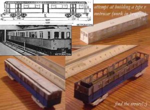

Not sure if this is the sort of car you're thinking of making, but it shouldn't be too hard to bash from a Japanese transit car or even a Western heavyweight passenger car with a few side doors. There is enough clearance on the trucks to allow for fairly sharp curves--with few things in the way for the trucks to bump on, they can swing farther to make sharper curves.

jetrock - that's exactly the sort of car I'm making, in fact, as the drawing you posted was the only blueprint I could find, I based my first attempt on that one - once I get the details done and painted I'll post some pictures. Cheated a bit on the round forms at the ends, but then, this is my first N scale modeling attempt. For better models, it'd be useful to have better drawings than this, as now some measurements were guesstimated based on this drawing and photographs. If anyone happens to know a good source, I'd be very happy to hear.

A first picture...
Trucks will be redone, some lights will be added (probably not working), roof will be painted. A few little details here and there. If you compare the model with the photos and the drawing you'll spot some errors, but I can live with them, as long as I keep telling myself this is just an exercise.

Apart from the wheels - 1mm, 0,5mm, 0,25mm styrene and 0,5mm transparent sheet.
The main problem with sheet styrene are round surfaces which many engineers of rolling stock seem to be fond of (just the subtle, irregular round forms, which I for convenience's sake, left out of this model)
And as for the construction process, it's just a matter of cutting and stacking the parts onto the floor of the car..would love to get my hands on some better drawings (the one included on the collage is the one I used)
