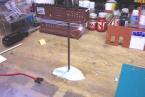

Remembering someone mentioned North American telephone poles with streetlights in the "What Detail Parts Would You Like To See" thread, I thought I would try to scratchbuild one. Here's my first attempt.

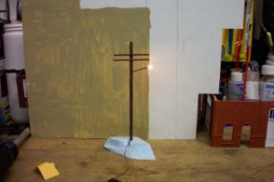

Here's another one, on my test transformer, all lit up.

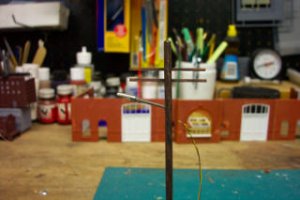

I started with an HO scale lamp from Life Like, but it was big and looked out of scale, so I opted for the N scale one instead.
Its an Evergreen Plastics tube, capped at one end, and a hole drilled in one side for the light. The wires run down the inside of the tube. I will drill a hole in the layout to "plant" the pole and pass the wires down through.
Won't even see them.

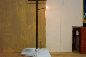

That was me! Those are looking good Ed. Do you perhaps have a photo where there's not so much in the background? I'm finding it a little hard to see the lamp.....

They are actually the arms that I cut off of N scale street lamps.
I was gonna post a step by step, I have taken pics of each step...But I changed my mind...because I used the HO lamp and it looked funny.

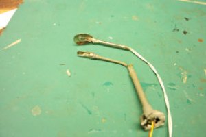

That's very cool Ed. My original mistaken thought about just using the wires for a support arm has given me an idea though. The kind of streetlights I want to have, feature a gracefully curved arm, and now I think I know how to achieve this:
1. pull the wires from the straight tubing
2. cut a piece of very thin copper or brass rod to the length you want the arm to be
3. Line it up with the wires
4. Apply some of that heat-shrink insulattion to hold the wire and the rod together
5. Bend the rod to the desired curve.
I think this might just work. Here's a pic showing what I mean. It's pretty small but it's the only one I have without a cluttered background.
cheers
Val
