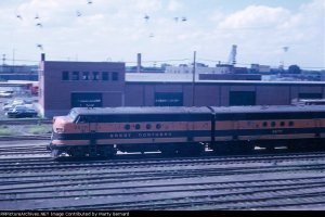

The F/T units when new on some roads had the "side lites" so the Stewart units are prototypical. Look closely at the B unit

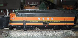

For anyone that hasn't seen the light side unit.
I took this picture and hope that I upload it correctly.
Kent
