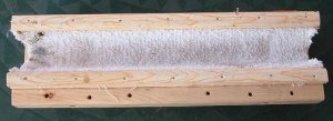

I need some help here guys----just got my 4-8-4 Santa Fe tonight. It runs great, 22" radius curves, AC, no DCC yet. There is a slight muted clicking, I believe from the rear engine truck. There seems to be an excessive amount of side to side movement of the truck frame. The wheels have just a very slight bit of movement from side to side [normal], while sitting on the track. The truck also sits cockeyed in relation to the line thru the curve. When working on a steam engine, to remove a truck to check it, how should the engine be supported? Upside down on soft foam rubber? On it's side? I'm just wanting to be careful so as not to bend handrails etc. Fair amount of hand applied details on this. It's from the new Bachman Spectrum series. Thanks for any help you can give.----John R
I built a cradle from scrap 1x4 and an old towel. Works like a champ for me. Those holes are for my miniature screwdrivers.

Spurgeon, Thanks for the input, that looks like that would work. Well, I pulled the rear truck and that was not what is making the noise and it isn't the tender, so I'm afraid its a burr or something in the internal gearing---Can't believe it, I waited almost two months to get it and now a problem. Do I send it back to Historic rail for exchange or to Bachman for repair or replacement? First time Iv'e had a problem with an engine. I guess I'll go back to pulling the pass. cars with the 2-10-2 Santa Fe --------John R
