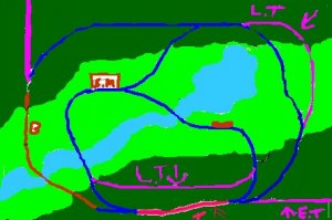

to post yet again, but i thought id share my plans with you, i just hope this uploads. its pretty simple. there will be a valley with hills to each side and a river flowwing through it. The blue lines are the rails, the black lines are the roads. The town is beside the lake and will eventually grow and spread out as more money becomes available. This plan is 9ft wide and 6ft deep. My main focus to start will be getting the wiring done (probably going to need lots of help with this stage, getting the terrain formed, laying track, and setting up my little industries (coal and logging).
Now ive got a question that i thought about today, im purchasing this pretty much all from the internet and will be getting the products shipped from the states. Ive got experience doing this with guitars and watches so i know the whole customs and tax etc stuff. But my problem is with the power pack. If i buy a power pack from the US and just get a voltage converter it will work fine won't it?
so without further ado heres the plan, any suggestions welcome,
im an adventurous person so have decided to jump right in at the deep end with regards creating tunnels, water, gradients, bridges etc. I have lots of experience working with LEGO (i even have the LEGO train) so hopefully that will help a bit.

Hi Conor - if you are not in the USA and use a different voltage where are you???
I am in the UK where we use 230V so I buy all my mains powered stuff here to aviod all the problems with voltage. What voltage do you run at? I would assume something near 240V at 60Hz. The 115V stuff runs on 50Hz so the voltage converters don't work perfectly. It is adequate but costs more than just getting one locally. Alternatively you can build a power pack quite easily and a lot more cheaply. A friend of mine did it last week. I can get the parts list and circuit diagram if you want - it is not too hard.
The plan looks good to me but you have to be able to reach all the track so can you walk all the way around it? If so would the space be better used as a "walk in" layout where the trains go around the sides of the room and you stand in the middle looking out? You could have a penninsula sticking into the middle of the room if you wanted.

About your track plan--Unless you have the arms of an orangutan you will NOT be able to reach the middle of that track plan. Generally no point on your layout should be more than two feet from the edge of the layout or some sort of access hole.

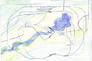

hi again i got around to modifying the plan. im thinking of definately going with jetrocks lumber mill suggestion, any opinions on this mill though, i looks very impressive
http://www.walthers.com/exec/productinfo/770-3797
i think i need to explain this plan. right so we'll start our journey in the top left hand corner. basically a train will come from here (from my expansion in future), it will be a main line passenger train. it will come down the track, over the bridge (in red, B beside it) then it will go straight through a tunnel(in orange, T under it) then it will take a turnout to the left. It wil then loop around by where the town will go (next to the lake) then go by the left of the lake where it will meet with another line coming from up above. The two merged lines will then move down by the sawmill, (one of the merged lines will be used by the loggers) the mainline will then go back out onto the track and through the tunnel again and then leave this current section, of my overall vision(to be done at a much later date), at the bottom roght corner of the map. The logging train will leave the sawmill and travel down the mainline train tracks a little but will fork off to the left onto its own track, it will travel this track over as far as the existing track going up the left hand side of the map. it will once again continue straight on and go onto its own track and the existing planned track will take a s king of bend, then a full bend then go straight and eventually end up where the mainline trains would have started on this section.
So everyones confused then?
The logging train will only be on the mainline for the tiny bit from the logging area in the mountains at the top of the map down to the turnout for the other logging area at the bottom of the map. The other half of the oval will be used by a freight train to carry coal form the mine that im putting in at the top of the map near the bridge(thats for the future though) and it will also carry other freight and lumber on the mainline to the city that i plan on building as a different section in the future once this section is done.

anyway i hope this map uploads.
sorry i should point out that the pink line running above the tunnel should go on passed where it turns back out. it should turnout at the next blue line instead. oh and you might notice i have simplified the design (less turnouts etc) aswell
