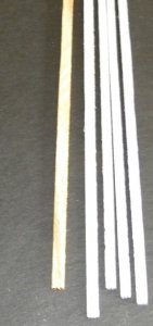

Here is a picture that has one unpainted board with several that have been painted gray,
then there is a photo of the with a dusting of green.

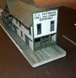

Here is a photo of the front porch on the Company store building I am building for the J. E Patterson Coal and Lumber Co. at the Clarksville Tn train club. (see Bill and Tom's excellent adventure in the logging mining, and Industrial RR section)
This porch is done with the spray paint method I have described.
In this case the wood is aromatic cedar, cut on my mini table saw, and spray painted with gray primer and the green color on individual boards before assembly.
