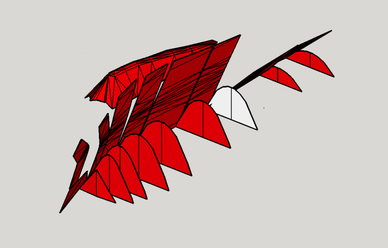

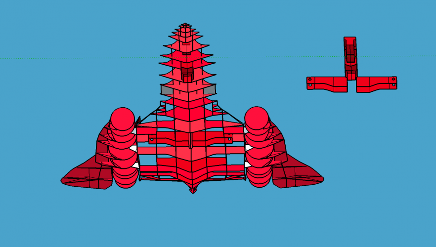

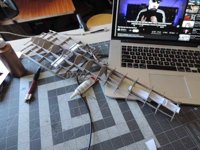

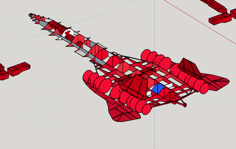

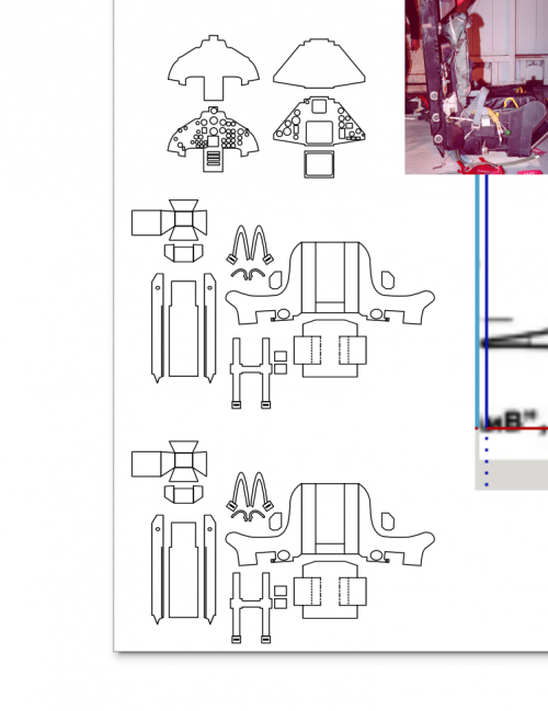

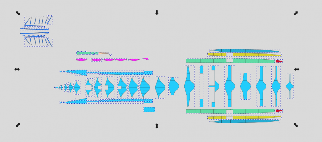

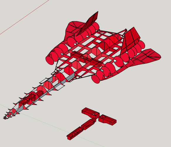

I hope I did not over do it!!!!!!! The skeloton part is SO FUN!!!!! But yeah this is where we at so far. It the whole model is 35 inches long so It won't be too dense I think. I do not worry about compexity because I have no time limit or deadline for it. I made the cockpit bucket, and trycycle landing gear doors,
AS ALWAYS!!!! ANY tips are appreciated anything I should know before drawing out skin? is there a problem with the skeleton? please tell me!

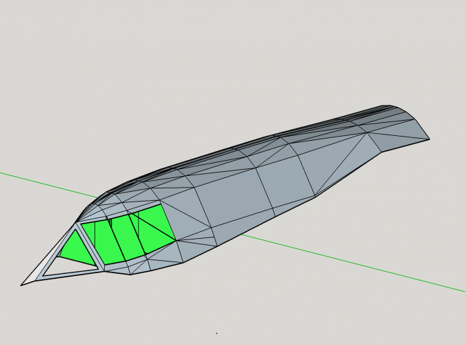

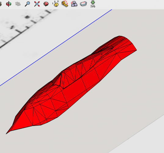

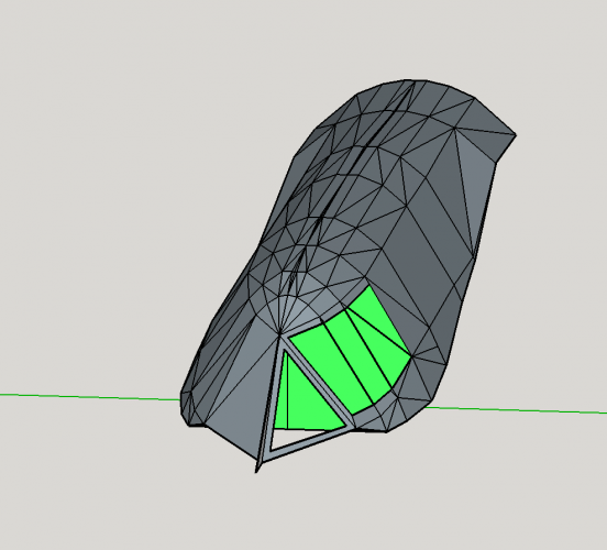

I did that in Adobe CS3, and also in Rhino 3D. What that picture represents is parts of panels which are the same. When they differentiate, I either split the panel where it differs, or start a new panel. This makes for a model that does not look like it's made of chopped segments. The pic I posted is the "turtle deck" of the Cessna, going from back to from the back of the cabin to the front, 1/2 of the rear cabin. Great looking frame! :)

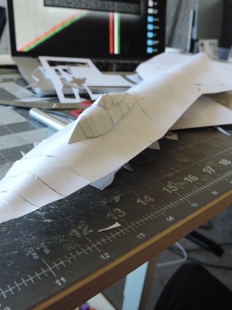

Much better looking canopy. :)

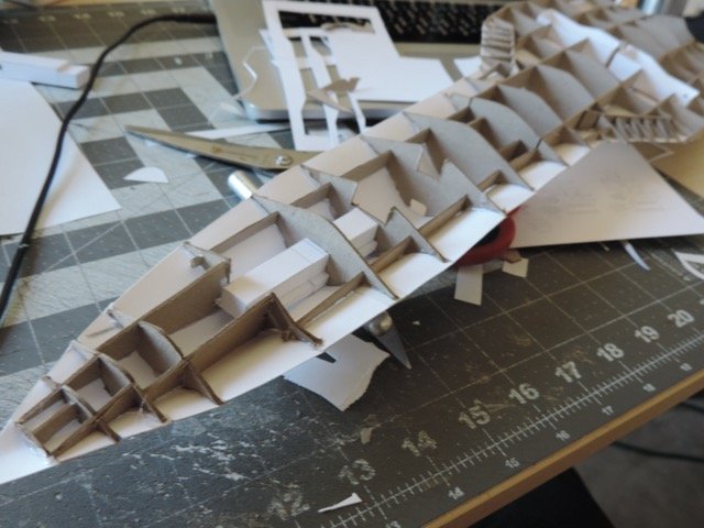

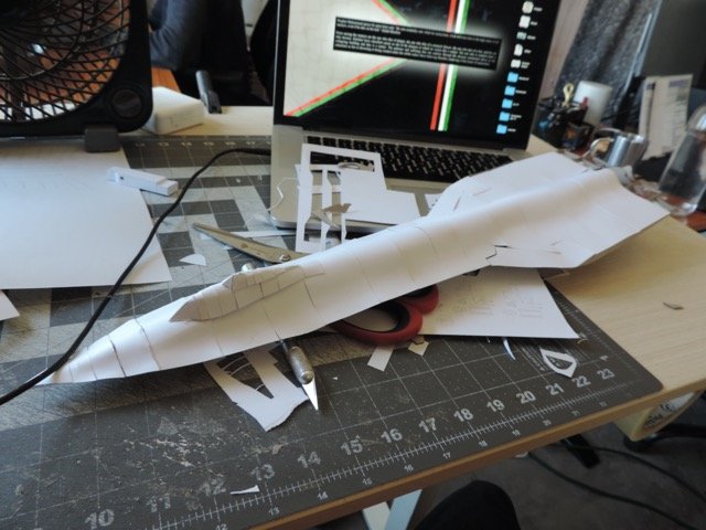

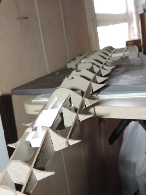

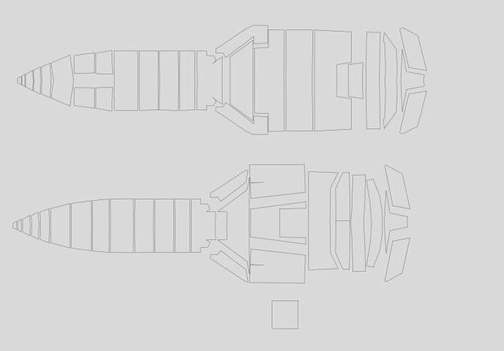

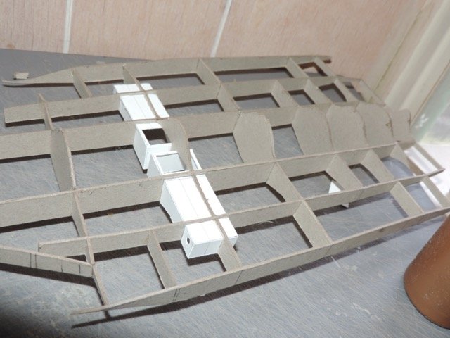

So I built a 1:48 scale version of the main fuselage as a test build it is VERY rough, but It brought to life some mistake's Really ther eis two main mistakes:
  • I did not add tabs (THIS MAKES IT SO HARDDDDDD)

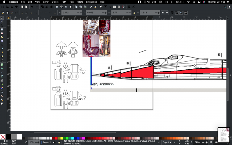

  • And one of the front panels was accidentally re-scaled in inkscape which made it IMPOSSIBLE to fit.
So next time Ill take more care. & I will spend more time on the skeleton to make it more crisp.
(Btw, I did not do the entire bottom, engines, and tail fins as they are simple and I kinda KNOW they will work.)
