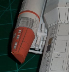

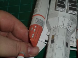

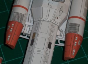

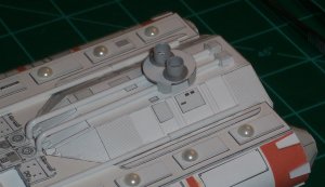

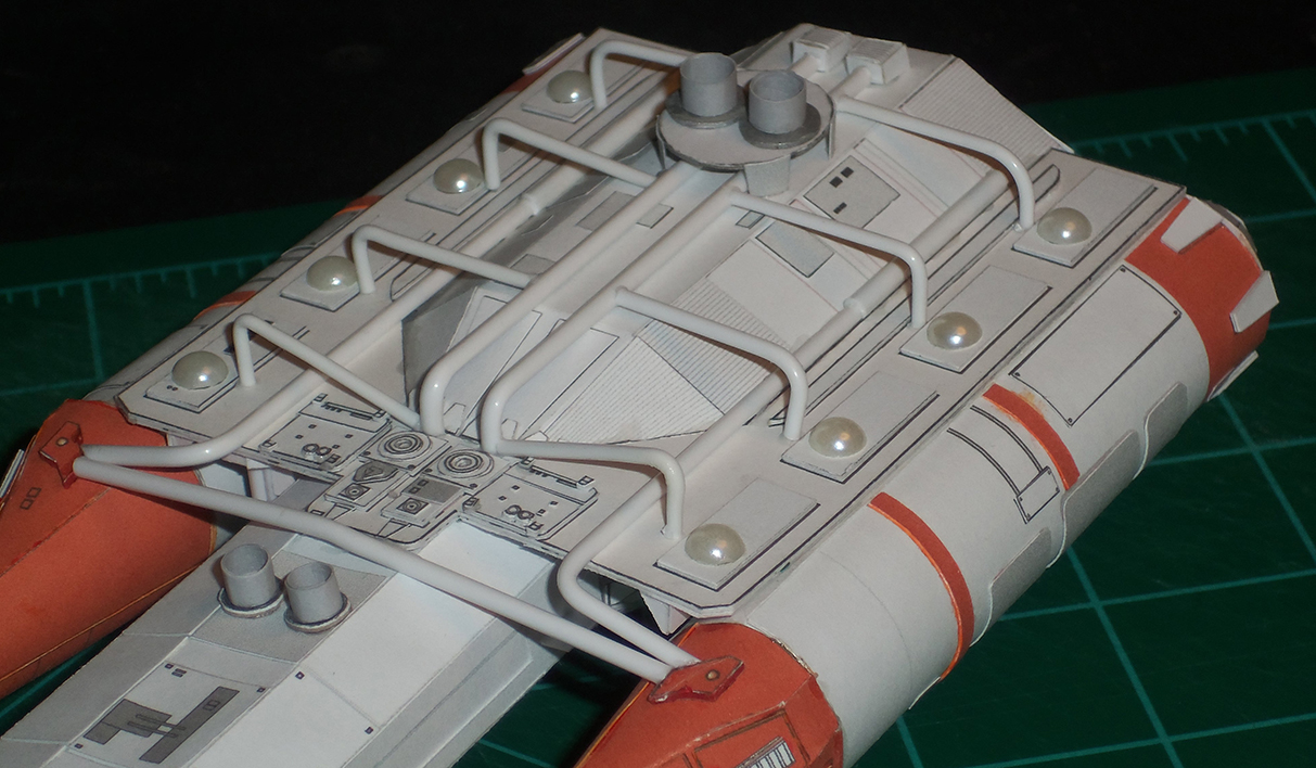

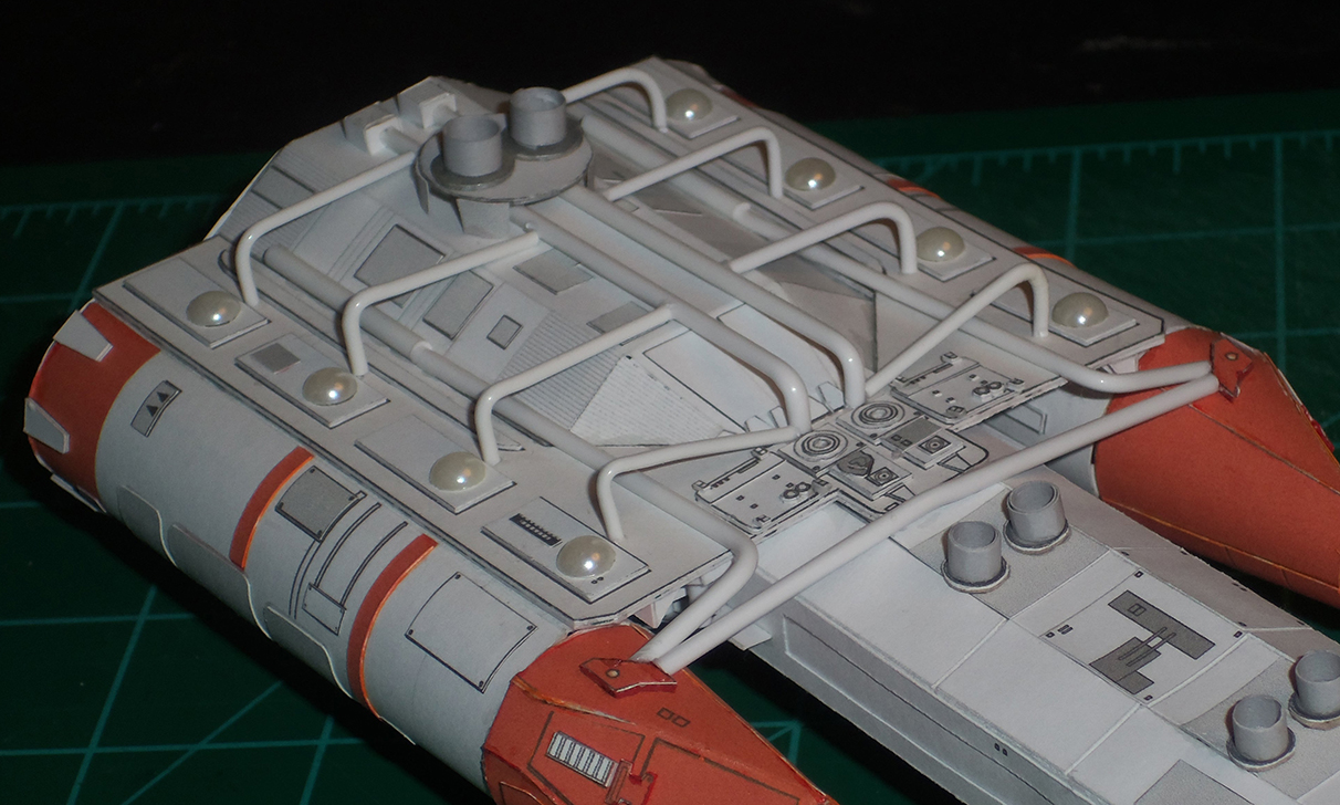

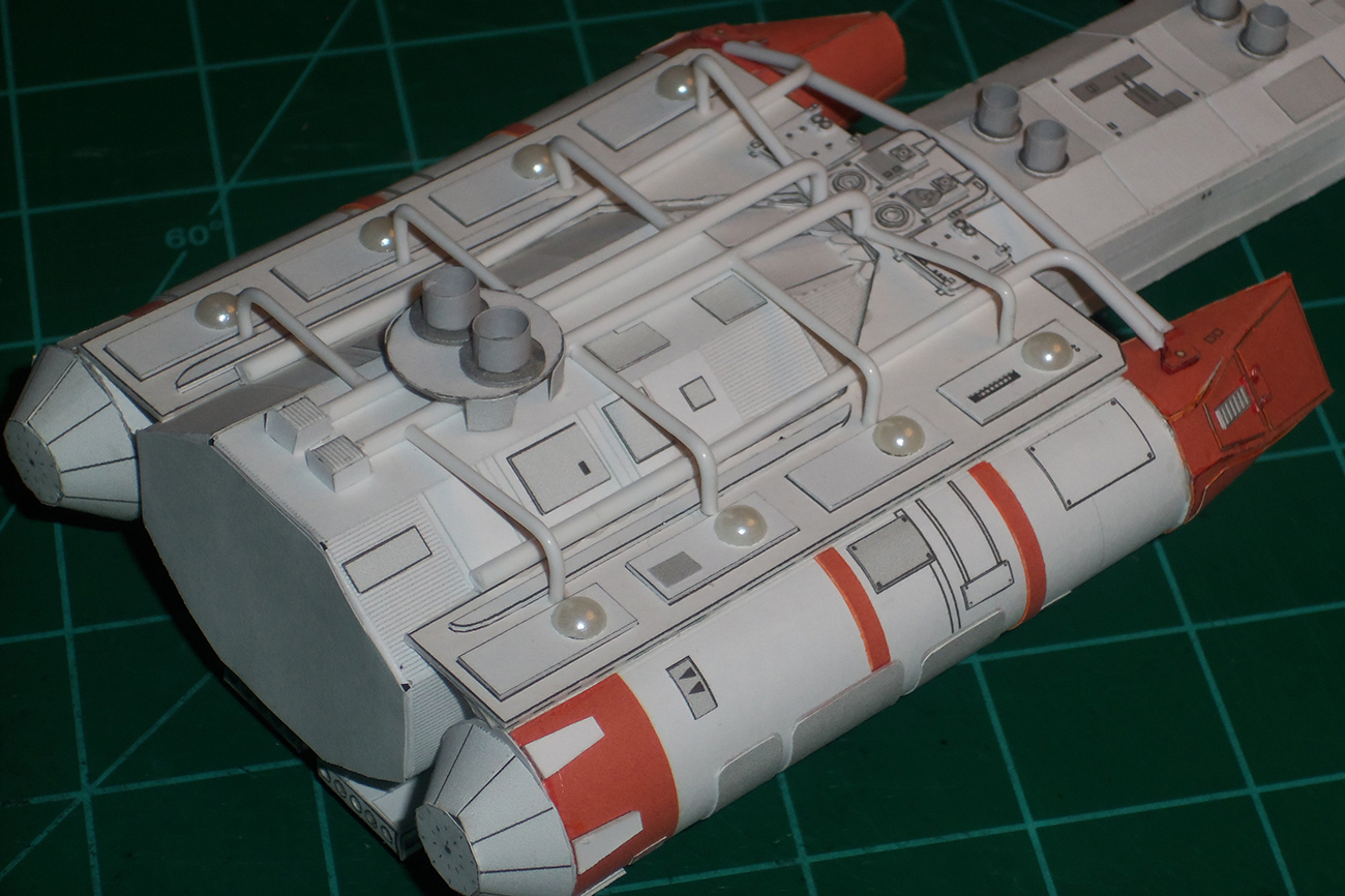

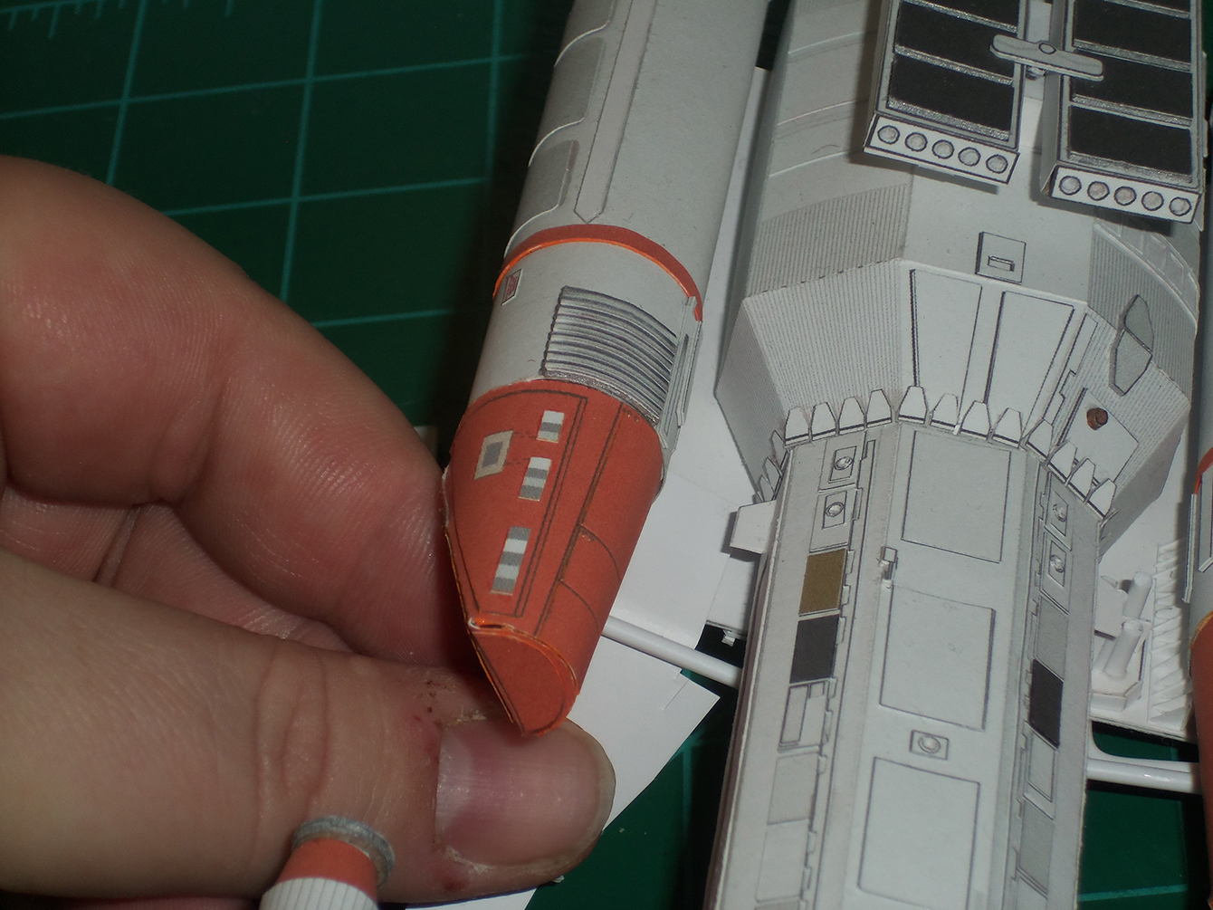

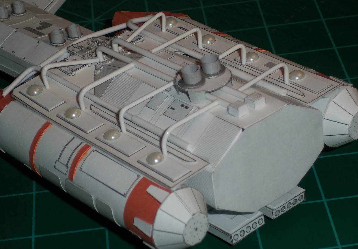

LOWER THRUSTER
More progress on the bottom of the Hawk. I scratch built the lower rear thruster on the bottom of the rear fuselage. I did the artwork in Illustrator, printed out the disc and glued it to 2mm chipboard. I edge-colored the chipboard with silver Sharpie. The four “legs” were cut out of scrap gray from earlier parts. They are trapezoid shaped with the wide ends attached to the disc. I made the legs a little tall, then trimmed them until the part fit right over the piping. I glued a second disc to 2mm chipboard and cut out the bottom of the thruster cylinders. I colored the edges silver. I cut 5mm strips of gray card stock and made the thruster cylinders.

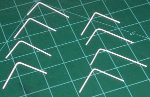

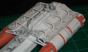

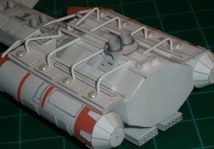

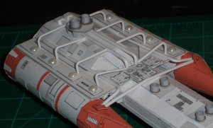

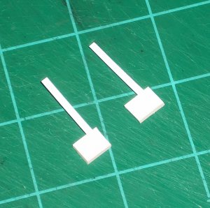

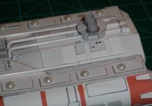

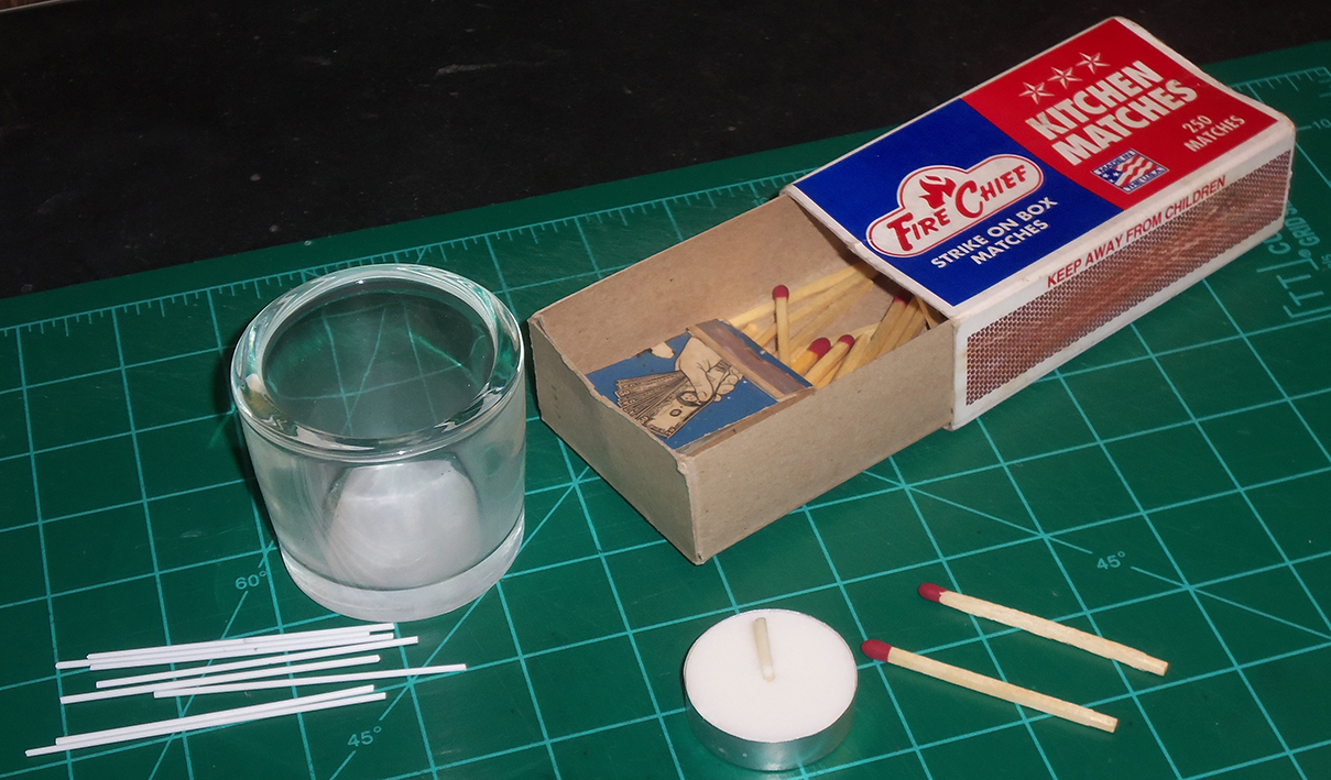

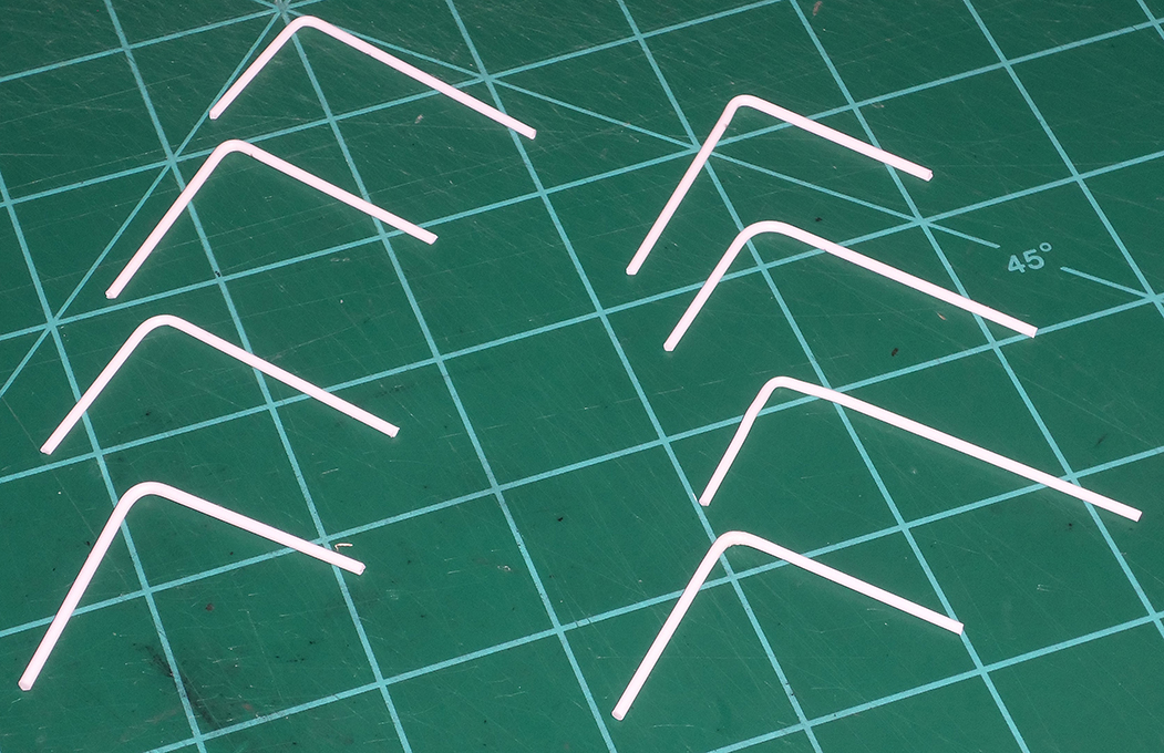

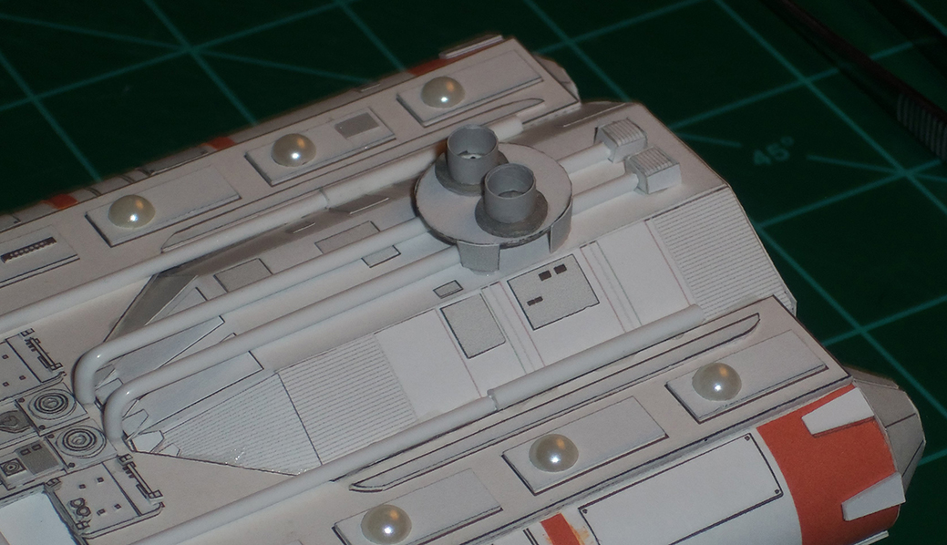

LOWER FRAMEWORK

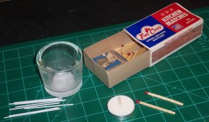

Here you see my high-tech styrene bending tools. The tea candles are cheap, and with the candle holder I’m using it makes a nice set distance between the candle and the styrene.
The lower framework is just 8 styrene rods bent at an angle. The neatness of the bend depends on how fast you bend it once the styrene softens. I’m still getting a handle on it and some rods had to be reheated and rebent. Six rods are at 90-degree angles. The two toward the front are at a steeper angle. I made all the rods longer than I needed, then used my X-acto to trim a little at a time until each fit like I wanted. A little Super Glue gel on each end and everything is locked in place. Looking at my reference photos of the big Hawk model, I think the rod I used is a little too thick. However, I can live with it.

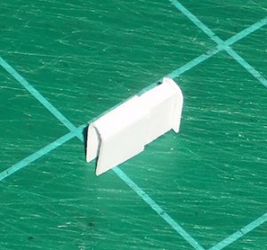

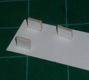

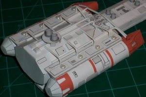

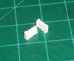

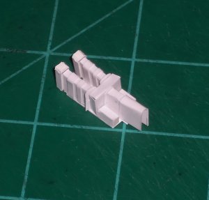

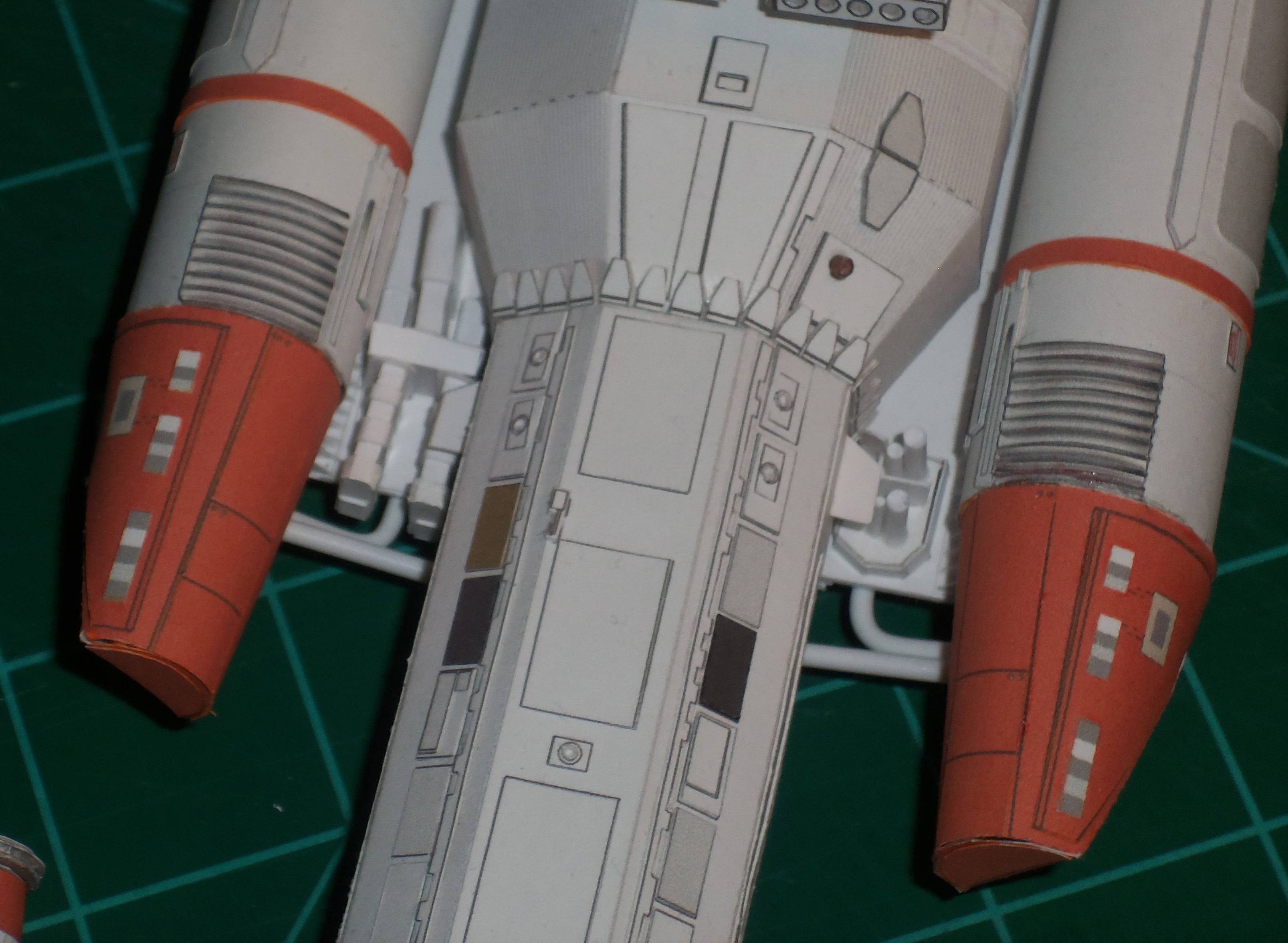

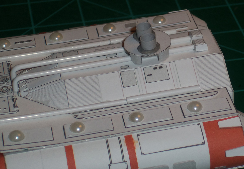

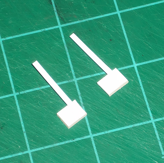

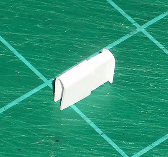

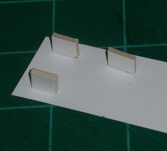

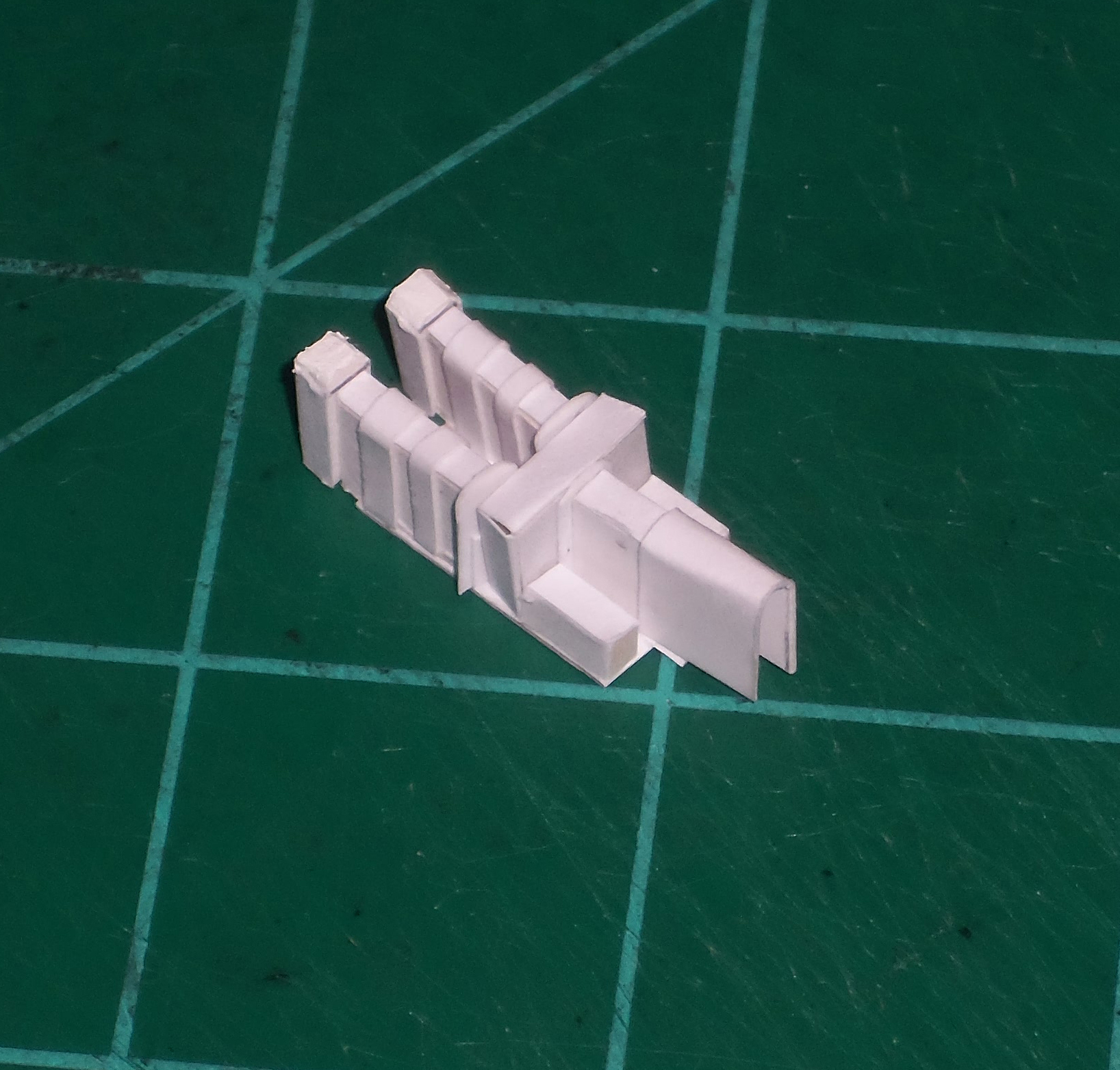

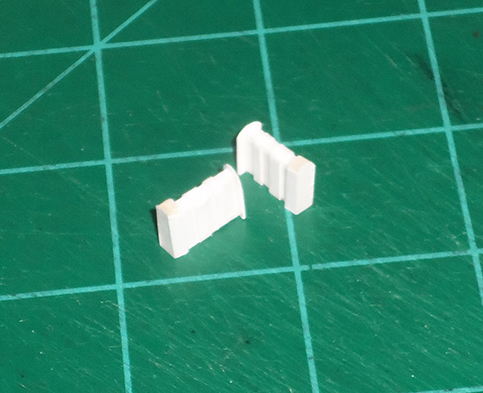

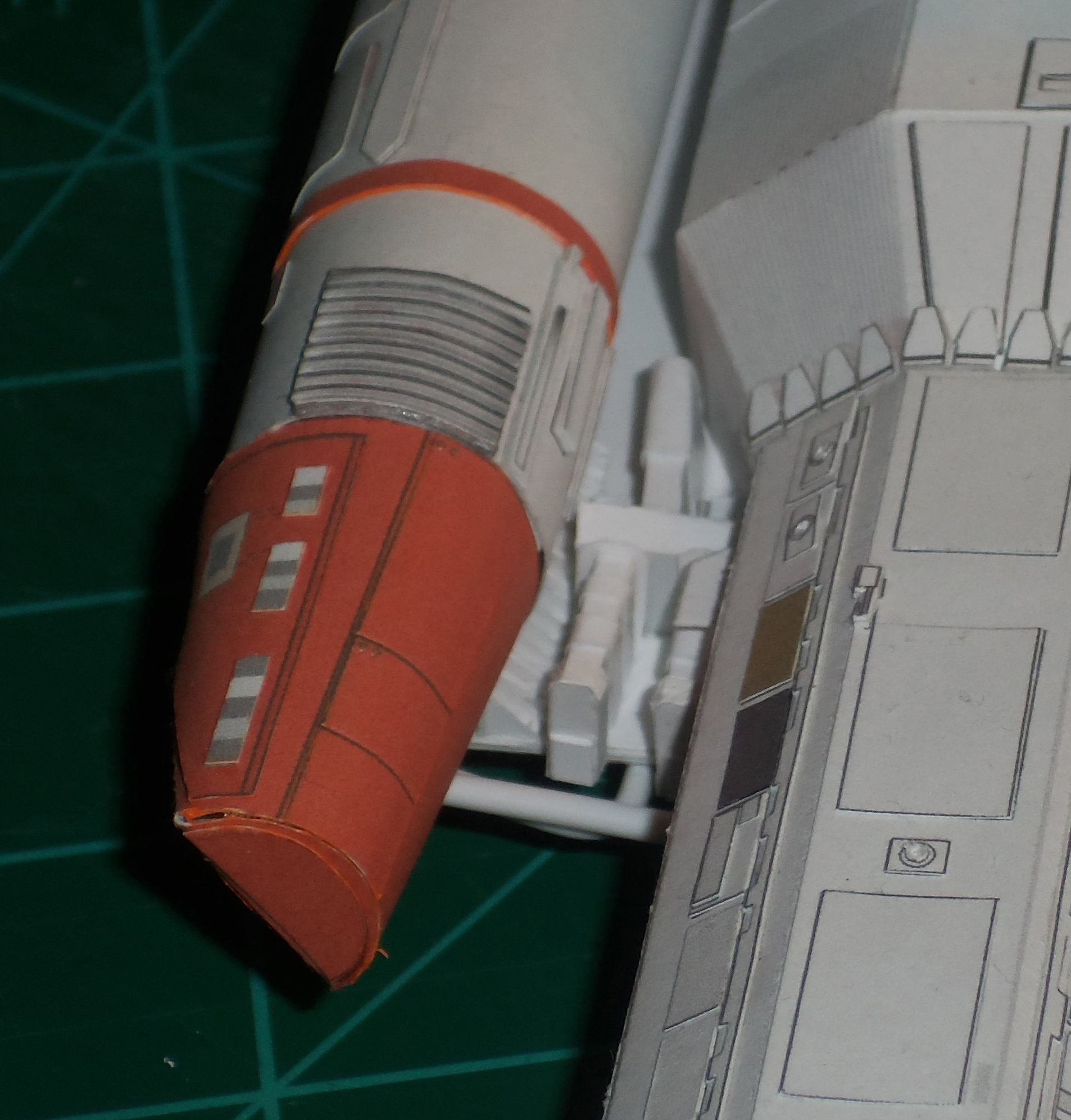

STARBOARD GREEBLE
Inch by inch, progress is happening. I’d been avoiding this part because I wasn’t sure how to make it because it’s a complex piece on the studio model. Since my model is a much smaller scale, I decided to do what the real model builders would do and create a basic copy of the big part. The whole thing was done by looking at pics of the part and just cutting pieces of 2mm mounting board and 67 lb. white cover, adding card stock on edges and for detail.
To make sure this big part would fit in that tight space, I cut a piece of scrap card until it fit between the booster and fuselage. I glued the parts to this base and slid the whole thing in place.
Of all the work I’ve done on this model, this is by far my least favorite. It’s not a very detailed or accurate copy of the original part. I only have a few good pics of this area and even then gauging size and detail is a bit of guesswork. Couple that to my amateur skills and it’s only going to be so good. Luckily, this and the piece on the port side aren’t parts that get a lot of attention. Unfortunately, I’m going to run into more of this when I get to the greebles around the main engine.
As it stands, I take measurements of the scratch-built parts I do and some form of these will be included when I release my files of this kit.
