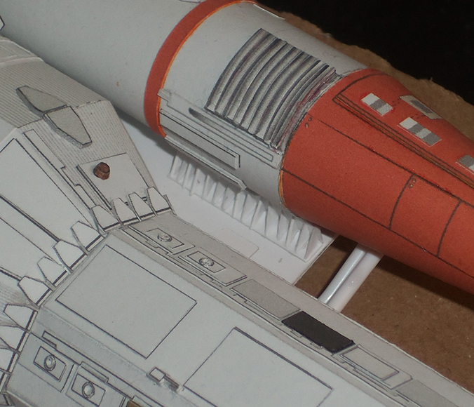

It is time to make some more progress. I picked up correcting the solar panels. My original design was missing the bottom details on the panels and the base was too wide. Using my X-acto and precision scissors I cut off the old base without destroying the panels. I built a new square base using 67 lb. cover and 2mm mounting board. Then I added the bottom of the base and the detail to the bottom of the solar panels.

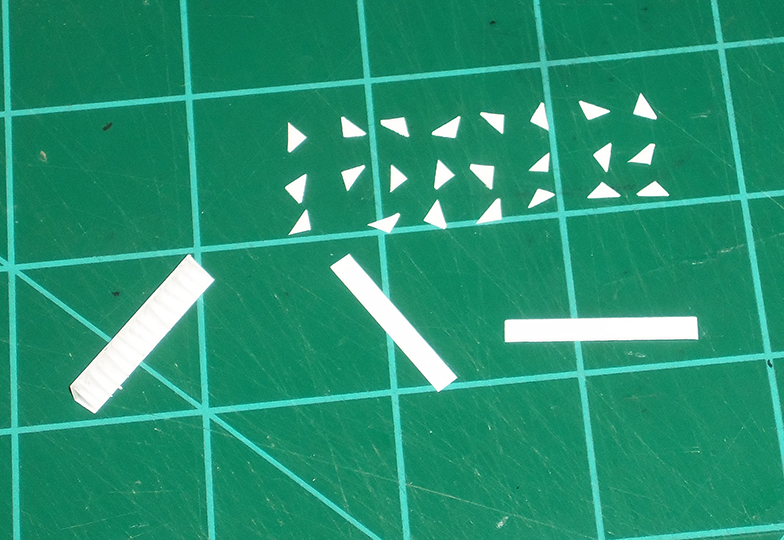

Next I added the triangle frame pieces around the base using 67 lb. cover. For the smaller ones, I made 4mm squares and cut them diagonally to get 10 matching triangles. For the bigger ones I made two 5mm squares and repeated the process. All were glued in place using Super Glue gel.
On the studio model, there is a cylinder on the port and starboard sides of the panel base. I couldn’t find anything in paper that would work, so I went with styrene rod. I cut some pieces to fit and Super Glued them in place.
Finally, the whole panel assembly is glued to the hull.

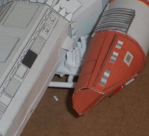

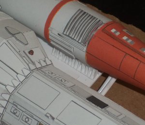

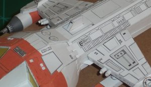

THRUSTERS AND FRAMEWORK
Finally got some more Hawk time. I started mixing media by using styrene rod to replicate the conical wing details on the top and leading edges. Using the styrene was a natural choice. I did look for a paper or wood option but none came close to the size I needed. I had two problems with the rod.
The first problem was my little mitre boxes didn’t do a great job of helping me get straight cuts. This was my first time trying to use styrene and my learning curve was steeper than I thought it would be. Plus, these were pretty small parts I was making, which made it even more fiddly. The final result was not the best. I should have come up with some jig, but I really wanted to make some kind of progress. The consolation is the parts on the studio scale Hawk aren’t perfect either.
The second problem is really more of a preference. Naturally, the styrene doesn’t look like paper. It’s not a jarring difference, but it’s not as close a resemblance as I was hoping for.

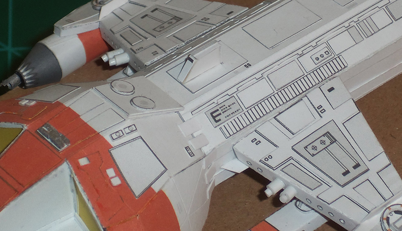

Next up was making the thrusters on the bottom of the main fuselage. These are gray mattress vents on the studio model. Mine are gray card stock curled into tubes and cut to size, then superglued to bases on 2mm chipboard. I eyeballed these until they were a size that went with the model. These are pretty small on my model, so I skipped replicating the vent detail inside the thrusters. I glued a small magnet into each thruster farthest to the rear in the hope I can use them as a model mount. If two aren’t enough I may add magnets to the other thrusters.

Finally, I got after the bottom framework. I uses a tea candle to heat the appropriate rod and get the bends I needed. It was my first time trying this so there was a bit of trial and error, but it actually worked really well. I started with the rod connecting the boosters and worked my way back, trimming and bending until I got the sizes I needed. Once the frame was made and glued into place I build two squares out of scrap and 2mm mounting board and placed them at the end of the two pipes on the rear fuselage.
The big problem with the framework was they pipes that attach to the boosters are supposed to be straight and parallel, but my boosters are mounted so they don’t line up with the fuselage bottom. This makes the boosters too high to attach the pipes in the a straight line. Sadly, this is one of those things I never considered. Since a rebuild was out of the question, I adapted by using the candle to put a slight bend in the pipe.

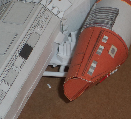

GREEBLIES
I added the “fin” details that go against the side boosters. I scratch built them out of 67lb. white card stock. Just a simple cut and Super Glue into place. It’s not an exact match because the original part has a curved back and mine is straight. To try and replicate that at this size would have been more trouble than it was worth. You can barely see them at this size.
Next, I made my version of the greeblie on the port side between the fuselage and size booster. I think the original part is a piece of a lunar lander model. I didn’t have a really good reference pic of this part, so the whole thing was done on the fly. The base is 2mm white mounting board sided with scrap white card stock to cut down on the “plastic” look above. The rest is various sizes of styrene rod and 67lb. white card cut into strips and squares. It’s not great, but it works and if I ever want to get done I have to balance the time I spend on these less-vital parts.
Last greeblie for the day was the small tower behind the command module. It’s also made of 2mm white mounting board sided with scrap white card. The black window and gray section on top are cut from scrap parts.
