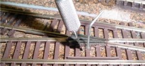

Okay, here is what I did to get power to the frogs of the switches that were already glued down:

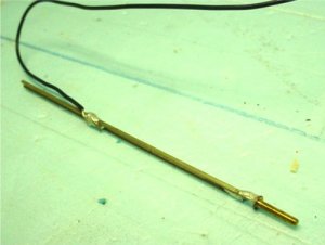

Here is the frog feeder screw device. It is made from a piece of rail filed to a screwdriver tip with a 1-72 screw and a #22 wire soldered on.

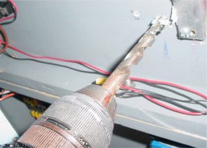

I got measurements to locate the frog tab underneath, then drilled a 1/2 hole underneath, just through the plywood.

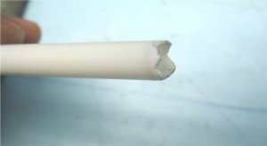

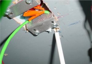

Make a hole saw from a plastic tube, this one is 5/16" diameter. Place the hole saw over the wire and then start cutting the foam by spinning the tube and pushing up. The wire will help guide the hole saw up to below the frog. When you get to the cork, continue spinning, and use the hobby knife from above to finish the hole and open up the cork.

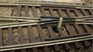

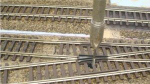

Tap the hole with a 1-72 tap, then stick the frog feeder screw device up through the hole, find the frog tab, and thread her on up. Gently tighten the screw and then we'll connect the wires to the spdt switch for routing the proper power and that's it, a fed frog! Use a Dremel tool to cut the screw off flush with the frog tab and we're runnin' trains with nary a hitch!
