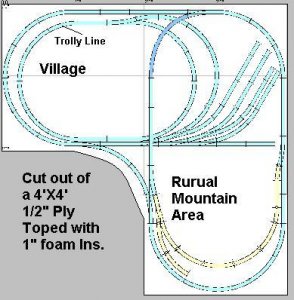

Here is an image of the layout plan. There is a little spur in the mountain area that I forgot to mention. This is a small line that will go into a small tunnel that will be a coal mine shaft. I will park a couple coal carts there. If I want to, I can back into it, and pick up the coal carts and tote them around.
Also, under the plywood at the operator station, I have a pullout keyboard drawer mounted under there that will hold 2 tranformers (1 for the trolly line, and 1 for the main line) and turnout switches.
The trolly line is at ground level with the village. The main line is elevated 2", and the village sits in a "bowl" of landscape. At the closest corner will be a waterfall feeding a small snaky river running up to the other corner of that side. There will also be a spring fed lake in the rural area. Like I said, it will be a busy little layout. I am trying several things on a small scale with this layout. it will have a wide variety of activity to tinker with.

Small apartment sized. Whoa..that's a lot of space then. Oh, wait. :)
Calculating percentage: horizontally you move 100 units. Percentage is the number of units you go up/down within that same distance. Probably a little bit more straightforward to do with the metric system. Example: over a stretch of 60cm the track rises 3cm. The percentage is 5%, because 100/60*3 = 5. <---corrected. My math knowledge is quite basic.
Layout looks interesting enough - multiple loops and a switching playground. Maybe just make the bowl a bit shallower in order not to have such a steep grade, and if it's only the access point to the trolley line, it probably won't see that much traffic to be a huge annoyance in operations. (Different story if it'd be a part of the main line)
Yeah, I think I am going to lower the ridge a little. But, the only problem with that, is the loop coming around the mountian side and goes straight through bypassing the village had a tressel and at that point, it has to be high enough to clear the rolling stock passing under it to and from the switch yard. In that small of space, I have to be low enough to give a more gracefull rise from the yard, but high enough not to have such a high grade comming around the mountain area. Not sure if that makes any sense, but, anyway.. I still need to tinker with it, because you guys are right, I think I need to lower that grade some more..
