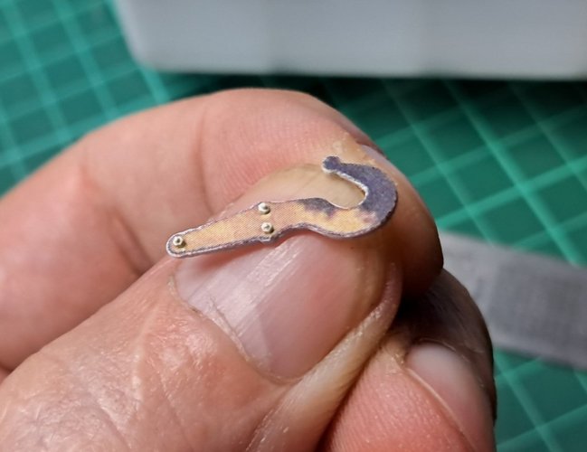

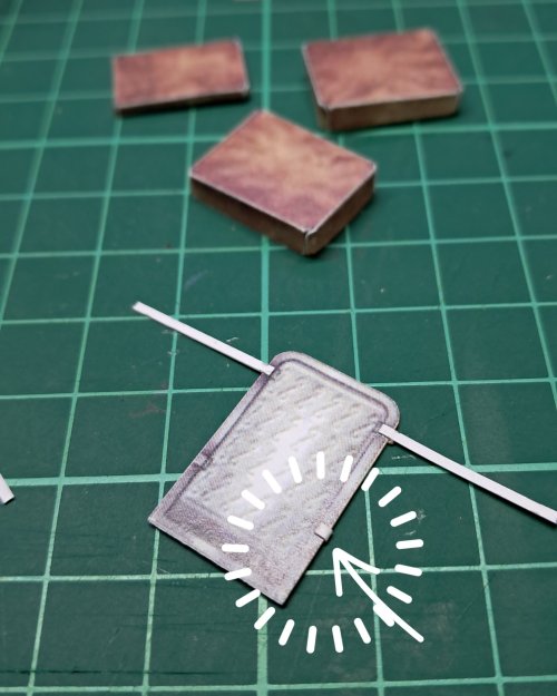

Top & bottom shot of the first few added parts - A back thumb plate? also a bar from some brass wire across the top.
Some kind of catch plate (middle was cut out to aid the fit)
After a weeks work, I have six Jerry cans!
Cans of Jerry
I also added a 0.5mm strip of paper ahead of the brass wire to give it a small bit of extra detail, which can be seen on the photo of the real thing.

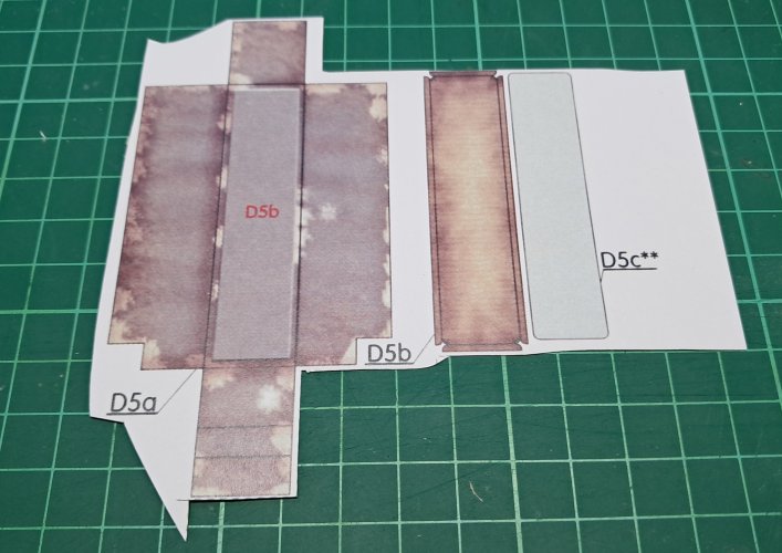

The instructions, detailed as they are, leave a lot down to the builder to figure out 'what goes where' and there's really a steep learning curve here, especially if you have not built a model from the publisher before.
Tiny sub-assemblies were picked from the illustrations.

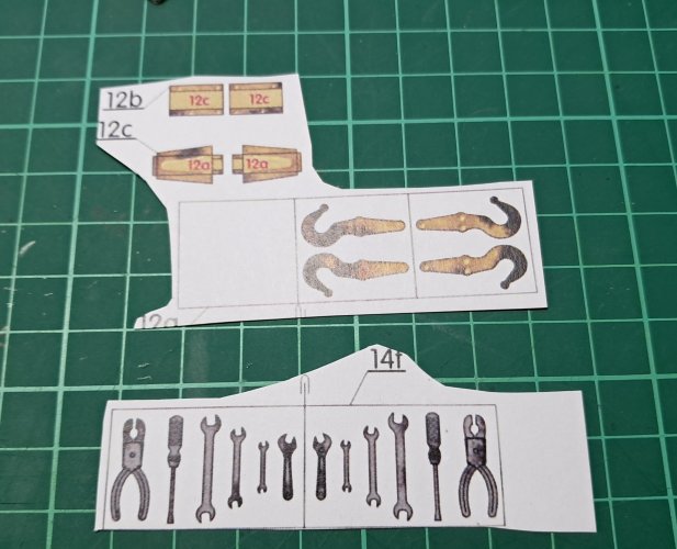

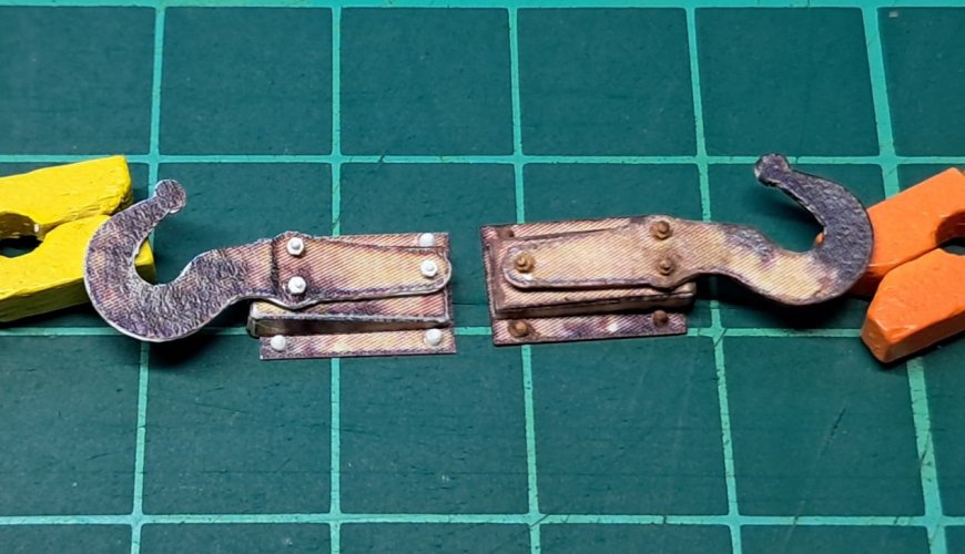

Front tow hooks I believe, and some tools...
With large scale of this kit, some of the printed detail needed to be brought out.
I bought some moulds last year for another project which included nuts, bolts, rivets etc, so I rolled up some Milliput putty and produced some 'bits'

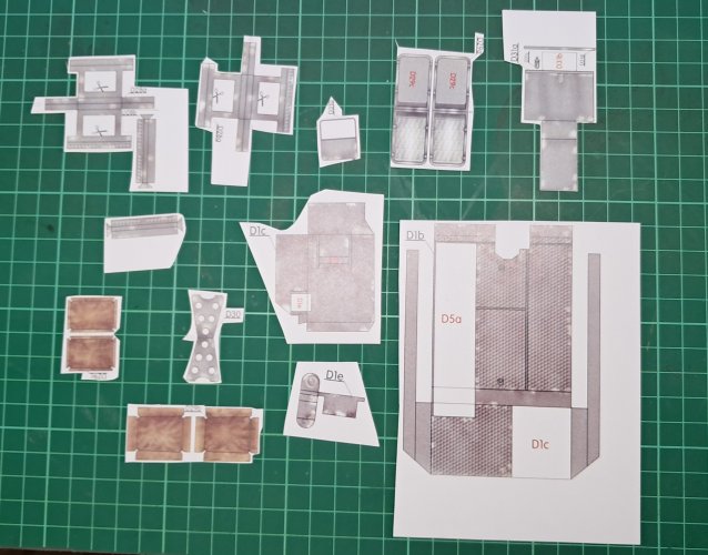

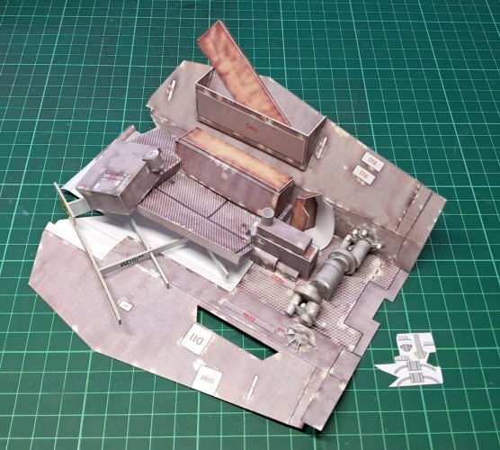

Parts for seats and floor pan - the side rails took some head scratching, as the folds made no sense whatsoever! I just made them up in the end.
Seat backs had some added detail, as I noticed in some pictures, the seatbacks were tethered to the frames by straps.
I'll paint these a leather colour later. they will probably be unseen, but we''ll know.

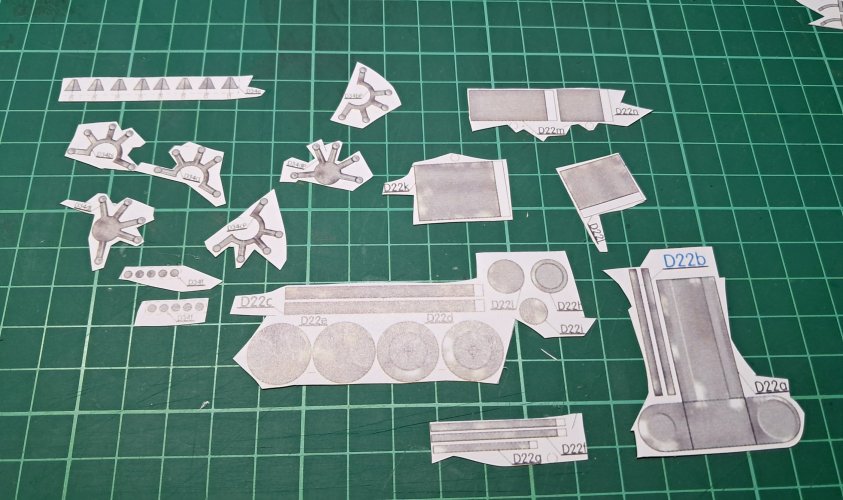

Parts for the main drive shafts and clutches - for such a large sub assembly the instructions were far from helpful, It took a couple of nights to visualise this, even plastic model parts from plastic kits and the real thing looked different! I'm even sure there's two discs missing???
Once again, I made this up to something which vaguely looks like it should be there.

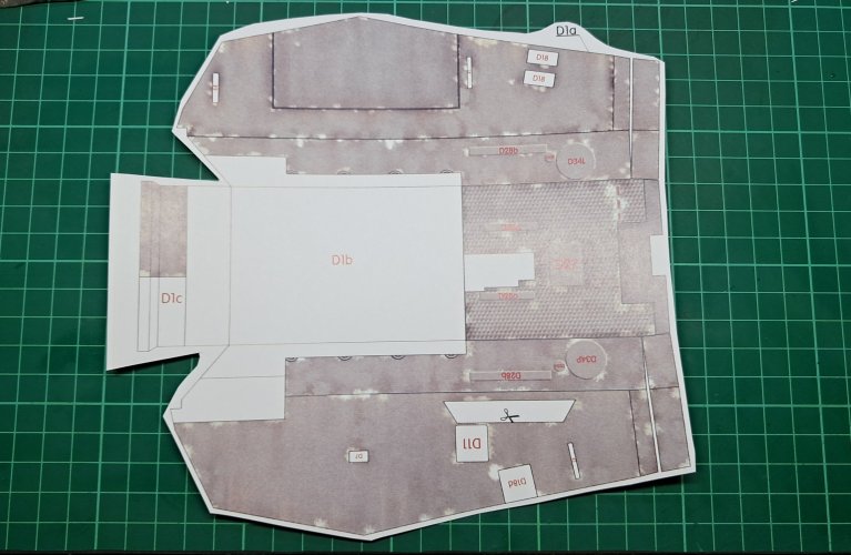

Inner floor and sides.

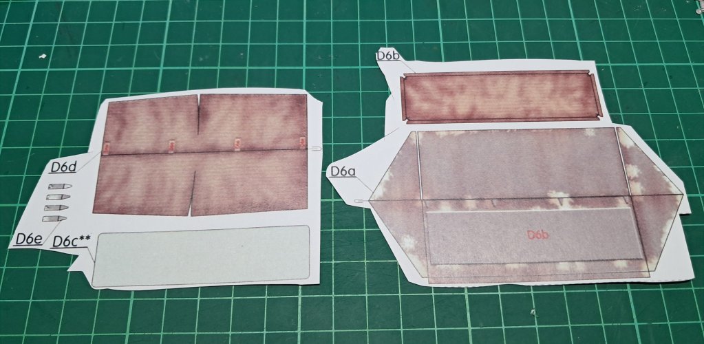

Lefthand upper-side seatback and stowage bin, which has no placement showing on the instructions!
lower bench and seat-cushion
A weeks work lumped into the interior... Sorry, but the picture for the gearbox (centre) was lost, although it was an easy build.
Nothing painted yet and getting my head around where everything goes.
