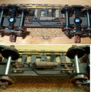

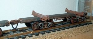

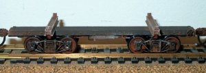

I don't have enough log cars, ;) ;) , so I thought I better do a couple more;) ;) . These are the MDC Twin Pak Skeleton cars.

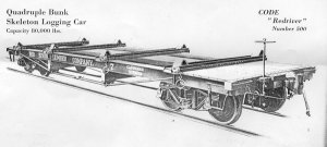

Another Kind of Log Car
Thought some might like this type of car. Similar cars were used by a number of pine loggers in the Pacific pine forest region.

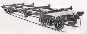

Yes it seems to be longer than most Skeleton Logging Cars. It is a 40' car. Here is another advertising cut for a similar car made for the Craig Mountian Lumber Company in Idaho. The only difference Between the two cars types is that the Craig Mtn. car has different bunks (what they call automatic bunks) and the center sill between the two main sills is a single long timber 10" x 10" which extends from the draft rig to draft rig. These two differences add 1000 lbs. to the tare weight of Craig Mtn car.
