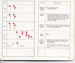

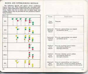

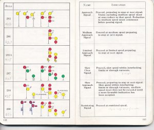

Herre are some pages from the 1962 Canadian Operating Rules. They cover signal indications.
Notes
Speeds:
Restricted speed: a speed that will permit stopping within one-half the range of vision. And in no case exceeding slow speed.
Slow speed: a speed not exceeding 15 miles per hour.
Medium speed: a speed not exceeding 30 miles per hour.
Limited speed: a speed not exceeding 45 miles per hour.
Some of these rules have been changed since then. I put the new rule numbers in pencil. The term "approach" now seems to be "Stop".
Notes:
unlit lamps are to be taken at the most restricting meaning, usually red.
The signals are speed signals only; they do not indicate routes. A lot of them limit speeds through switches or interlocking, then permit a higher speed to the next signal.
Signals with both heads on the same side of the pole are interlocking signals. Signals with heads on opposite sides of the pole are block signals (second pole in rule 281).
