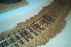

Tie Sizes...
Hey, Phillip!
Here's an example of the difference in tie sizes fron HO to O scale. Prototype ties are 9 inches wide, 6 inches tall, and narrow gauge ties are about 8 feet long. Here, you can see a few old HO ties still on the rail. The larger ones are O scale ties. Once the rail is spiked, I remove the last few HO ties.

Oh , Almost forgot....Jon when I was talking about ripping them what is the size of 0n30 tie length, height, width. Can you buy em? And what about the spike? I just want to make a small track section just to get a feel of what this 0n30 looks like in the flesh.
That, I dunno, Phillip, I'm not modeling On30. Steve's prudy nice about measuring stuff for us, perhaps he'll measure them for you :D :D :D I've not done any hand laying...yet :D :D :D

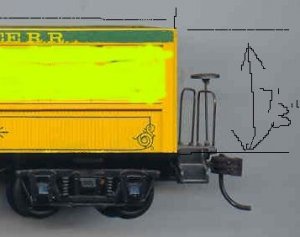

height?
Today I ordered the trucks and couplers. Is this 7foot 3 inch height close?
Is the width 10 foot wide? My scale ruler says it is, but the conspiracy thread suggests a narrower width?
Catt wrote...................A safe width for 0n30 cars and locos ia around 7 to 8 '.Actually you can use 0n3 measurements because the real difference in the two scales is really just the track gauge.

The Bachmann car measures 7', where you have 7'-3", it is 8' wide roof edge to roof edge. Catt's reference to On3 simply applies 3' gauge standards to the 30" gauge equipment. You can use any drawings for 3' gauge (HO,S,O, or whatever scale), and convert them to O scale for On30.
Pete
Pete: The pic of the V & T (Roundhouse HO ) above is 10 scale feet wide. I thought it looked a little wide. philip
