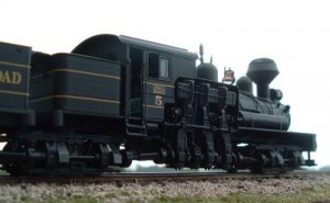

I thoroughly enjoy my Bachman though I don't have the sound chip (stuff drives me nuts). Once clocked it around the club layout. It took 57 minutes to traverse 1000'---drove the guys nuts.:thumb:
Well, the top speed of a real Pacific Coast Shay is 13mph or to quote a old logging enginer "the top speed of a shay is 13mph over a cliff !"sign1
But a shay is Its not how fast you go its how nuch you can pull
