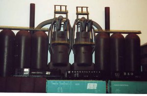

Hi all,
I made this pair of blast furnaces for my HO scale layout based on pictures posted on Spitfire's website:
(http://members.rogers.com/urbanscene/ ) and from some pics of steel mills in model train magazines. The towers are Suave brand shampoo bottles and the furnaces were made from parts I found in the gutter and downspout department of my local hardware store. I spray painted everything a dark grey and then weathered the assembly with artist's chalks. I didn't like the way it first came out so I tried to wipe it off with a dry cloth. This seemed to "burnish" the chalk and created a metalic look I'm very happy with. The safety railings are HO scale ladders turned sideways. This makes them look smaller and farther away than the commercial safety rails I was going to use; increasing the illusion of a larger blast furnace. I might place N scale workers up there.
I've placed the blast furnace in the back of the layout near the backdrop to suggest that most of the steel industry is behind the furnaces and not visible. This way I don't have to model the entire "works" which would overwhelm that section of the layout. I will add a structure or two closer to the front that can receive rail traffic; a rolling mill perhaps....

Very nice indeed! Immagine what it might cost to make it from a kit and probably take as long to get it lookin good.
J, if you really need some smaller cylinders, look at the PVC pipe, you can get about any size and it's cheap and easy to work with. And you won't have to do like Ralph, "Hon, your hair still smells funny, better go wash it again. Ooops, didn't mean to blast you in the head with the orange spray paint, better go wash that out neeeow! Um, it's still got an orange tint dear..." :D :D :D
Thanks everyone. When it comes to modeling I like to do it on the cheap. I'm a great admirer of those Walthers steel mill kits but the price is prohibitive and I have to confess to being an impatient and unskilled kit builder. I feel more confident messing around with a $3.00 shampoo bottle than an important part of a $250 kit. Besides, its a kick for me to tell people what some of my structures are made from. I've been saving those shampoo bottles for awhile because they had a good industrial look to them. Fortunately I didn't have to resort to the scenario Jon suggested! My wife's a trooper though and probably would have washed her hair a few times a day for the cause. Then she'd look at me and ask, "Why didn't we just pour the shampoo into another container! " Pretty par for the course of us! :D

Great job, Ralph!
The forced perspective sounds like a neat idea!
Would love to see some more pics!

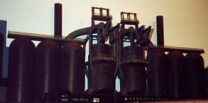

Thanks Charlie. Here's another shot of it. I should have taken more pics but I spent the roll on other things on the layout that I'll post later. I have GOT to get a digital camera! I'll shoot some more pics after I build the other mill structures I want to add.
