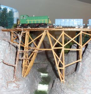

Thanks, that looks like a good resource. here is a photo that shows the iron furnaces and coke ovens I have made with hydrocal cast in liquid latex moulds made from carved hydrocal masters.
If I got to playing with RTV and casting resin, I'd like to learn how to make two part molds and make a lot of tweetsee style Hon3 hopper cars similar to ones I have scratchbuilt from wood, one of which is shown on the Sander's Gorge bridge.
Bill Nelson
