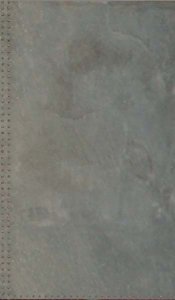

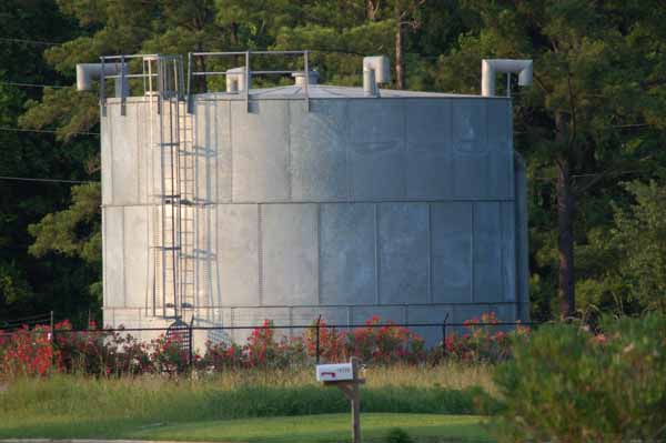

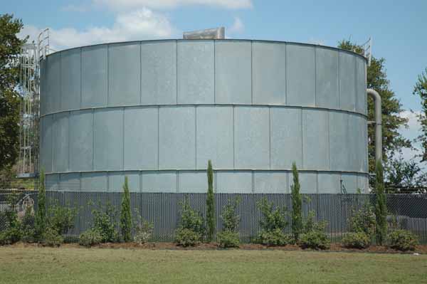

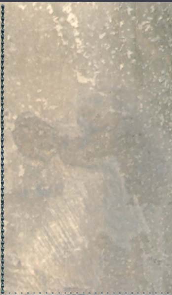

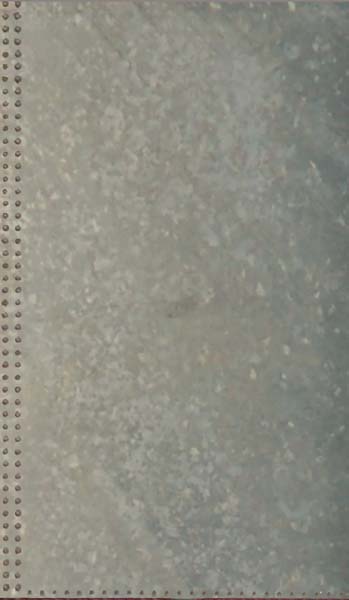

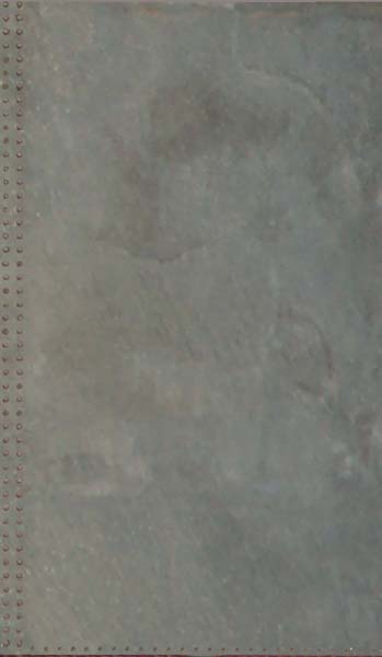

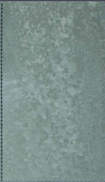

I decided to go with three prototypes after I formulated my design strategy. How do you make a scale galvanized watertank made up of galvanized steel panels and make it look real? Huuummmm! Well, how about making up all of the steel panels individually from photos of the actual panels. Sounds good to me.
However, access problems prevented me from getting enough panels to make the tank. There are two more such tanks in neighboring additions, so go take photos of those panels. The fact of two different vent systems was just iceing on the cake. In addition, the tanks could be photographed under different lighting conditions.
So we start making our tank the old fashion way; One Panel At A Time! You can get an idea how this scheme is going to produce unique panes.
fishBait

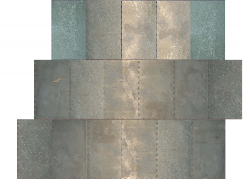

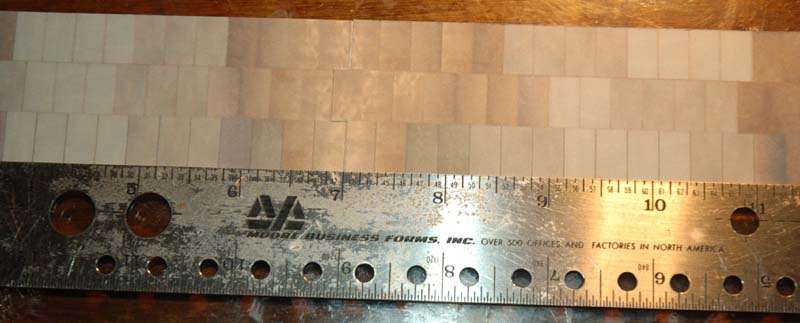

To see how this method is going to work out, I built a small segment of the watertank wall. Notice the top two outer panels. They look out of place because they are so dark. That is because they go on the other side of the tank (the shaded side, remember the lighting changes mentioned in the second post).
I will keep you updated as the design progresses.

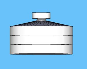

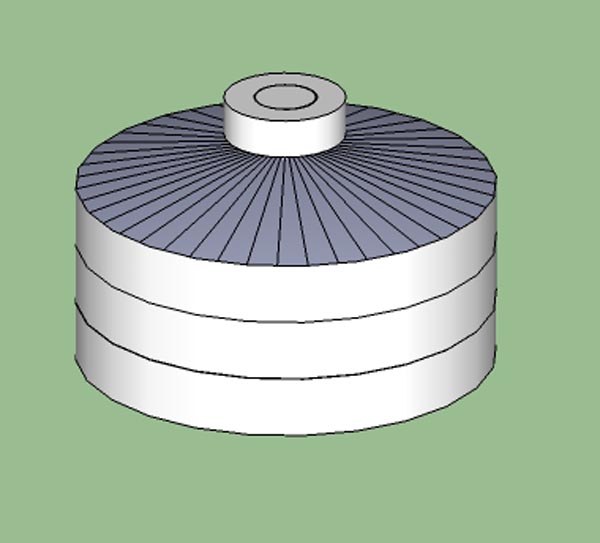

The watertank is progressing nicely. Couple of visits to the MUD (Municipal Utility District) for a conversation with the local manager. Cleared up some details and nailed down some dimensions. The tank under design is a 400,000 gallon bolted iron tank, one of the most popular in this area. If, and only if, I get enough requests, I will extend the project to include one of the smaller tanks.
An extended time of health issues, systems turmoil, and other various items curtailed modeling time. The USS Cairo languished in Beta testing for other reasons and new projects were just not possible.
The USS Cairo is being cleaned up and will be released in a matter of days and the watertank is well underway. From here on out, I will be keeping 2 or more designs in the hopper and active at all times.
Next design start announcement will be sometime before next weekend.
More later,
fishBait

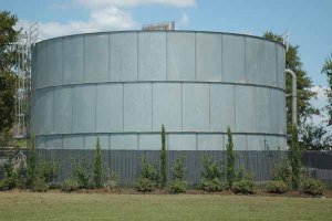

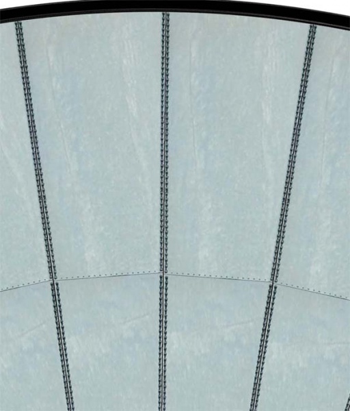

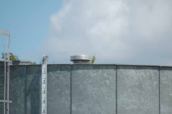

Stop and think a minute. You see less than one half of the tank from any given spot. Even then, the bottom panels are cut off due to fencing and other efforts to hide the plant. If you go in, then you are so close that you see only a few panels at a time, and they are distorted. I drove to five different tank areas and still did not get enough panels for the big tank (428000 gallons!).
So you will see some repeats in the tank, but not very many. Also, the repeats were disguised using different techniques and really do not show up. On the top, I did not climb a tank to try and be realistic there. I cheerfully used only a few modified panels. Check out the detail, yes those are all bolts.
When you build the tank, make sure you place it facing east or west, I built the side wall with the sun glare on one side and going to shade on the back face.
Main parts are designed, start a test build next session.
fishBait

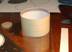

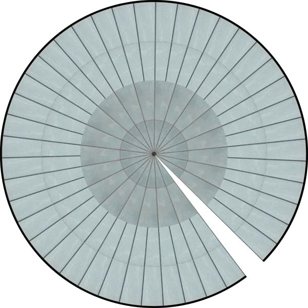

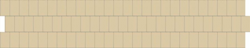

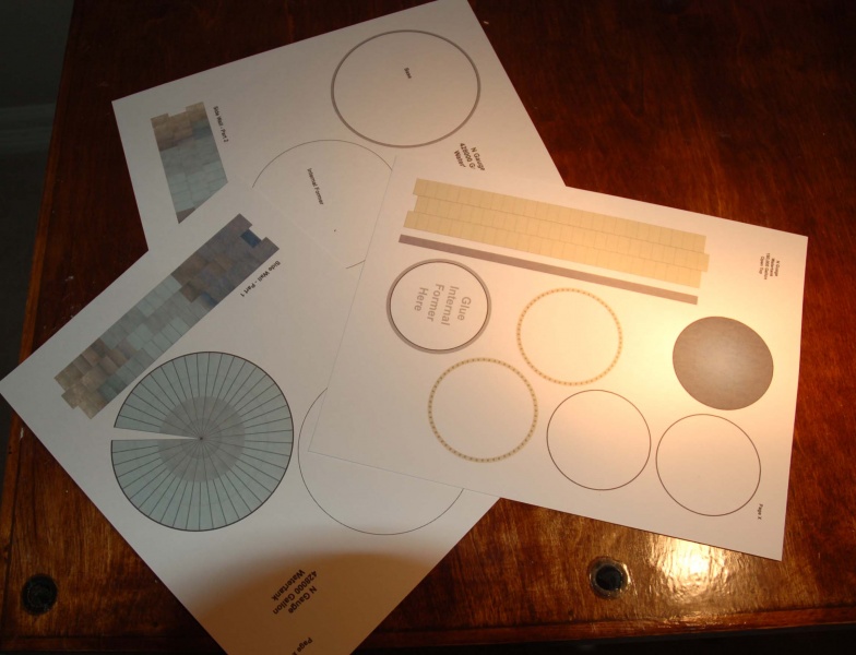

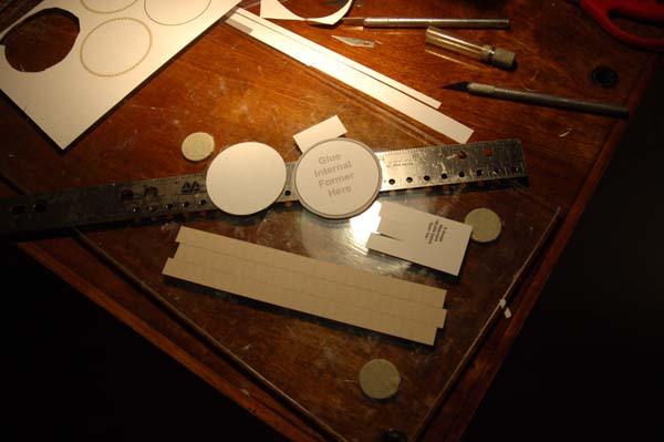

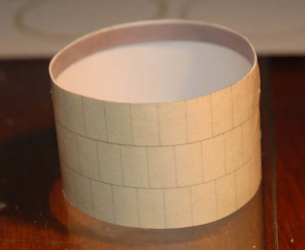

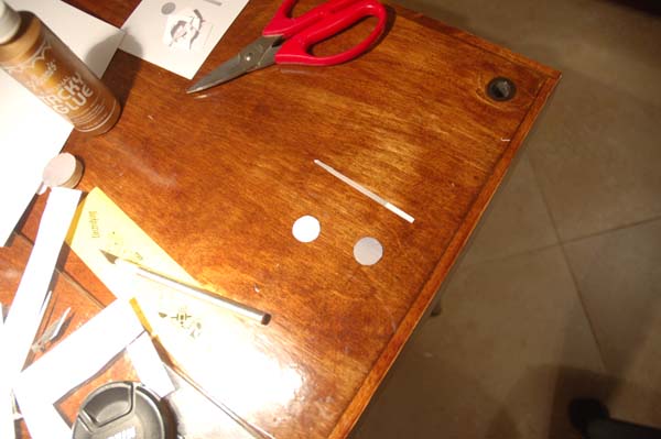

Now for a little papermodeling. Prototype parts pages for HO, N and Z scale are completed. The test build will feature N Scale.
Photo 1 => Prototype part pages for the 428000 gallon tank and the 150000 gallon open top tank.
Photo 2 => Side wall parts removed from parts page.

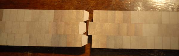

Photo 3 => Side wall strips joined and checked for alignment.
Photo 4 => Side wall completed and internal former inserted. Base glued to sidewall and internal former.
Stay tuned, more coming.
fishBait

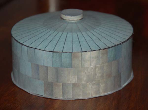

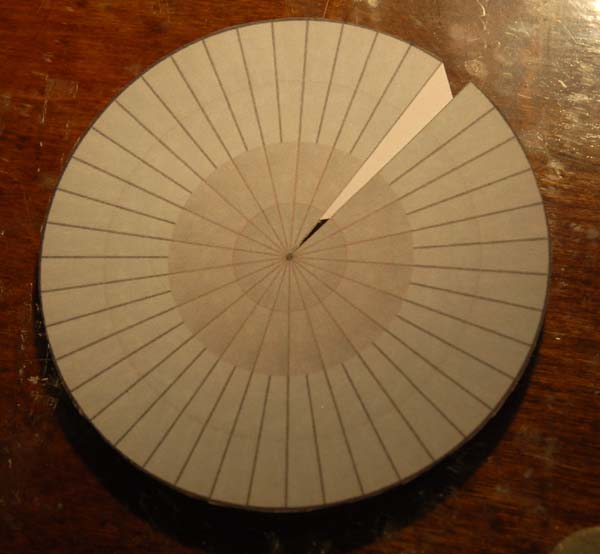

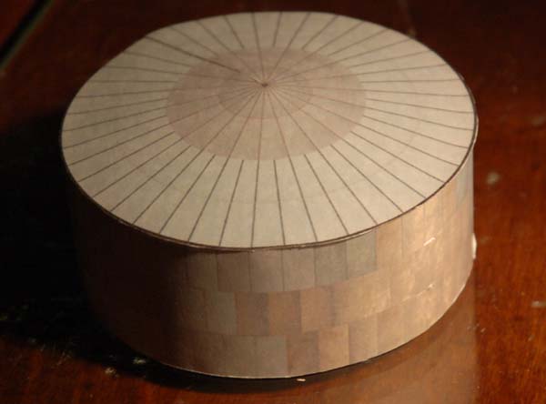

We left off with photo 4 on the last build post. Picking up from there .....

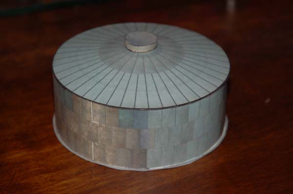

Photo 5 => Insert the remaining internal former from the top and glue. Assemble the top of the tank by sliding the top area of the joint over the tab and glue.
Photo 6 => Glue the top to the top of the side wall.
We now have basic shape of a large 428000 gallon watertank. Next, we will add the top vents.
More later,
fishBait

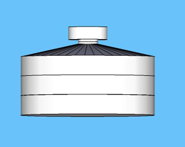

Proceeding to the top vents!
Photo 7 Remove the vent pipe parts and assemble forming the pipe from the vent side and gluing the internal formers in. Remember that the pipe will be installed on top of the tank and will have to set on the peak. Either recess the lower internal former, or cut a hole in the center of the former. Now assemble the vent cap (see graphics for the parts). Form a circle of the vent top side and glue the end. Insert the internal former at the very top of the vent cap. Now glue the top of the vent cap to the internal former and sidewall.
Photo 8 Glue the vent pipe to the tank roof, cener over the peak. Once dry, glue the vent cap to the vent pipe. Set back and admire your tank.
Photo 9 Another look at the completed tank.
More later,
fishBait

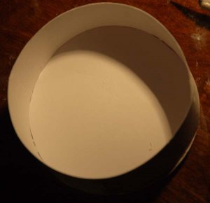

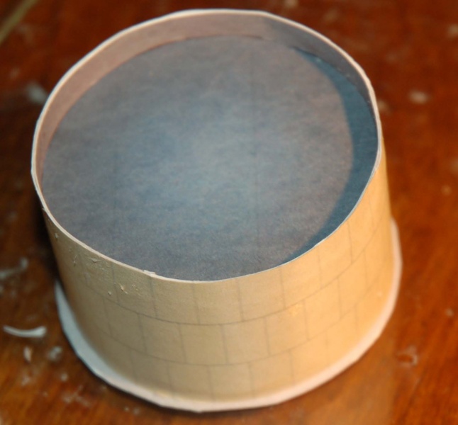

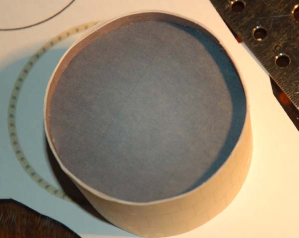

Starting build of the 150000Gallon Open Top Tank.
Photo 1 - Parts pages for the Open Top Tank.
Photo 2 - First parts removed from the parts page.

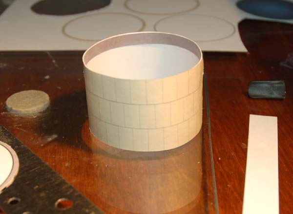

Photo 3 - Form the side wall, curl the sidewall smoothly and glue at the join.
Photo 4 - Glue the water level line strip inside the top of the sidewall. Make sure the strip is even with the top and trim the ends carefully.
More Later,
fishBait

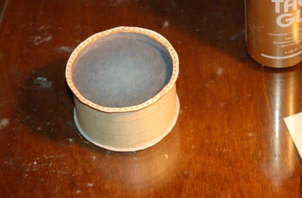

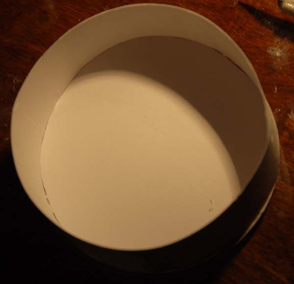

Continuing the build!

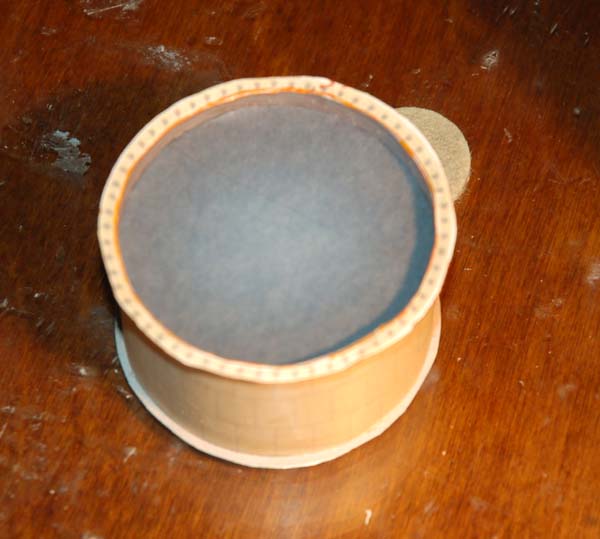

Photo 5 Insert the simulated water internal former from the bottom and seat firmly up against the water level line strip.

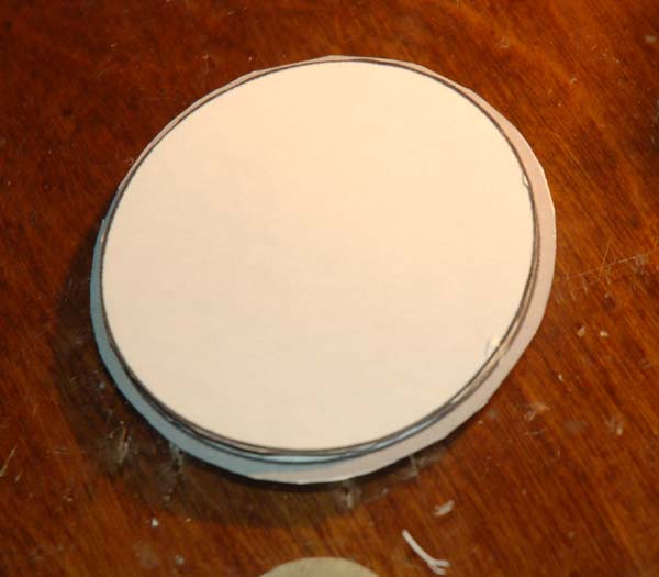

Photo 6 I had originally intended to make a bottom plug with a sandwitch of internal former and base. Not a good idea, but with this picture, envision inserting a bottom internal former and gluing, then gluing the internal former and sidewall to the base.
Photo 7 Base attached as described above.

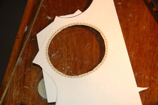

Photo 8 Remove the center from the top rings. Laminate and remove the outer card stock.
fishBait

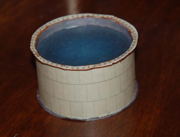

Photo 9 Glue the top rim to the sidewall. Watch alignment of the interior of the rim vs sidewall.
Photo 10 Completed 150000 Gallon Open Top Tank. Notice the water simulation with the shaded insert. Again, I decided to leave the piping up to the individual builders. Every tank I visited had a different piping system.
Photo 11 Another shot of the completed tank showing details and a better feel of the water simulation.
Enjoy,
fishBait
