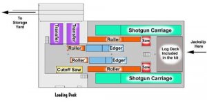

Well I did not have much luck locating plans/instructions for the Muir Sawmill (see the original request), so could anyone please provide some guidance about how these things go together?
I only have a few exterior pictures, and my searching has lead to many more exterior pictures, but I am wondering about the actual floor plan. The kit has some interesting parts, including several saw blades, and metal rods.

Hi Andrew,
Here's a floor plan for you.

Hello again Andrew. I clicked on "original request" in your first post and saw the photo of your mill. That would be a single-sided mill (one carriage, one saw, live rolls, edger, live rolls, probably a cutoff saw, and transfer table) probably all operated off an overhead belt drive and might easily be powered by a steam engine.
