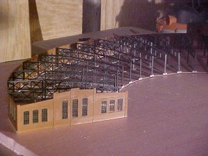

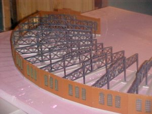

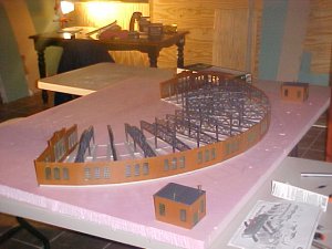

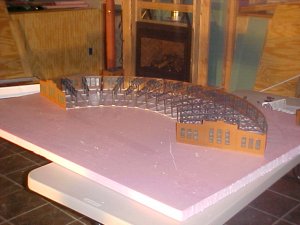

I am working on my first structure a 15 stall roundhouse and would like to know if I should use lights inside. If I use lights what kind would you suggest. I'll have some pictures of my progress tommorrow.
nice, i cant wait to see it. id use the small wheat grain lites somewhere in the middle of the round house. id drken all the walls and celing so they are not translucent. id also inclusesome type of welding flash in there as well... my 2 cents...
I don't think a round house would appear to be lit up like a christmas tree. I would use small grain of wheat or grain of rice bulbs, and I would power them with variable dc and adjust the level of light until it looks good to you.
progress pictures
I will look into the small lights thanks for the tip.

WOW...!!! I expected to see a 5-6 stall roundhouse. You've gone overboard...!!! That's a great job. What is the framing made of? I've got a smaller r'house in my future, so any pointers would help.
And, yes. I would put lighting inside-controlled by a dimmer as was mentioned before. I've got lights in all my structures and makes for very interesting "night" operations.
Keep the pics coming.:thumb:
It is a kit from heljen, I wound up with extra windows because they use the same set no matter what the kit add on or stand alone. This is one stand alone and four add on kits. I plan on using this as the cornerstone of my layout. As I complete each phase I will send pictures.

Do you have any plans to add some outdoor tracks? A combination of lighting the engine house and having outdoor tracks maximizes your ability to not only display your structure, but also your displaying your motive power fleet.
I'd also look into creating some optical illusions by not filling the enginehouse, but placing just enough locomotives at the ride places to make it seem full.
I think lights will make a great addition to that structure, Michael -- in fact, I think the darn thing practically cries out for them! -- but I'd reiterate the importance of what hooknlad's already mentioned about darkening (really painting) the interior walls. That, and make doubly sure you don't have any gaps in wall joints or between walls and roofing. Light seeping out through the cracks (or glowing through the plastic walls) will wreck any hopes for heightened realism! Great job so far, by the way!
-- Paul
The only drawback to darkening the interior walls is that in fact many roundhouses were whitewashed inside to improve lighting. At least the upper walls and ceiling were white (for as long as it lasted); the walls below about 5 feet were often dark to keep appearances neat.
If you do end up with cracks or joints not quite right, you can fill them with putty. If it's a place that cannot be seen from outside, tinfoil is light-proof... :)
Andrew
Good point regarding the whitewashed interiors (although this practice depended upon individual railroads' procedures). In any event, whether one darkens the interior walls or paints them white, the result (and purpose) is the same: to keep the lights from glowing through the "brick" walls and showing them up as plastic.
