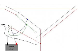

Pretty simple to do. I made up how to do one for a wye. All you need to do is make the whole loop isolated and apply the same principle as i did to my wye.
