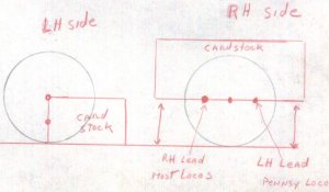

Les,
I thought of a way to quarter the drivers.
Tape pieces of cardstock (with 90 degree corners) to the drivers as shown in the photo. The edges must line up with the centers of the axle and crank pins and the bottom of the card on the left hand driver must sit flat on the work area. Adjust the drivers untill the distance of each side of the card on the right hand driver to the work area are equal. This will give you a perfectly quartered set of drivers.
The crankpin on the right hand driver will be in the 9:00 position for a right hand lead locomotive (the one you want) or the 3:00 position for Pennsy left hand lead locomotives.

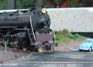

Mine are quartered bounce7 Spent last night running it in with and w/o the boiler shell on to ensure that the pilot trucks cleared the pumps. Once I fabricate a set of steps for the pilot beam, it'll go to paint.

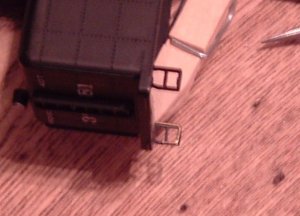

Meanwhile, the tender shell revealed a pleasant surprize---it's rather undesirable weathering job was water soluble and easily removed with some warm soap and water balloon6 On the other hand, one of the corner steps was very weak and ready to break. :rolleyes:
By forming a piece of .020 brass wire into a J shape that extended up nto the body shell, I was able to reinforce as well as straighten it.
