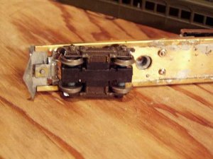

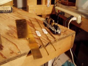

First picture, shows the parts used.
1 flat sheet of brass $ 6.00 Can.
2 1/8th U channel $1.20 Can each.
1 SW 7 bought at a show seconds for $5.00 Can ( not the one shown that was $ 25.00).

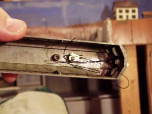

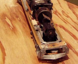

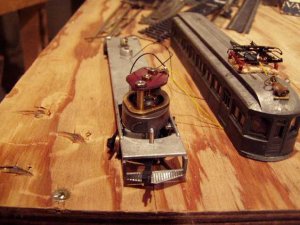

2nd picture shows the motor to be replaced.

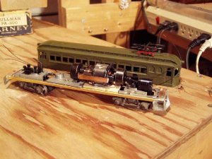

3rd picture show`s it done.
Fast or what :rolleyes:

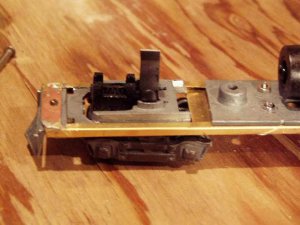

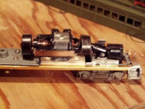

The five pictures show the fittings after a lot of cutting off the original base unit to alow for the new trucks then the old catchers and step even the means to refit it back into the body.
I used clear silcone to bond my motors in place.

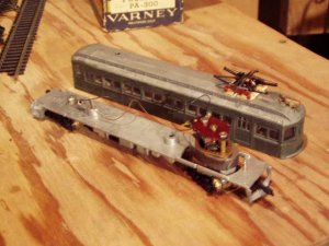

Here is the "new car" resting on the new frame.
The windows have been fitted. Btw the windows will insulate the motor from the frame.
Next I have to wire the motor/lights diods ect.

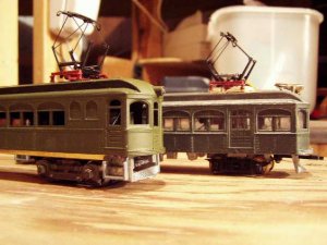

I have test run the bowser and after sorting out a insulation problem the Lady runs a lot better.
I will remotor the second bowser differently same process , this time I will try to mount the motor in original frame cutting of one wheel assembly only , I found the sideway mount rather tight, although it still runs well.
Have fun.. :)
