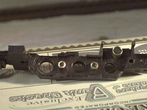

The Diesel gears had to be narrowed and pressed off center on the axles.
Bushings were fabricated and fit into the frame rails.
The bushings on one side were soldered to the frame rail. (note the addition of extra pickup wipers soldered to the frame rails also)
The bushings on the other frame rail are plastic with brass sleeves to allow the frame rails to be electrically isolated from each other.

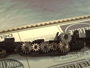

The 11 tooth idler gears between the drivers were replaced with some modified gears from an old alarm clock and the original Bachmann cluster gear was fit with a brass sleeve. Brass sleeves were also fit over the original posts.

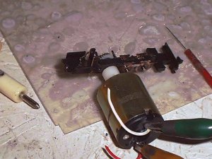

I put some lapping compound on the gears and ran them in by attaching a motor to an axle and running it in both directions.
The assembly was disassembled, cleaned, reassembled, lubed and run some more.

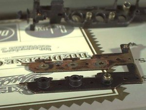

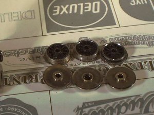

The wheels were chucked in the lathe and drilled.
Three of the wheels were drilled oversize for insulated bushings to be installed. (the plastic centers of the wheels were not drilled oversize)

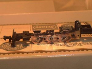

I made the bushings for the insulated drivers and installed the wheels.
I tried something different when I quartered the drivers and it worked great the first time.
I installed the rear driver on the left side first with it's crank at the 6 O'clock position.
Then installed the left center driver at it's 6 O'clock position. The center driver positions aren't critical as the siderods aren't attached to them.
Moving to the front axle I found the center of the backlash in the gear train by holding the rear driver in it's 6 O'clock position and taking up the backlash in one direction and noting the position, then rotating the front axle in the other direction and noting the amount of rotation of the front axle.
I then rotated the front axle back half that amount putting the front axle at the center of the backlash and installed the left front driver an it's 6 O'clock position .
Then to the right side.
Keeping the left rear driver at it's 6 O'clock position , install the right rear driver with the crank at it's 3 O'clock position .
Install the right center driver with it's crank at the 3 O'clock position.
Holding the left front driver at it's 6 O'clock position, install the right front driver at it's 3 O'clock position.
Install the siderods and valve gear and test run.

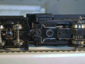

I changed the tender pickups because I wasn't happy with Bachmann's design. there were to many contact points where the current flow could be interrupted and the wheel wipers caused so much drag they locked the wheels and wore flat spots on them.

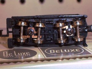

I changed the wheelsets on the front truck and installed a set of wipers from the diesel trucks. They fit right on with no modification other than soldering the wires to them.
The wires run from the wipers to the drawbar. The wire from the rear truck runs through a hole in the floor through the tender and back through the floor at the drawbar.
Then another pair of wires run from the drawbar to the loco frame sides.
