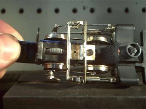

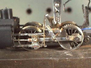

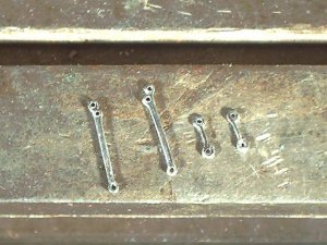

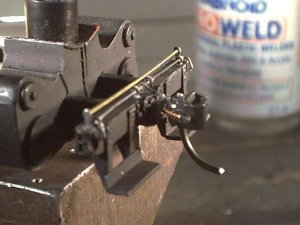

I made a little progress on the Rivarrossi 0-4-0.
The cross heads and main rods are modified L/L parts.
the rest of the parts are scratch-built.
The parts in the second photo are formed from steel wire around jigs and soldered.

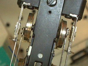

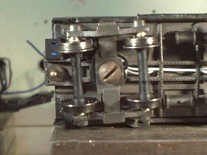

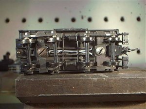

A low friction pick-up system was built for the tender.
It uses Atlas wheels that transfer the power through brass journals fit into the stock journals and tied together with apiece of solid strand copper wire.
Jumper wires are run from them to a small plug on the front of the tender

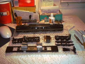

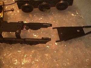

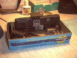

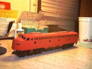

Here's a project that I am doing for my brother. He found this on Ebay for around $20 we had no idea what make it was until it arrived. We thought it was an IHC and were buying it to part out for the panagraphs. It turned out to be made of brass by Lambert.
One of the trucks needs soldered, a tune up and a little touch up.
It will most likely be resold.

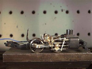

I have the valve gear completed on the Rivarossi 0-4-0.
I just need to mount a coupler and some details on the pilot, wire it up and paint it.

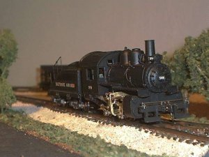

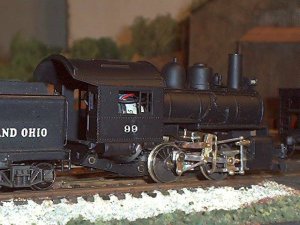

I made a draw-bar, put the boiler on and have been test running the 0-4-0.
There's a slight bit of gear noise I want to work out and add a cab floor.
I may also add a constant intensity headlight.
