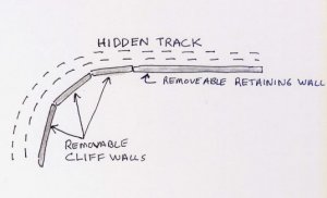

Time for me to get onboard with this! Since I don't have a digital camera and have to shoot up a roll to get pics to scan I'll introduce my project with a couple of sketches. My least finished part of my layout is on a curve that has tracks on two levels.
Here's an old pic of the upper level: http://www.the-gauge.com/attachment.php?attachmentid=19964&stc=1
There is hidden track immediately below the track pictured in the photo. I can access it by removing rock wall cliffs made of styrofoam covered with joint compound and a long brick retaining wall made of styrofoam (originally manufactured for christmas railroad scenes but nicely done for my purposes.)
The project for me now is to scenic in front of the removeable walls in a way that hides the joints between them without getting in the way when I need to remove them.

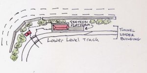

Here's a sketch of the plan...

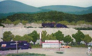

The other structure in the sketch above is a diner that is already in place and pictured in this old photo:
http://www.the-gauge.com/attachment.php?attachmentid=20188&stc=1
I've removed the spur (which I really didn't use much) running behind the diner, freeing up more space for scenary. Those are a couple of the styro cliff walls hiding track in the background. You can see that the area looks a bit barren for a Northeastern RR scene. Time to green it up!

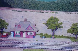

I did plant those trees and the area is much more Eastern looking. I've also made a station platform but need to add details like benches, passengers, and maybe some street lights to illuminate the platform for night riders.

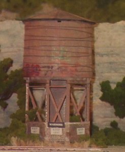

I've weathered my cheapie plastic water tower and grew some shrubbery all around it that actually climbs the structure. While there are eventual plans to demolish the tower the railroad has installed a chain link fence around the base of the water tower to keep people from vandalizng the outdated structutre and hurting themselves.

Another thing I wanted to do for the layout party was to weather a water tower that supposedly would be soon scheduled for demolition. I had a location in mind for it but then decided to place it where Dave's diner is in the previous photo. Dave's is now across the tracks from the local RR station.
