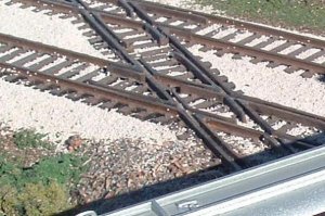

I use Wal-Mart craft paint straight from the bottle in Nutmeg Brown, slopped on then cleaned off the rail tops when dry.
Ooooo, gotta pick that ballast off the rails :oops:
