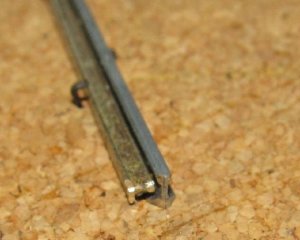

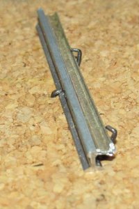

I have finally had enough time to mock up a section of rail the way the old school traction modelers of my youth did it.
Shown, on my cork and homasote build board is a section of code 100 rail spiked directly to the subroadbed surface, the old guys used homasote, the homabed switch blocks would make great under road surface. be sure to seal the homasote with acrylic paint, as otherwise it will suck up and hold moisture, causing dimensional stability issues, and I have had spikes in unsealed homasote rust away after 10 years.
first you spike down the code 100 rail as you would doing conventional railway track. then code 75 rail is laid in sideways, where the space between the web and the head makes a flangeway. the web does not come up quite as high as the rail head. The best running trolley layout I saw was made with the roadway flush with the web of the code 70, and the rail head for the code 100 slightly elevated above the road surface. the flangeway is oversize, but so is the code l00 rail, and that doesn't show much when buried tin the road.
here are photos of my mock up. any questions?

The trolley modelers of my youth we some of the highest skill modelers I had ever seen at that time (Cincinnati in the 1960's). they had portable and modular layouts and dominated the local train shows. They left me with a little bit of an intch, that I have nor scratched yet.
