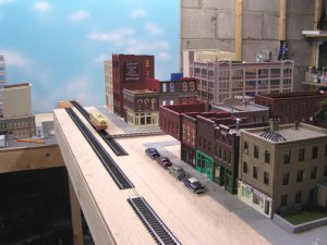

Those of you who have seen my new trackplan will know that I added a peninsula for a city/trolley module, which will be 10 ft x 3 ft, accessible from both sides. I started the benchwork last weekend, and began laying track last night.
Most people try to fit as much track as they can into a given area - I try to fit as many buildings!! :eek: :rolleyes:
So, this first shot shows how I am making sure that my plan for the buildings, fits in reality.
Val

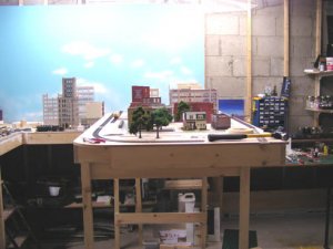

This is section 1 of 2. I just finished laying the track. I have tested it -- with a 40 ft. boxcar since I don't have any locos that will handle a 9" radius! :eek:
The next step is to raise the surrounding area to track level and start paving. I am going to work on this section first and then start the next one.

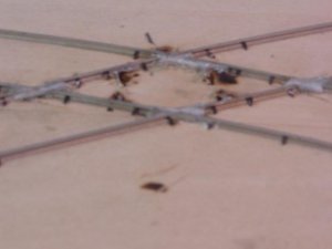

Hey Val, don't limit yourself to available crossings, lay your own. It will give you a great look which you'll compliment so nicely with your scenic work. Don't know about the problems with trolley poles, have to leave that to others! Process is easy when the track will be in pavement. I lay one route, then bring second up to first, continue on other side, then cut two pieces to fit between. Spike then use cutoff disc in Dremel to open gaps as required for wheel flanges. I used some 5 minute exopy like stuff to build up the frogs. Not a good shot and nothing painted yet, but you can see where I soldered leads to the rails in the diamond from the burn marks. My plan for adding street is to use .040 styrene cut to fit between the rails with .020 on top of it cut more closely to the rails. Be a bit of fitting involved, but no big deal. Rail is code 70 so that should work. When in pavement ought to look good.
Gary

That's cool Gary! I never thought of spiking directly to plywood like that with no ties. Wish I had, because it's the ties that are causing all the trouble. Anyway, sorry but the crossover is toast. I already laid the track without it.

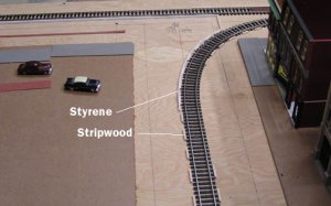

Here's a progress shot from tonight. I'm putting wood supports for the brick that lines the track right beside the ties, and outside of that is the styrene which will set the level for the pavement.
Val
