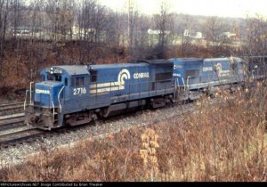

Green was referring to engines with extra cab windows, like this:

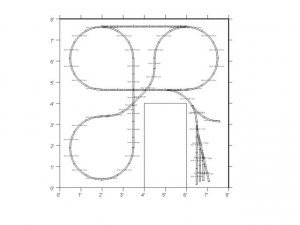

That is a very rough sketch of an idea that popped into my head, while I was messin around downstairs. May not fit so well, if at all, but I do like the rough idea of it

That plan is a very rough stetch, LOL, but I like the rough idea of it too. I use photoshop for my rough sketches.
Following Wiperman's rough sketch, I laid it out using Atlas 18"-radius sectional track using XTrkcad below (I think I remember him mentioning that he essentially has two 4x8s side to side):
I don't think he has room for a 4-feet-long bridge in that diagonal section (the bridge there is only 1 foot long!), but otherwise it's feasible.
Xtrkcad isn't the easiest to learn how to use, but it's a useful planning tool I think.. It's still a free download, no?
