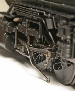

I picked up my new Bachmann Spectrum 4-8-2 "Mountain" this past Saturday:thumb: and gave it a trial run on the Club layout this evening. It did fine initially untill I opened it up to about 3/4 throttle (perhaps about 45-50 scale mph) and a rivet popped in a part of its drive linkage.wall1 Two arms were bent as a result. :cry:
I took several close up photos to e-mail to Bachmann as well as my LHS 50 miles away to illustrate the failure and damage. I'm awaiting a reply from each to get an e-mail address that accepts photos.
How often does this sort of thing happen with HO steam engines? Both the long arm and the shorter arm it attaches two were bent by whatever malfunction caused the separation.

Looks like the valve gear bound up or was out of alignment and struck it's mount. Possibly improper installation, possibly a small bur. It could be almost anything.
Bachmann will probably tell you to send it to them, and in return you'll get a new loco. Pretty much their standard procedure. Rarelly do people get the same loco back.
Bones is correct: if you send it back to Bachmann, they will most likely send you a new replacement. It looks to me as if the problem was caused by the valve gear connecting rod (the short piece connected to the top of the long bent piece (the eccentric rod) striking the upper crosshead guide, or, more likely, the crosshead itself. (the crosshead is the part that slides back and forth, right behind the cylinders) When I first ran my Bachmann Mountain, I could hear a clicking noise as it ran, and discovered this same problem, which was easy to correct by bending the lower end of the connecting rod out (away from the crosshead) slightly. Unfortunately, I broke one of the connecting rods, and had to fabricate a new one from brass. Most common problems like this can be fixed by the modeller using simple hand tools and small rivets can be purchased, or you can make your own.

The hole for this particular "mini-rivet" is smaller that the diameter of a straight pin. Plus the smaller linkage is also bent - didn't want to take the chance of breaking it off when trying to bend it back. I'm going to let Bachmann do whatever they do. They did request that I return it to them in original condition, e.g. remove the weights I installed in the tender.
